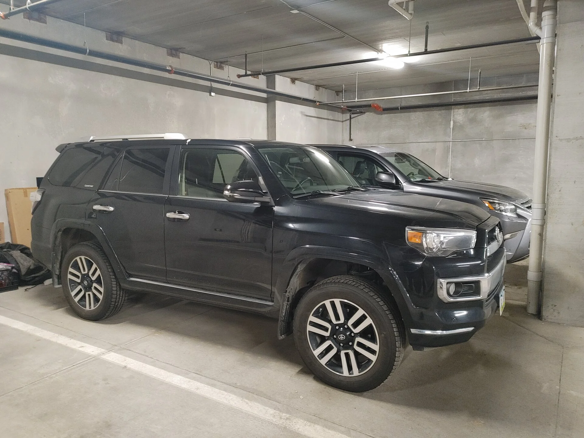

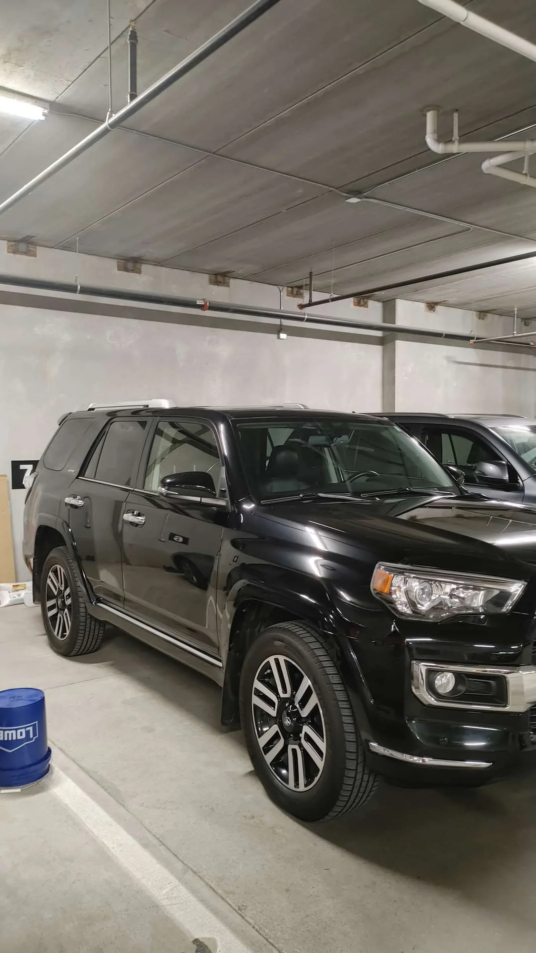

Starting a build thread for my partners 2016 Limited.
It will complement my 2015 GX.
The T4R already has Bilstein 5100s to replace the Xreas which really transformed it. It's an absolute blast to drive now. The shop
Put the front up 2.5" even though we didn't ask them to, and have just left it. Not sure how much lift they will want once it has a steel bumper.
I put an Odyssey 24F with a Voltage Booster from Voltage Booster Pro in just over the weekend.
I have a set of seat jackers and ARB skids that still need to be installed.

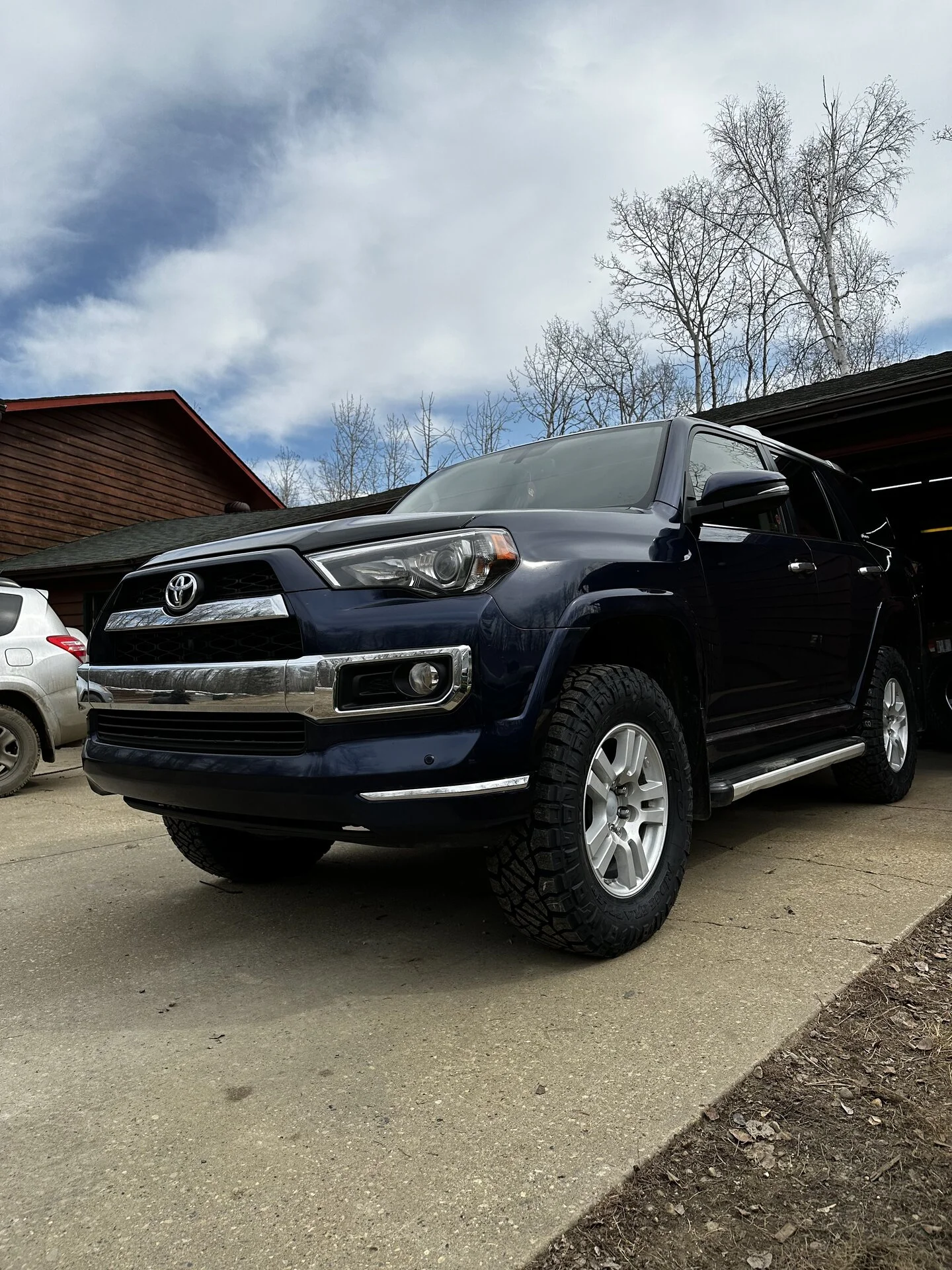

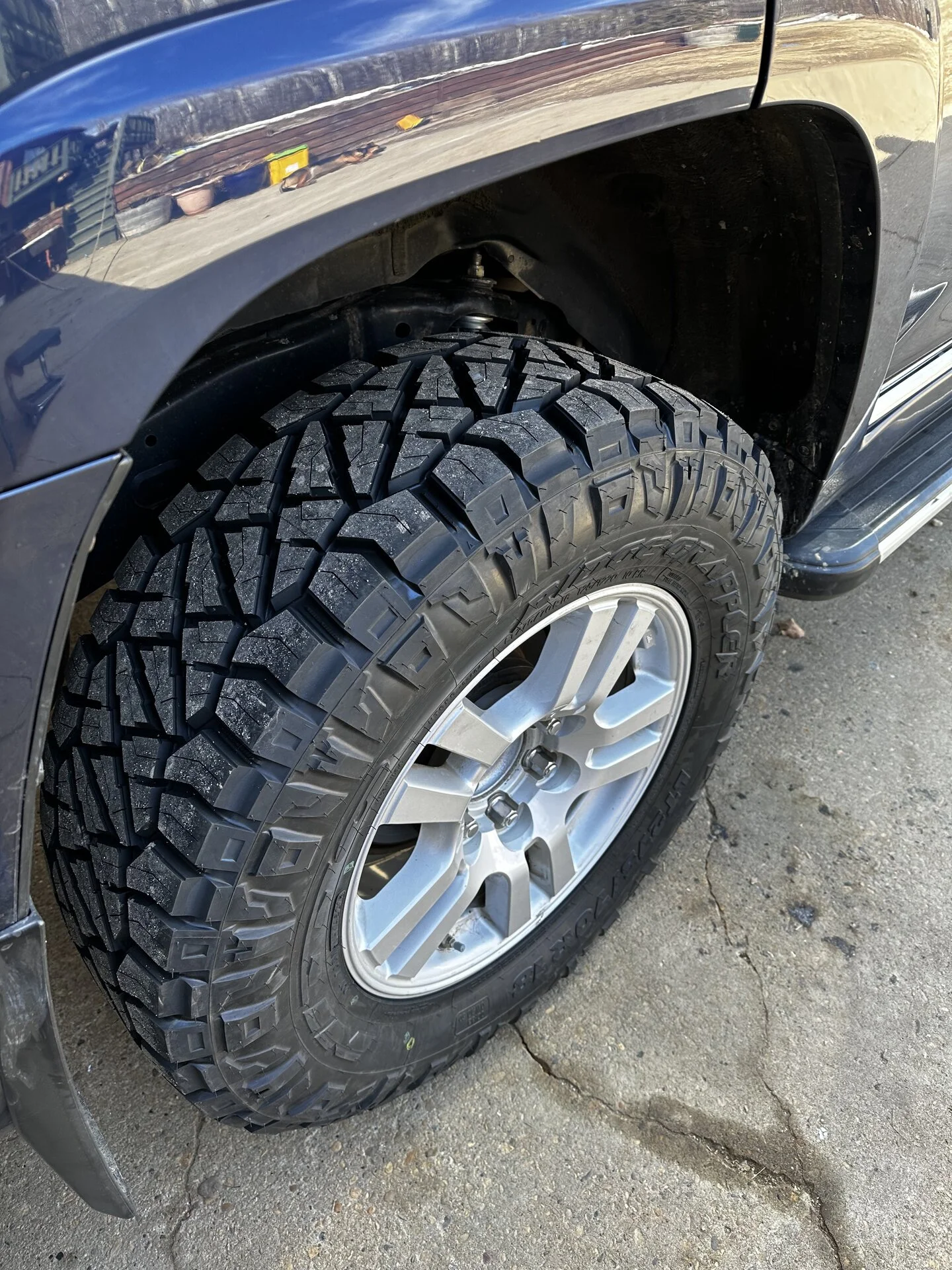

I’m also doing up a 2016 limited, so far I have a 3” Ironman stage 2 , 275/70/18 ridge grapplers on Tacoma limited wheels (covers removed) , extended rear swaybar links and Icon rear uppers, lowers and pan hard bar. Ordering up a weld in pan hard correction kit next . Keep up on your additions!
Did you have to do anything special to get those to fit? I have 33x10.5s on my GX and have been eyeballing 265/70 and 275/70R18s for my winter tires.
Nice! Hope you clear when flexing. I know I just clear in my GX with factory steelies, and no lift.
