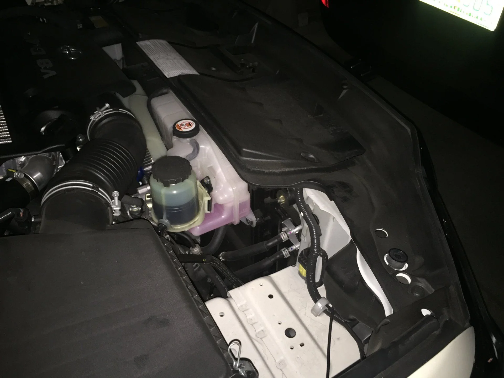

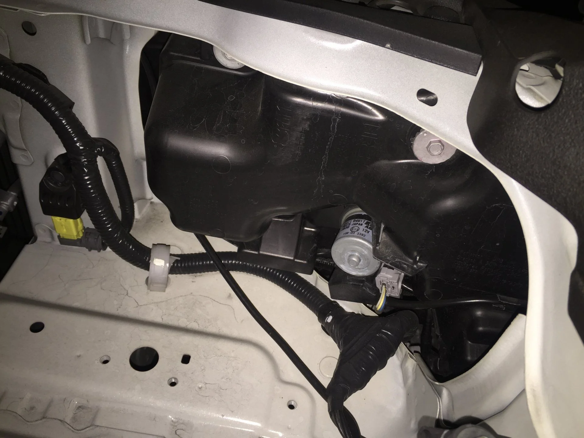

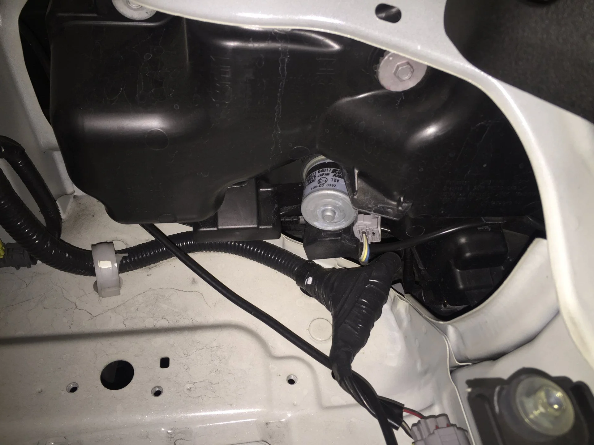

here are the pictures......

I took a peek today and found that the plug on the 2016+ is underneath the headlight and not accessible from the top unlike the 2008-2015 models.
If someone has removed their headlight unit and has an up-close picture of the bottom connector showing the wire colors, that may help.

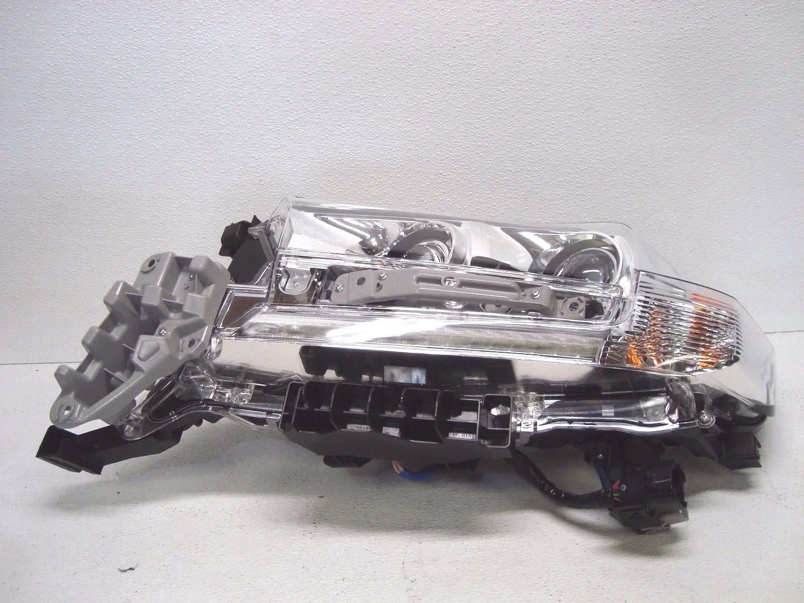

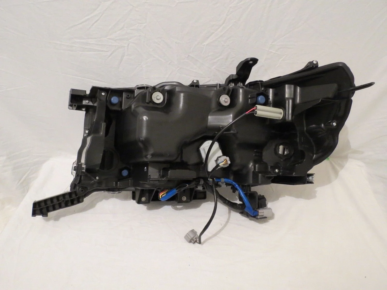

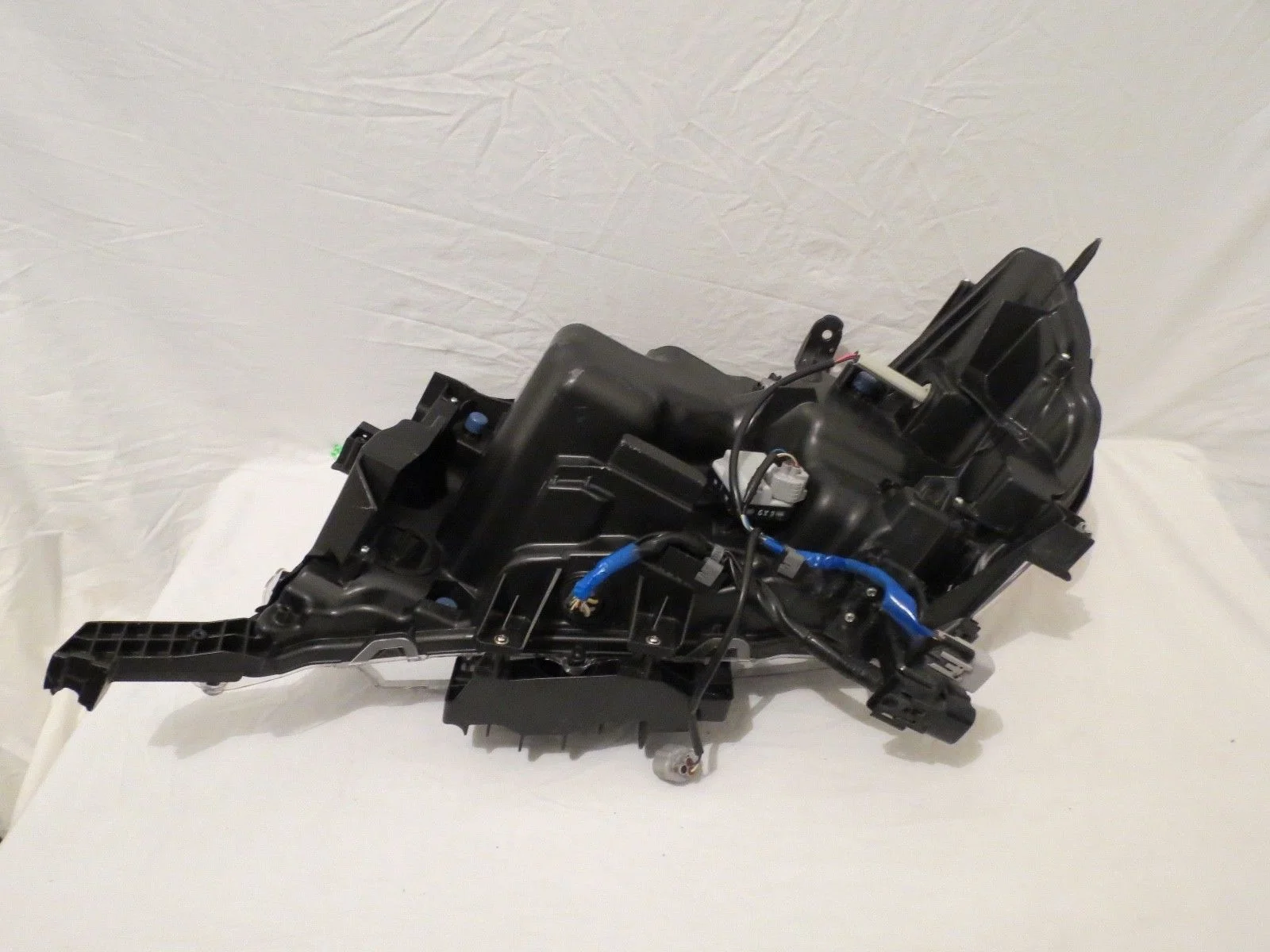

I have an extra headlight in my attic. I'll get it out later and take pics.
Please take close ups of the connectors and note which wires go where
You've seen the below pic, needs no clarification, just including here for reference
The "top" in this pic has the actual connector holding it in place with the rest of the headlight. I will use that as the "top" going forward because it was hard to spin it around, hold a light, and take a picture with just two hands.
The "top" is the right side in this pic.
You can see the connector siding on the "top" so that should help with orientation. The cord between the pink/orange and the yellow here was a darker grey color and the one on the bottom next to the yellow looked like a pure white.
