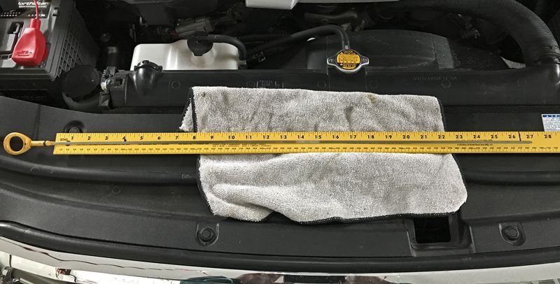

It was mentioned on other threads about the oil levels, that the stick might be misplaced by PO or dealership installed wrong one (shorter). I will measure mine when I get home tonight. Can some one with 2016 or earlier model measure his?
Here's the dipstick on my 2013 LC200:
26 1/2" to the LOW mark.
HTH
It is well documented and completely normal for the 5.7 to require ~8qts to get within the two marks on the dipstick. I always put in slightly more than 8 and check it regularly.
HTH
I had measured stick last night, 26.5 from the low point. Also drained some oil to be just between 2 points and just going to leave at that. Not overserviced and not under serviced, left some space for expansion.
