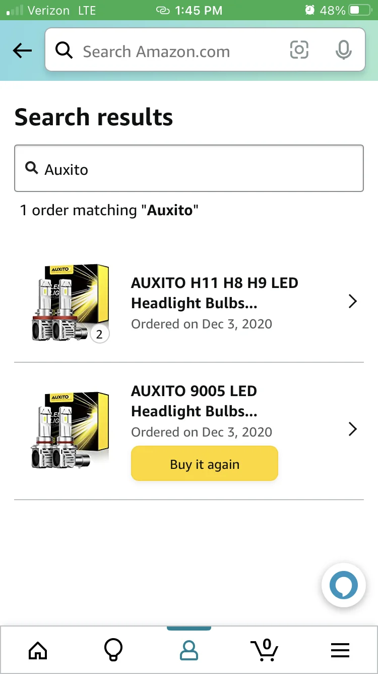

I replaced both low and high beams with Auxitos and they, especially the high beams, are super bright and are crisp even light. The bonus is they also have integrated heat sinks and fans so no extra wires which means it'll fit behind any rubber dust covers.
The country road / backroad & wilderness performance of the high beams are excellent.
Hunt for these if you're interested.
