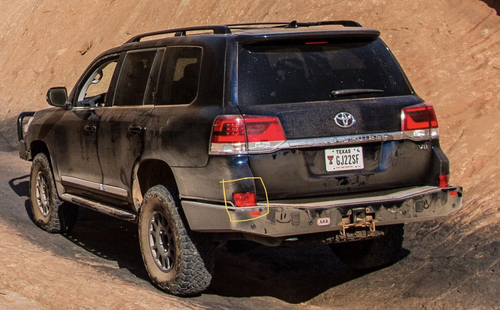

We have fit an ARB rear bumper to a 2016+ model without too much fuss. Have to be careful of the contour where the rear marker light is, and do a little bit of notching of the bumper itself also.
@duggy did my install. He had to slightly notch the bumper at the marker light as it is a different shape than the pre-2016. See the yellow box.
There is definitely cutting involved, and Slee installed mine so can't help you with you how easy it is. I just installed the lights and remember it being pretty easy.
