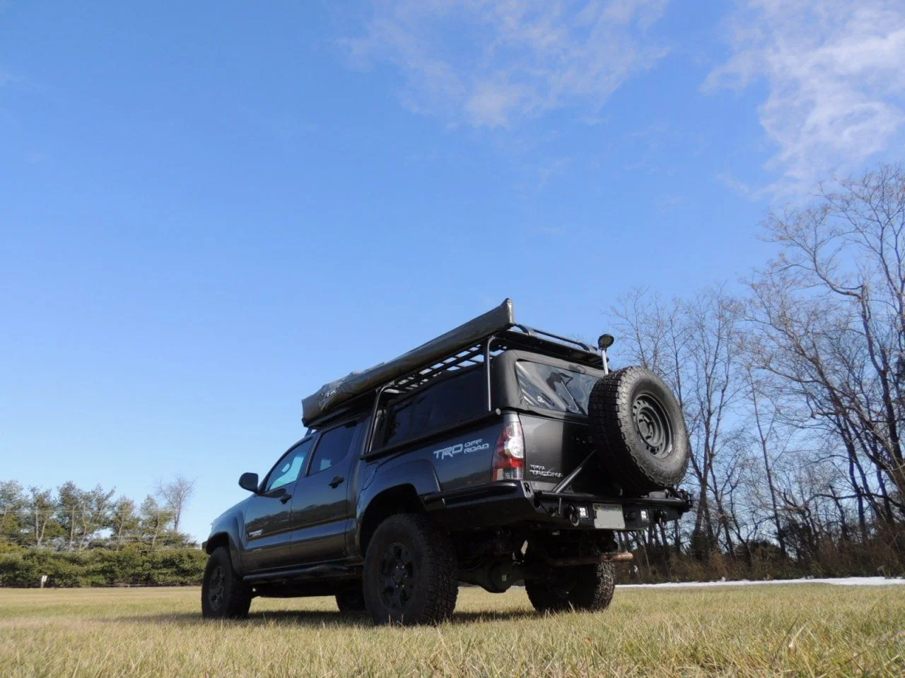

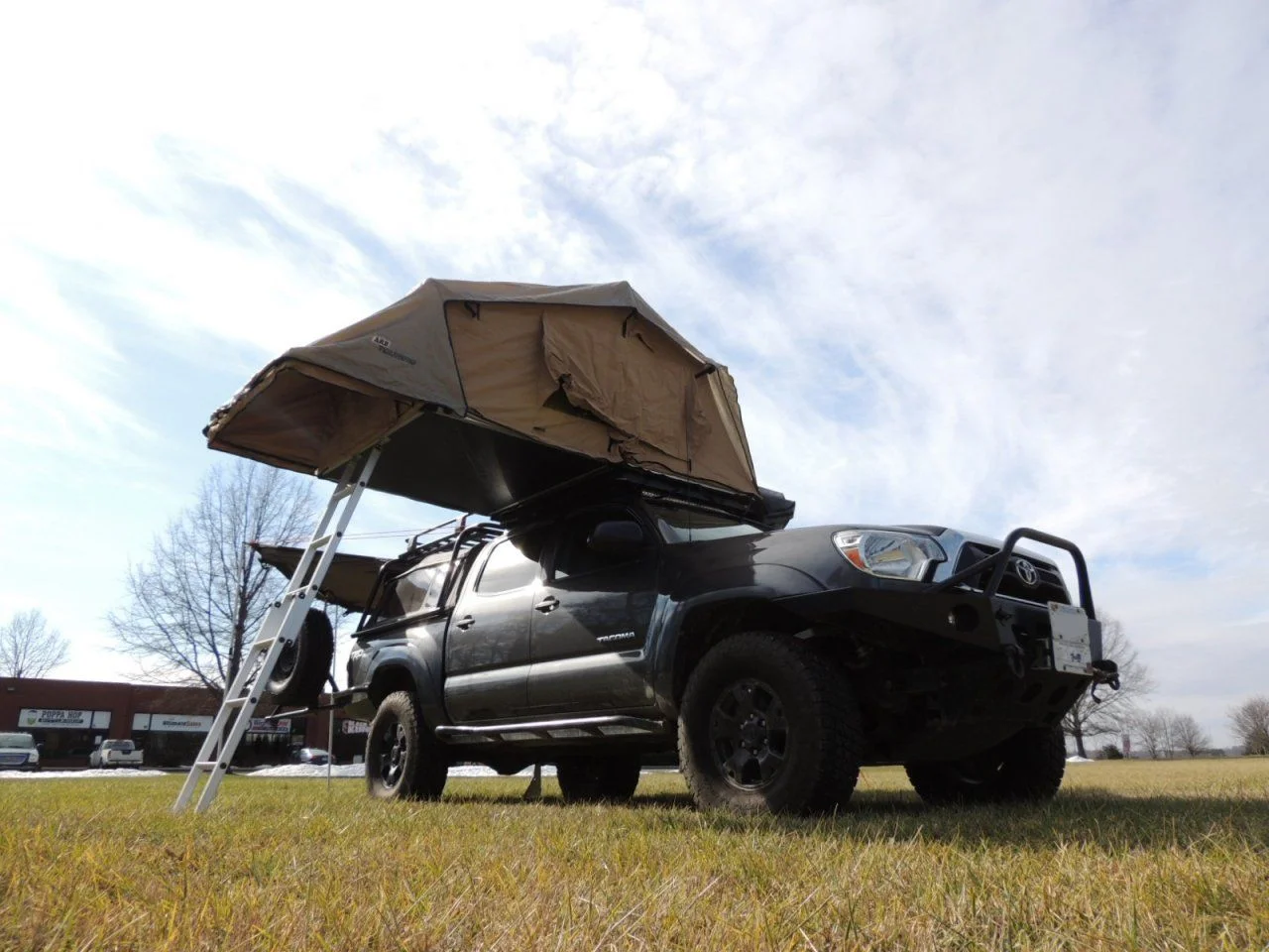

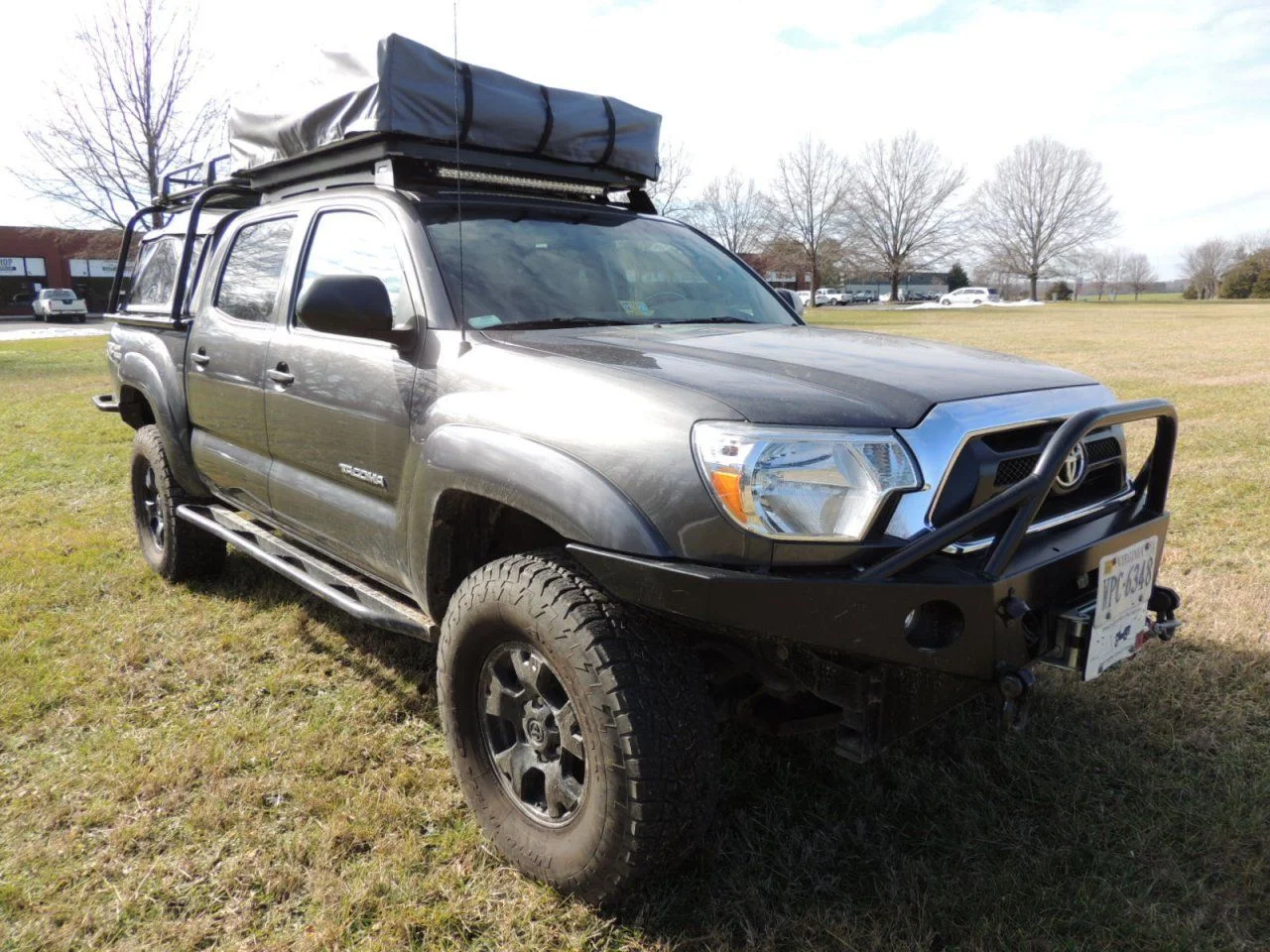

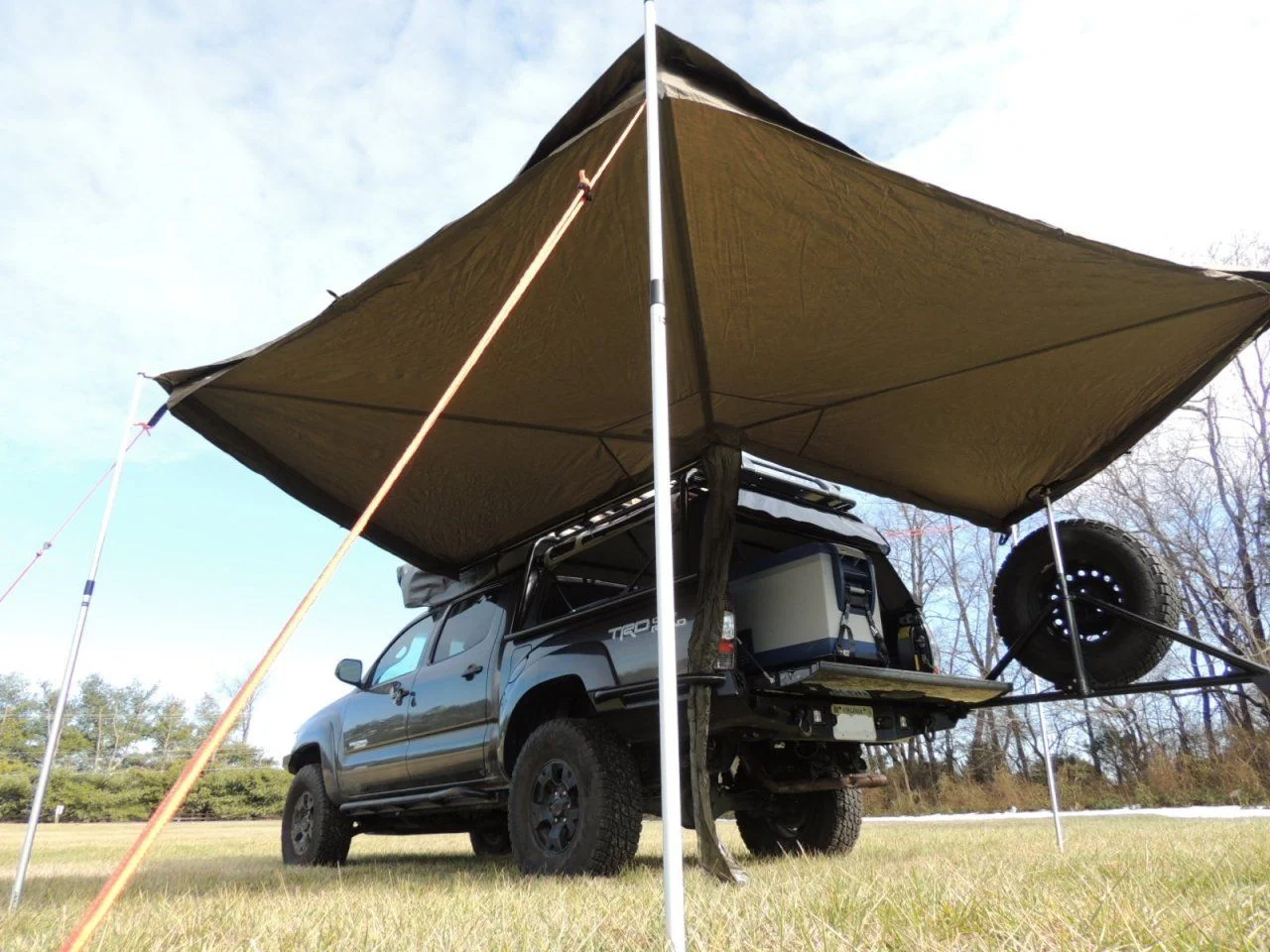

I'm a big fan of the Front Runner racks(if you have a 4dr taco). We recently did a Front Runner rack and ARB tent(among other things) on a Taco.
Here's a shot prior to a lot of the other work we did.
Here are some shots of the completed truck.

Thanks! I wouldn't want to pack it up every morning during a multi-day wheeling event, but it makes one heck of a basecamp.

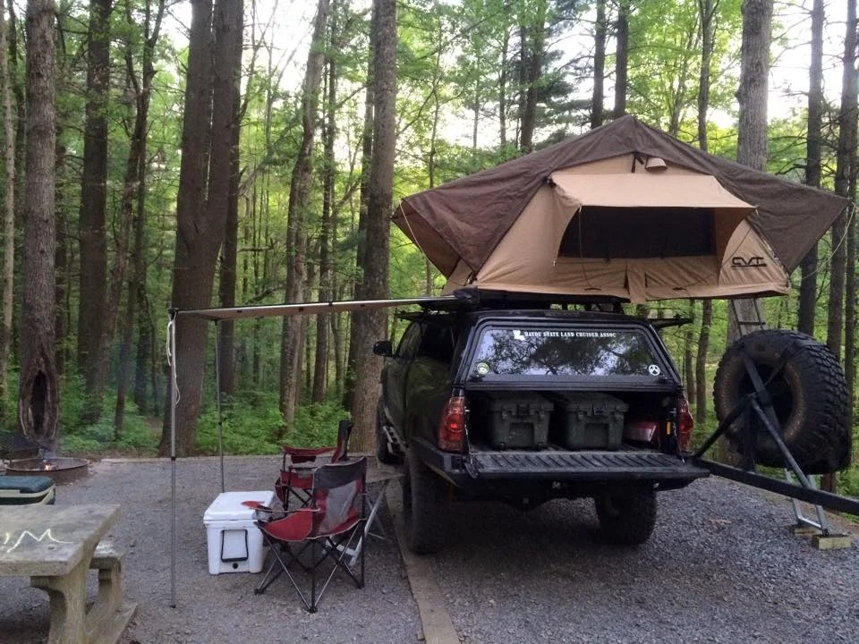

I have an ARB RRT Mounted over my soft top. I tig welded some aluminum supports underneath the soft topper. I also didn't really want a rack on my truck. I originally bought one but decided against it seemed too clunky for the somewhat sleek looking truck.

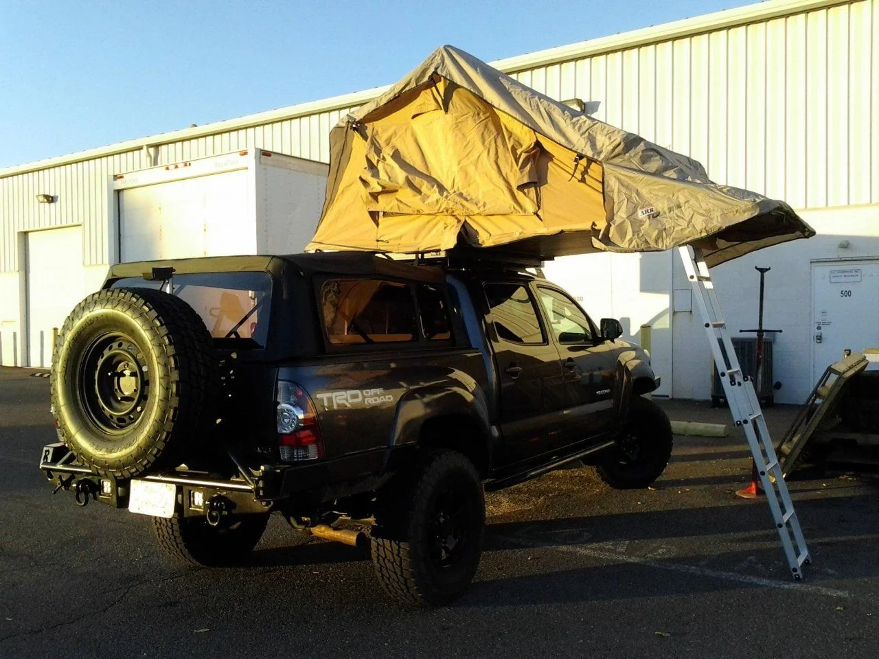

(Reviving this old thread) Did you ever find a solution for mounting your tent? I bought two bars from allpro off road through puretacoma.com. They mounted to my factory rails and the tent sits about level with my cab.

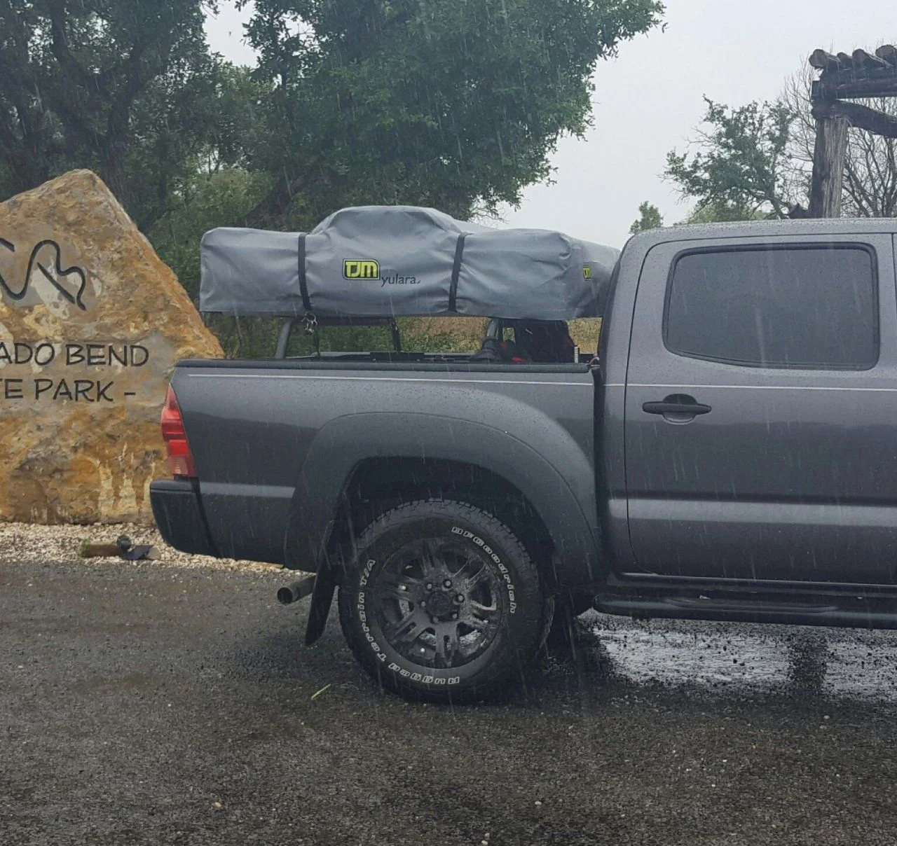

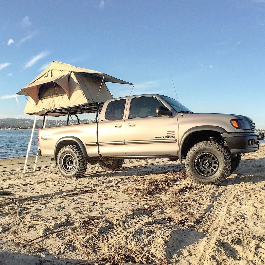

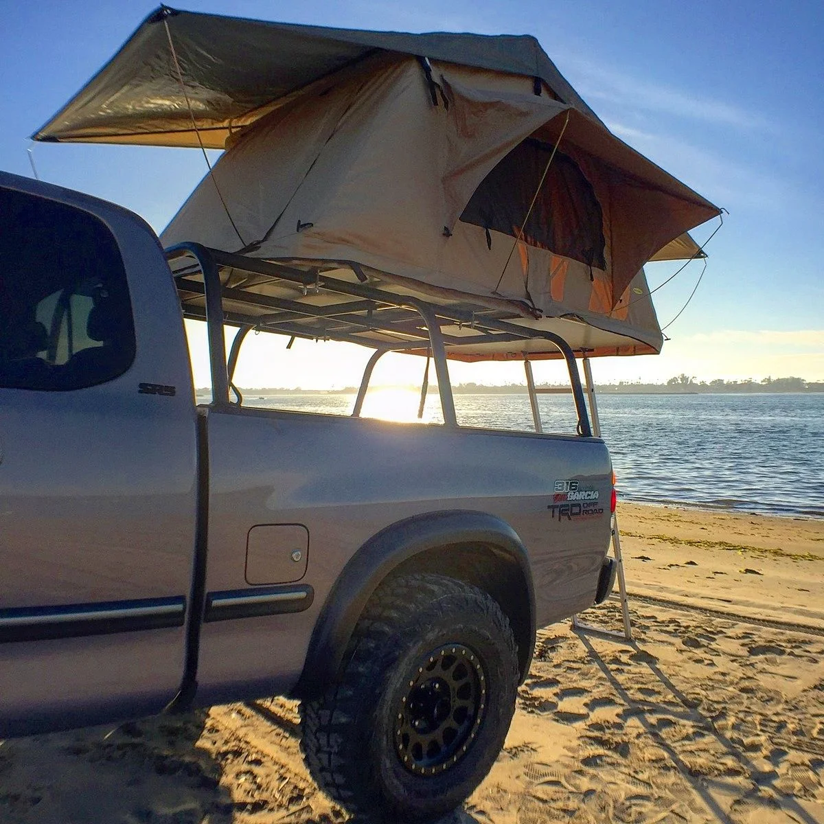

Another photo, just in case anyone is looking for another idea.
The bedrack is from TMT in Venezuela.
Bedracks keep everything at a good height in my opinion, so the MPG loss I think would only be from extra weight, not from wind resistance.

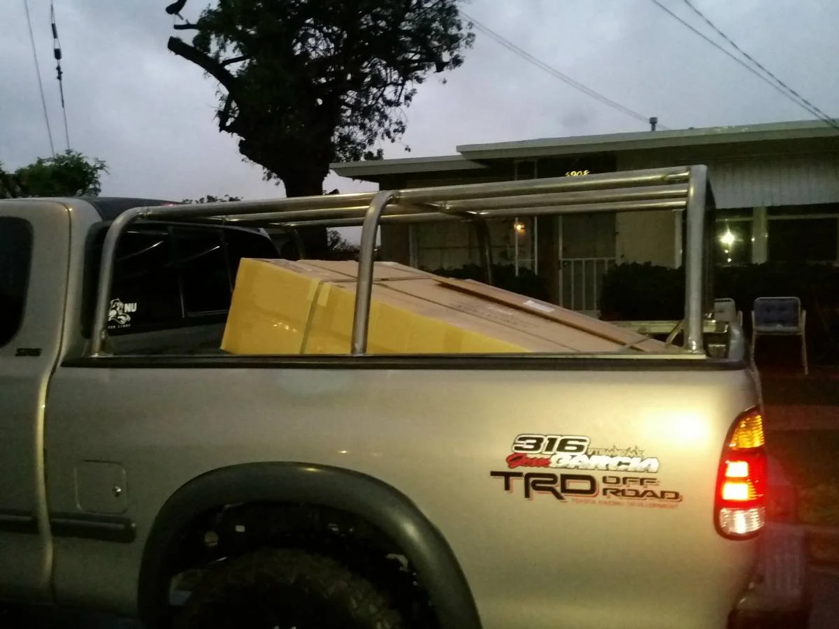

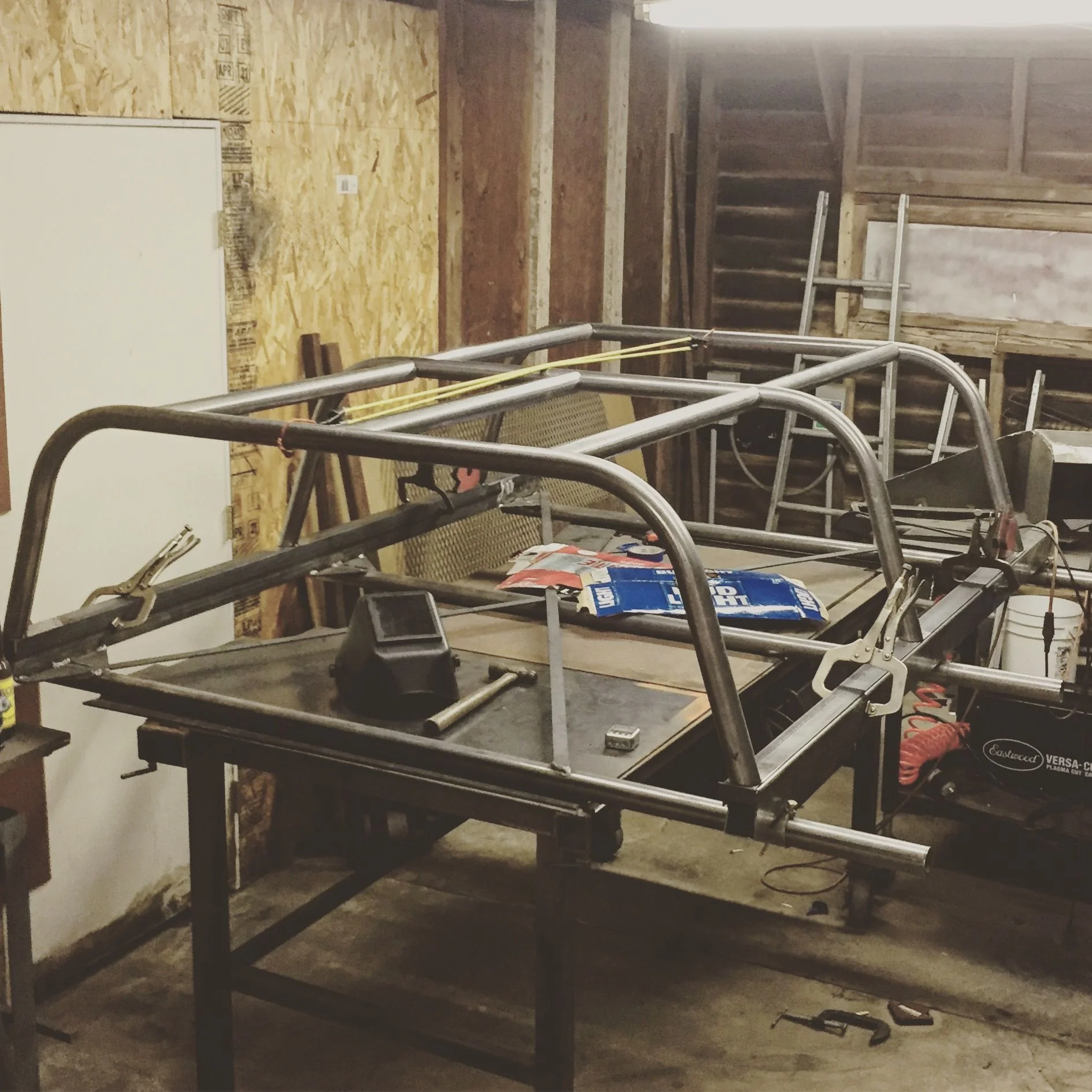

This style bed rack offers excellent ability to mount accessories, access the bed and cary a RTT or cargo rack. Photos are of one I made for a Gen 1 Tundra. Currently building one for a 2017 Tacoma, using 1.75 diameter tube, 1/8 wall steel. Angle iron sits on top of bed rails and the hardware grabs bed rail mounting system. I have a welding shop but its not too tough of a DIY project for a home welder.
