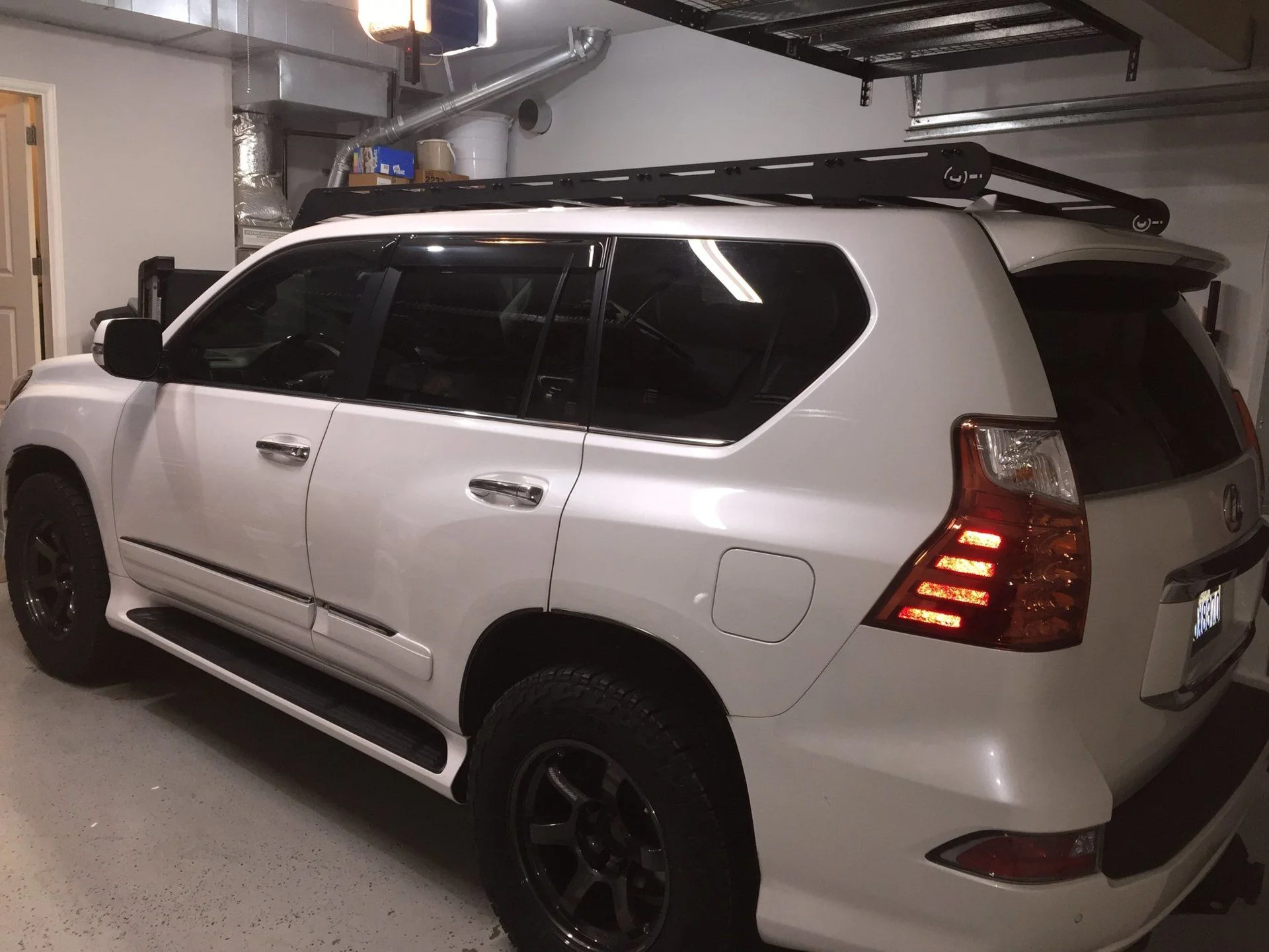

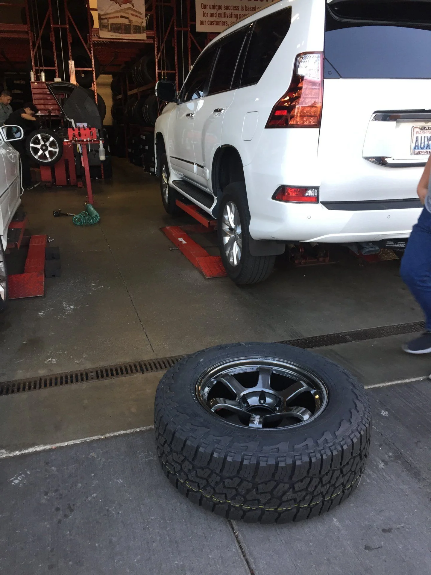

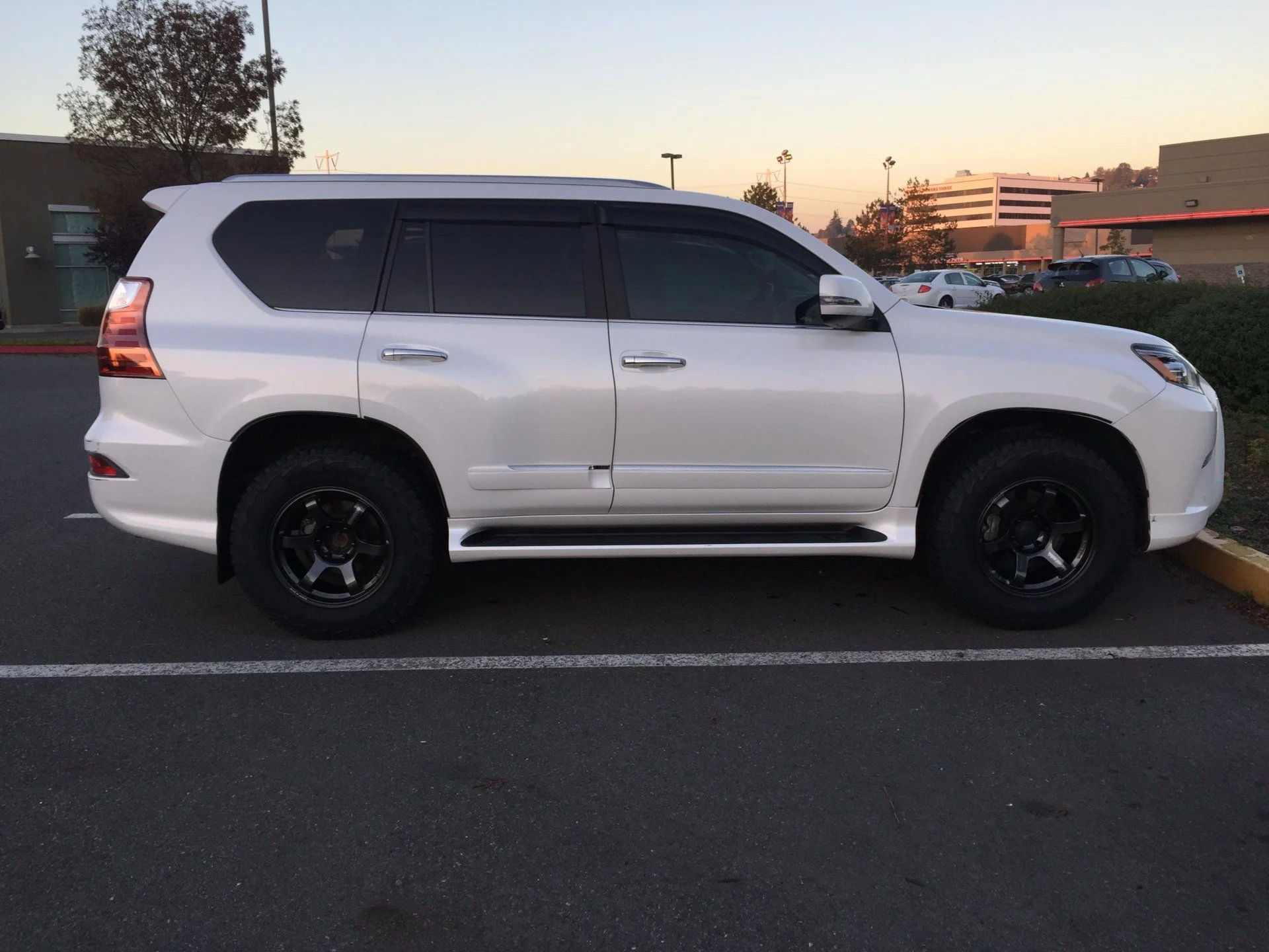

Guys,
Just wanted to share pics of my
2015 GX Premium with OEM suspension 18x9 +0 TE37 Large PCD, 275/65R-18 Falken Wildpeak AT3 and Prinsu Rack. Tires did rub a lot so i had to modify the fender liners a bit but over all happy with the look and improved handing.
Sharp! TE37’s and the rack really look great....I’m trying to source a Greddy XRoss exhaust at SEMA next week
Thanks man! I used your help on clublexus for these wheel specs and tire size and really like how your GX is coming together. Exhaust would be cool but i like the quite ride of the GX. My IS-F has all the bolt-ons and tune and it gets too loud too often nowadays.
time to chop those running boards or get some sliders!
Yeah, i know..i should but this is wife's car and i know she won't be a fan of that. I was fortunate to get this far with it. Although she did say that if i want to mod this anymore that she would just drive my IS-F...which i've declined for now.

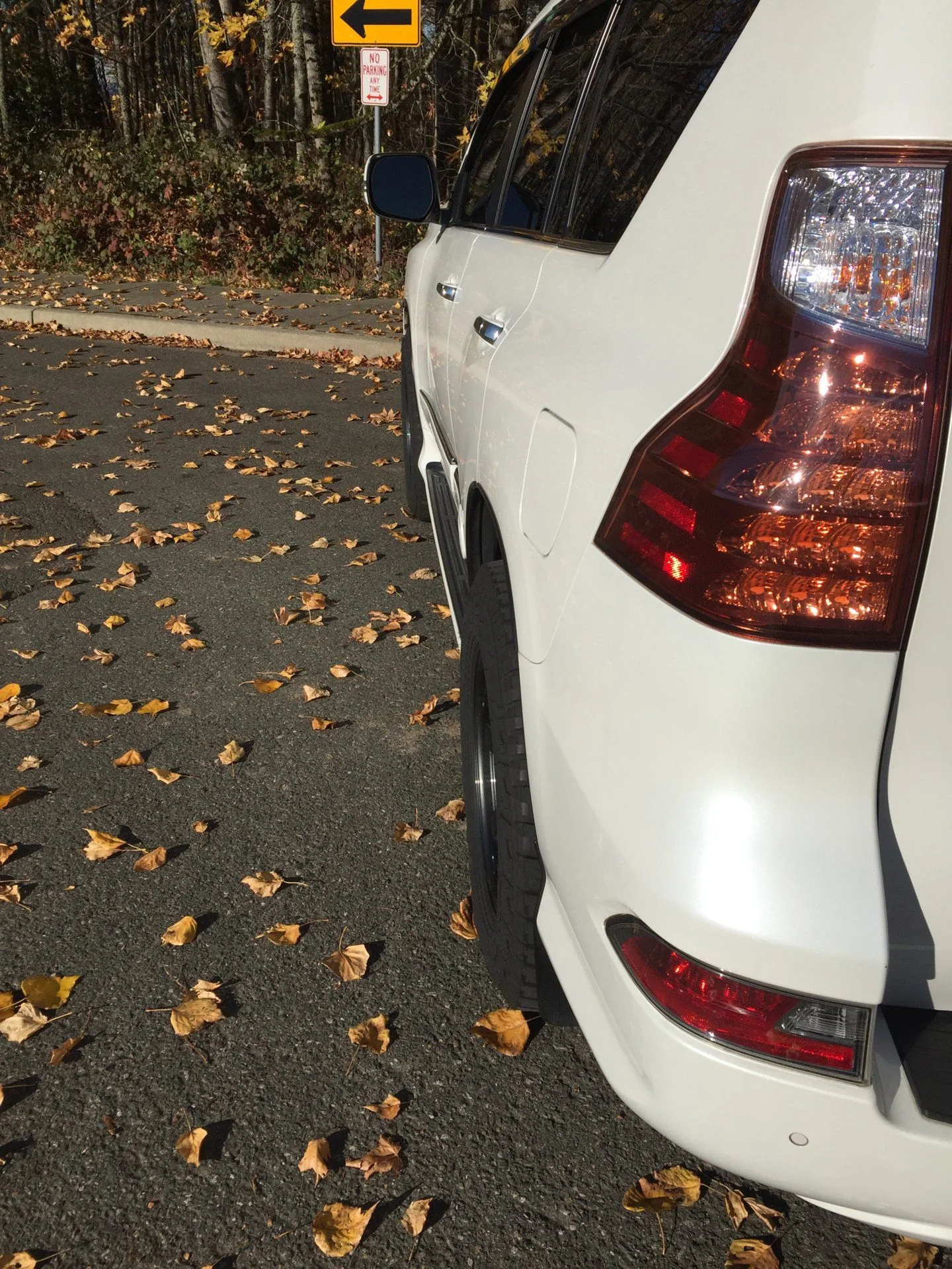

Can you take a picture down the side of your truck? I want to see how’s how much these wheels poke out with a zero offset
Thanks!
Thanks!
Sure, I can do that by this weekend. Just FYI, the wheels themselves don't poke but with the 275 width tire, it does just a little bit depending on the angle you're looking and taking pics might not be accurate enough to judge. If i had to do it over, I may choose a 265 width tire so that i wouldn't have needed to mess with the fender liners with the width/offset of these Volk.

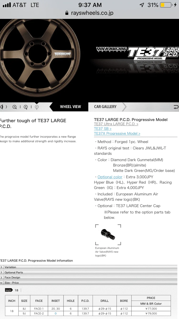

My GX isn't lifted. Keep in mind that these are 18x9 +0, so a 17x8 0 offset wheel would sit in 1 inch more and I don't think these stick out that much. Backspacing will make a difference too but I'm not able to locate any info for the Volks in regards to backspacing.

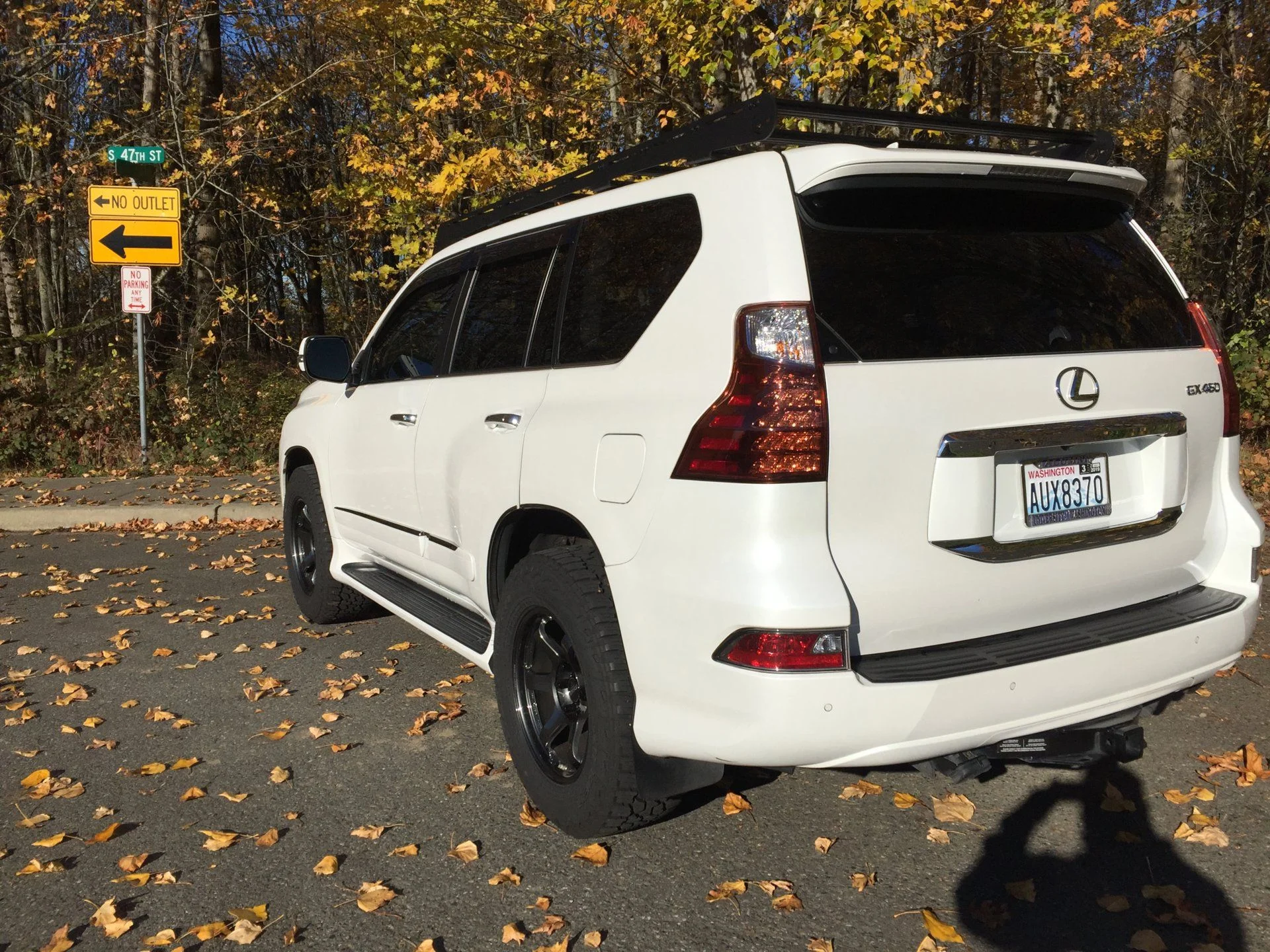

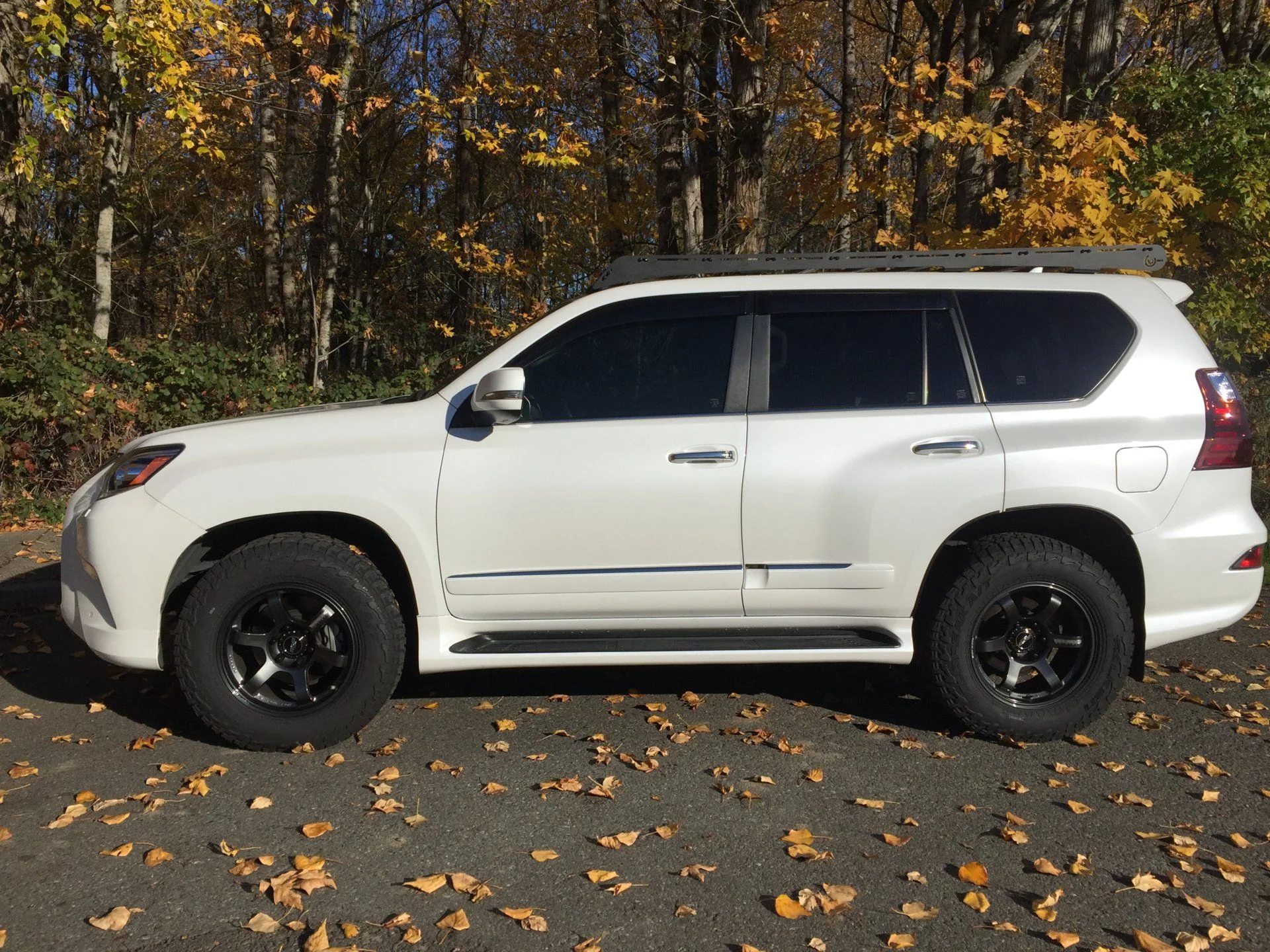

Think you could do some pic's out in the middle of the day and really show off those nice wheels and tires??
Looks good so far! Nice rig.
Yeah, give me a week or so. I will get the car cleaned up and use a better phone camera (these pics were taken with an iPhone 6) since i've now got the Ray's center caps installed.

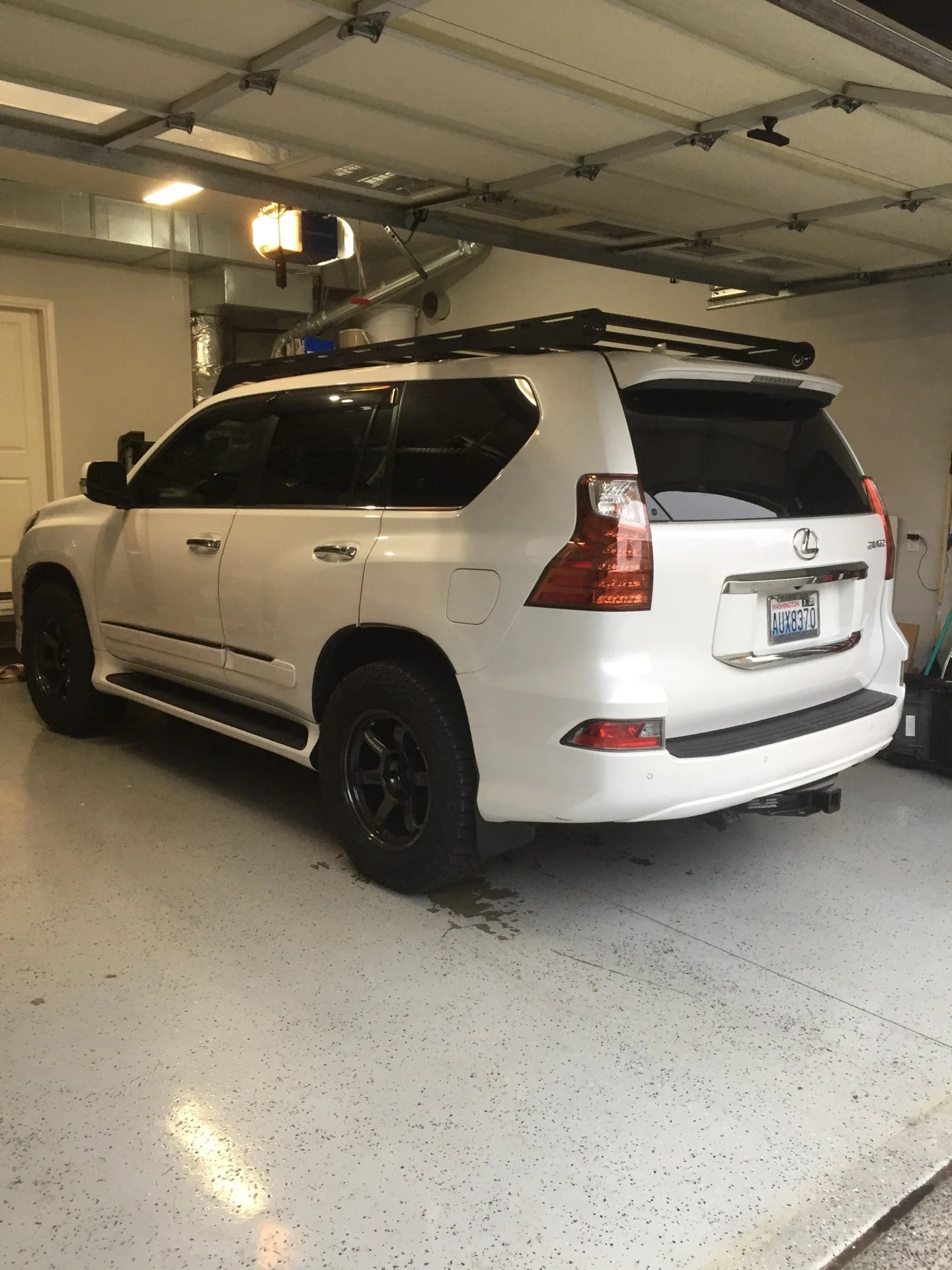

Here are a couple of pics for those who have asked about the clearance with the rear spoiler, when the glass is in the open position (no issues what so ever with hitting/rubbing).
