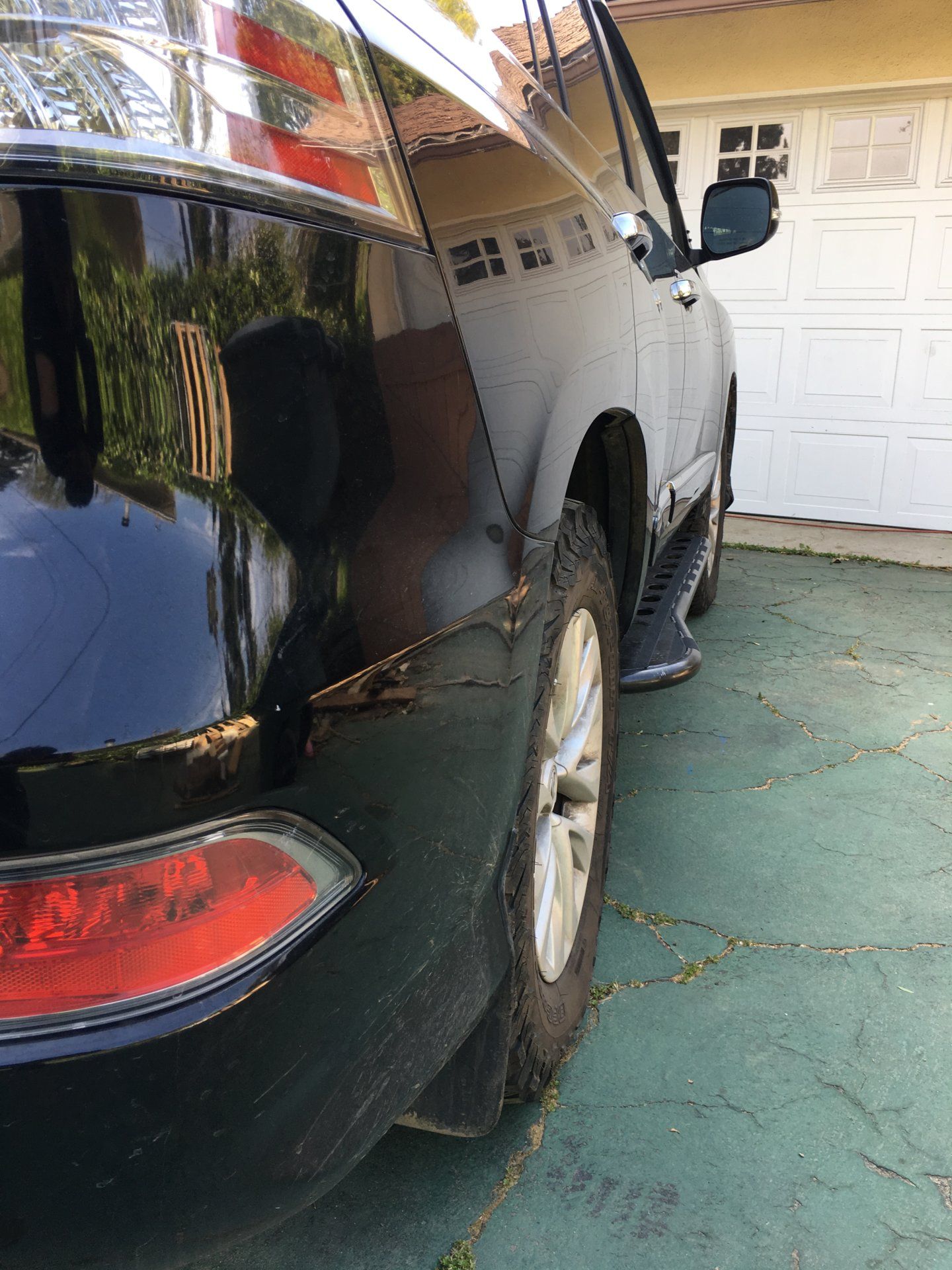

They’re RSG sliders. Saw them on Qball’s gx and liked the wide step. The steps are wider than the factory steps and the rear kick out is huge. Actually I probably would have been happy with the straight non kick out sliders, but the extra foot room is nice when you use the roof rack a lot. I might get some spacers to bring the wheels flush

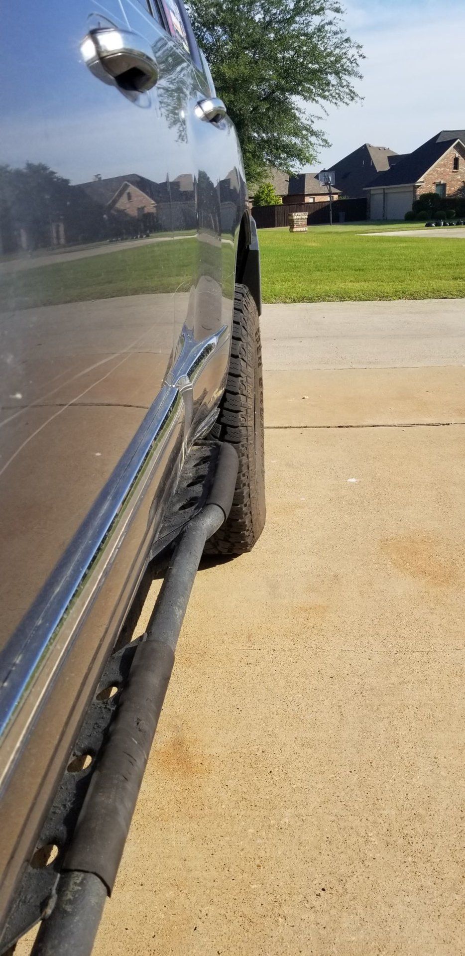

Update on the sliders. They work great, but I need to put some type of mud flaps or cut the OEM trim to put back on. Just going through a couple of mud puddles covers the steps in mud. I also added some grip tape along the edge, because when the sliders are wet they get very slippery.

Not sure if you'd want to, but the spray on bedliner in a rattle can found at your big box hardware store comes out with texture. It's almost gritty and does provide a bit of grip. It won't matter if it's caked in mud, but if just wet it does provide a bit more traction than powdercoat does alone.
I coated my sliders in bedliner and my wife and kids didn't like it because it hurt their feet when barefoot and tore up my wife's shoes when she wore anything with a leather sole. So I put on some adhesive-backed neoprene from Amazon (Amazon product ASIN B01KBQPRMI). Over a year later and it is still holding on great. It is easy to cut to shape, soft enough for bare feet, and provides great traction (even when wet). Once it gets too torn up I will replace it, but so far I haven't had to do that. If I was doing it over again I wouldn't have bothered with the bedliner and would have just used this material on top of powder coat or rattle can paint.
I thought about using Bed liner for the grippy texture but didn’t have enough time to put it on so for now it’s got a couple coats of rustoleum hammered paint and some grip tape. So far seems to be working ok but it’s only been a week. The neoprene is a great idea, I may give that a try if the grip tape wears out.
So far the grip tape has been working for me! My wife likes it as it helps her get a little purchase on the slider for stepping up into the vehicle since my sliders don't stick out very far.

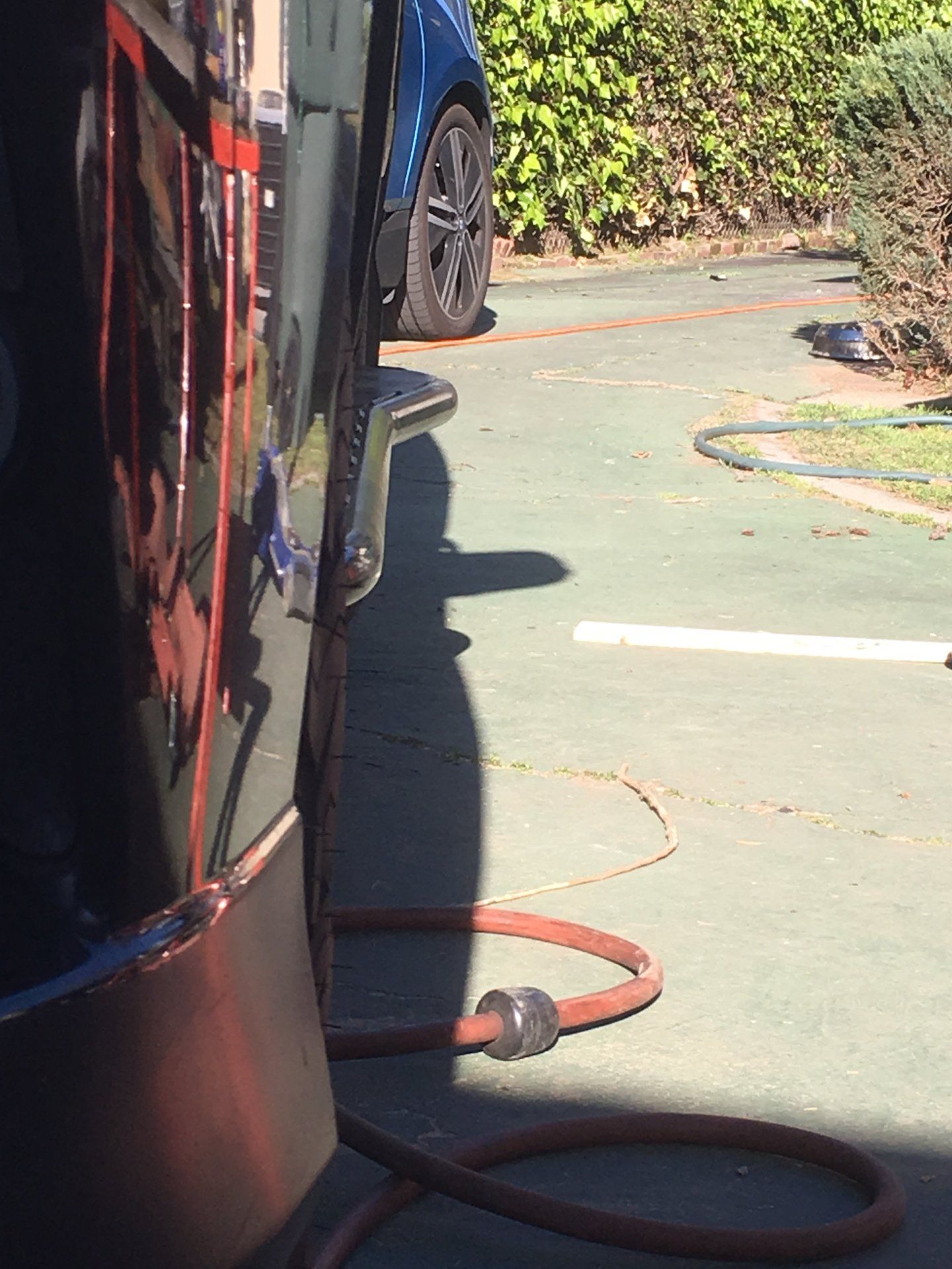

Looks good! Maybe a photo from a few feet back to see the whole vehicle and it's stance.
Oh, and don't forget to re-torque your lugs after rolling a few miles!

Actually I agree with you. I would prefer no spacers and go with offset wheels, and in the future I’ll probably go that route. This is an interim solution to see if I really want a wider stance, I figure if I didn’t like it I could always sell them or go back to stock. I’ve only had them on for a few days so I’m still debating their effectiveness.
I have heard of wheel spacer failures, but then I’ve also heard of a lot of aftermarket wheel failures too, so either way there’s some risk. I like staying with OEM wheels because they’re probably better made than any aftermarket wheel out there. Many of the problems I was seeing was due to either stripped or broken wheel studs and/or vibrations. That is one of the reasons I went with spidertrax vs a knockoff brand. Wheel studs are grade 10.9 and I’m hoping American made means better quality control. We’ll see how well that turns out. And I was careful to follow the torque specs on the instructions.
I did consider wheel bearing and ball joint life. However that problem exists whether I go with offset wheels or spacers, the wheel bearings don’t know the difference. Looking at the design of the spindle it’s already offset, so the additional 1” does increase the stress, but it’s not like stock is centered about the neutral axis to begin with. I’d estimate it increases the moment arm about 20%.

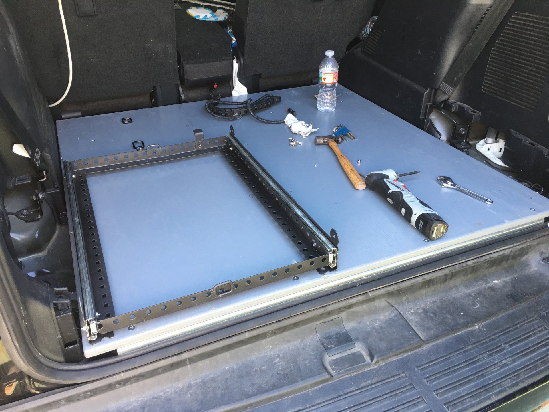

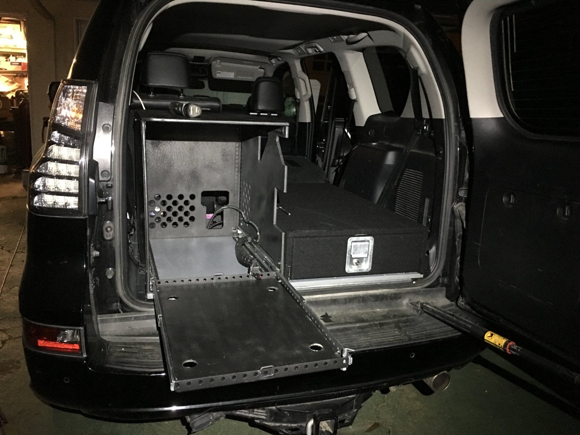

Aside from wheel spacers, here’s the other project I just finished. I built this a little while ago, but finally got around to finishing it.
First an anchor system, I.e a couple strips of strut mounted to the floor. Also some high tech insulation to eliminate noise.
1939302
Base is 3/4” plywood
1939303

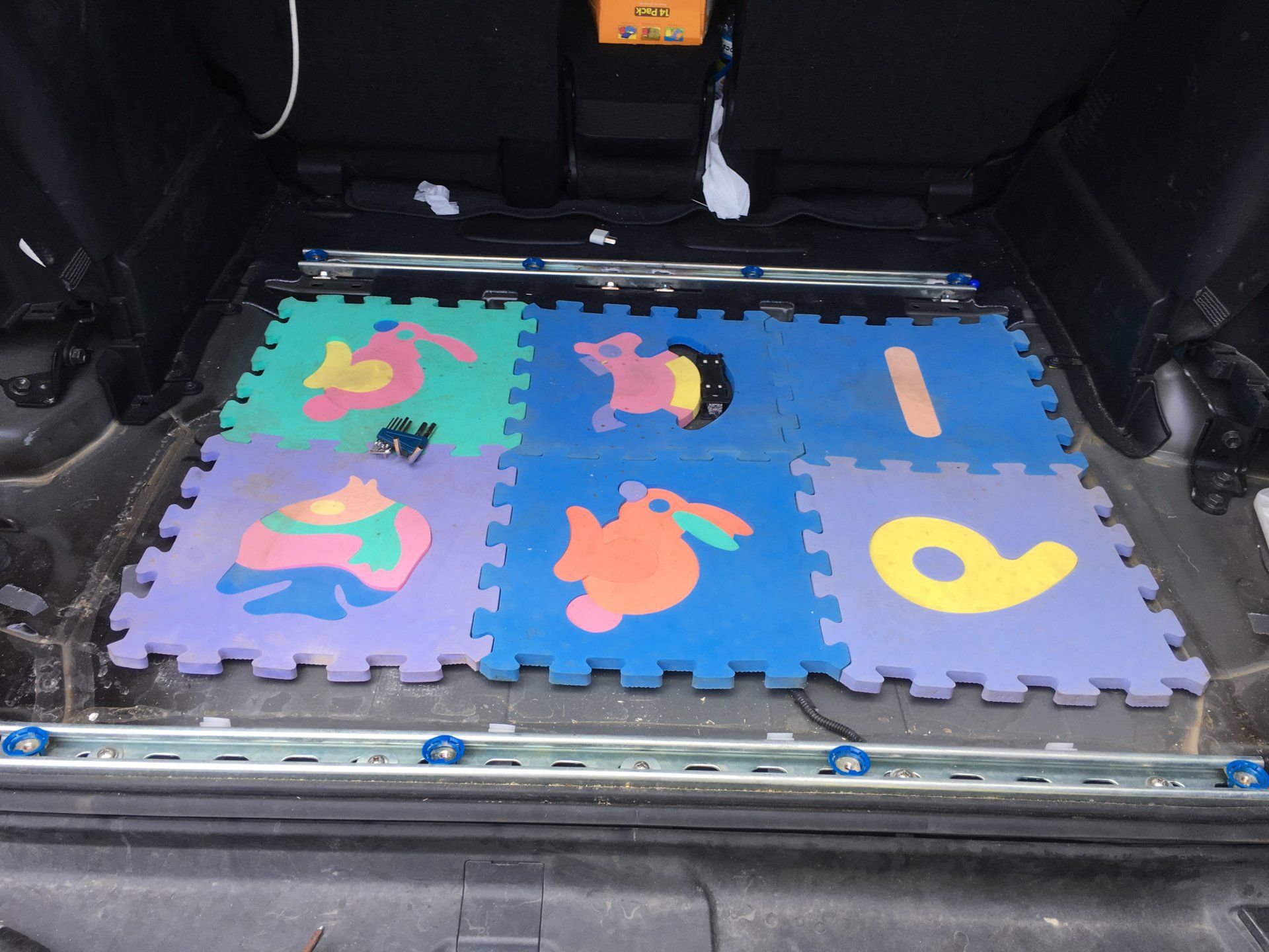

Homemade Fridge slide installed.
1939304
Drawer installed
1939305
And carpet and paint to cover all my mistakes
1939307
Final shot
1939308
It’s a quick and dirty build using mostly leftover materials because I wanted to try it out this setup before dropping a bunch of $$$ on better materials. Total cost is somewhere around $150-$200, the majority of that cost being the 36” full extension slide. The rest of it is misc hardware.
I’ve been using it for a few months now and I like it, but there are a few things I’d probably change in the next version. Next time I think I’d skip the full length drawer and go with a short drawer with trap door storage behind it. For one, once you go longer than 24” the drawer slides get really expensive. Most of the time I don’t need access to everything in the drawer so having such a large drawer just adds a lot of weight. A lot of items that don’t need quick access like tools and straps could be stored behind the drawer. I may add a sliding cover on top of the drawer o it could be used as a temporary table.
