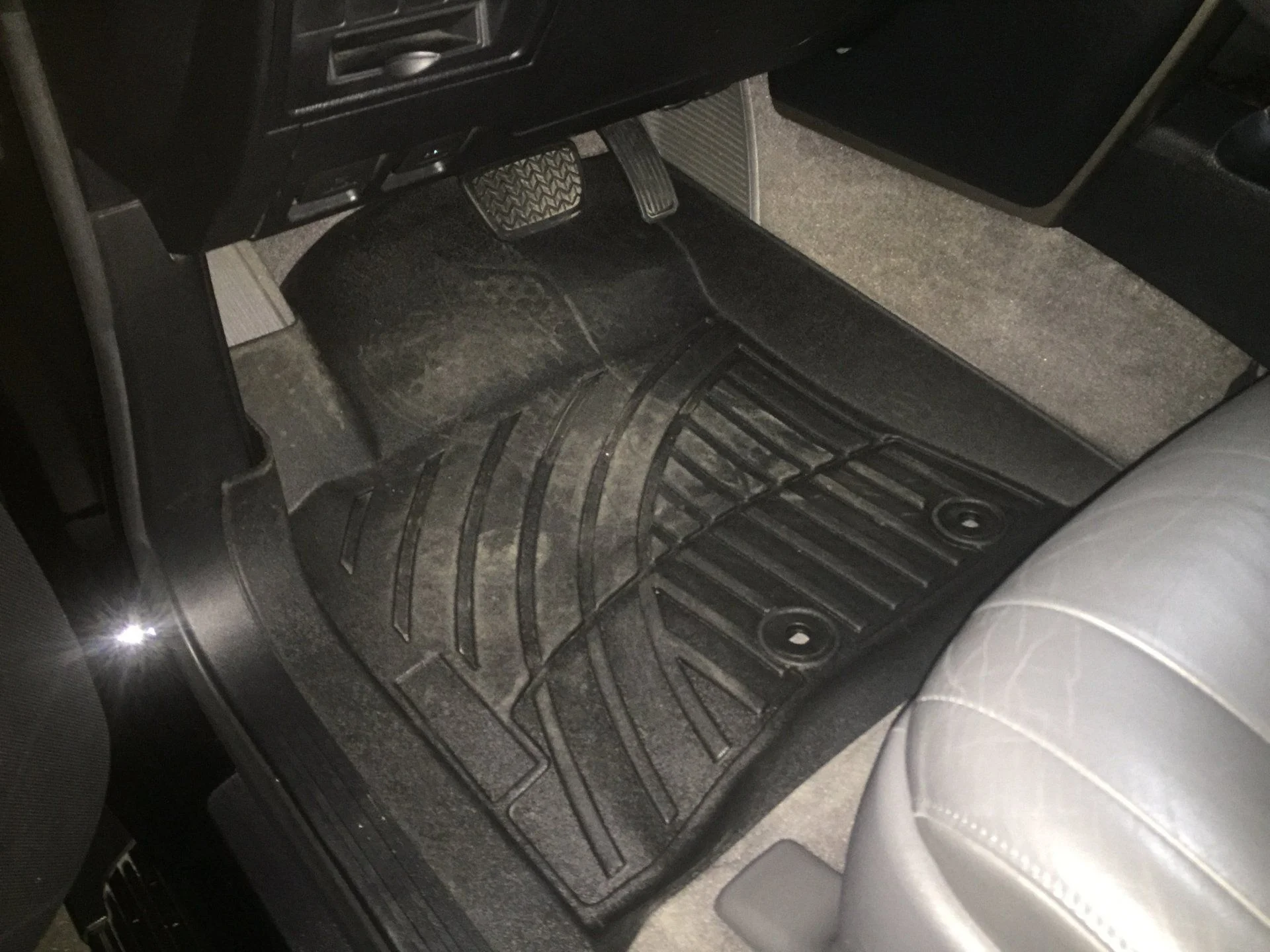

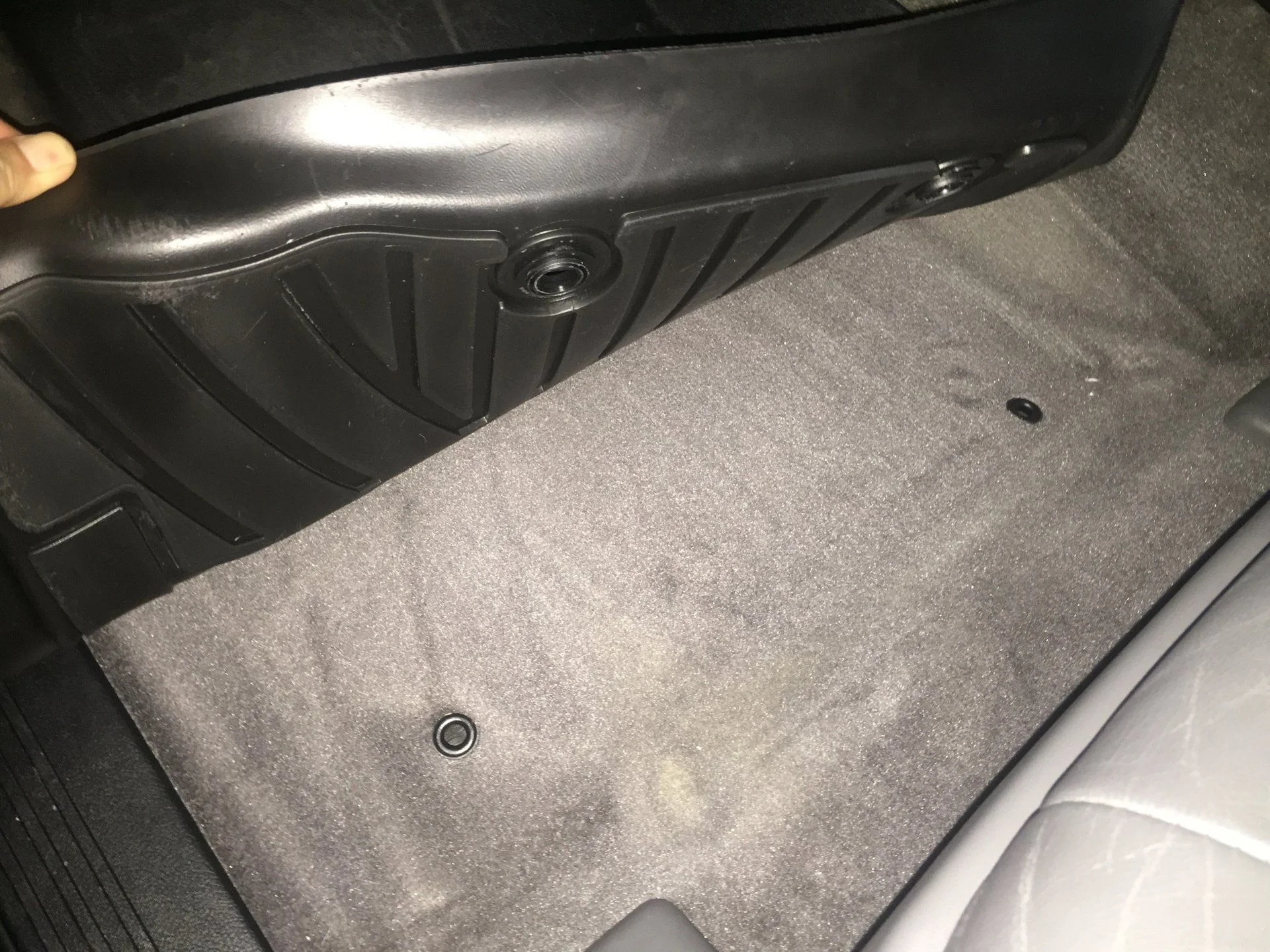

I have 2013+ mats on my 2011. The holes for the hooks do not line up

Well, at least they fit.
@HRTROB Any issues with them sliding around / not staying in place?
No issues so far. The mats I have are the moulded ones that also grab onto the kickpanel so that probably helps keep them in place. I plan on sticking some vecro strips underneath just to be on the safe side

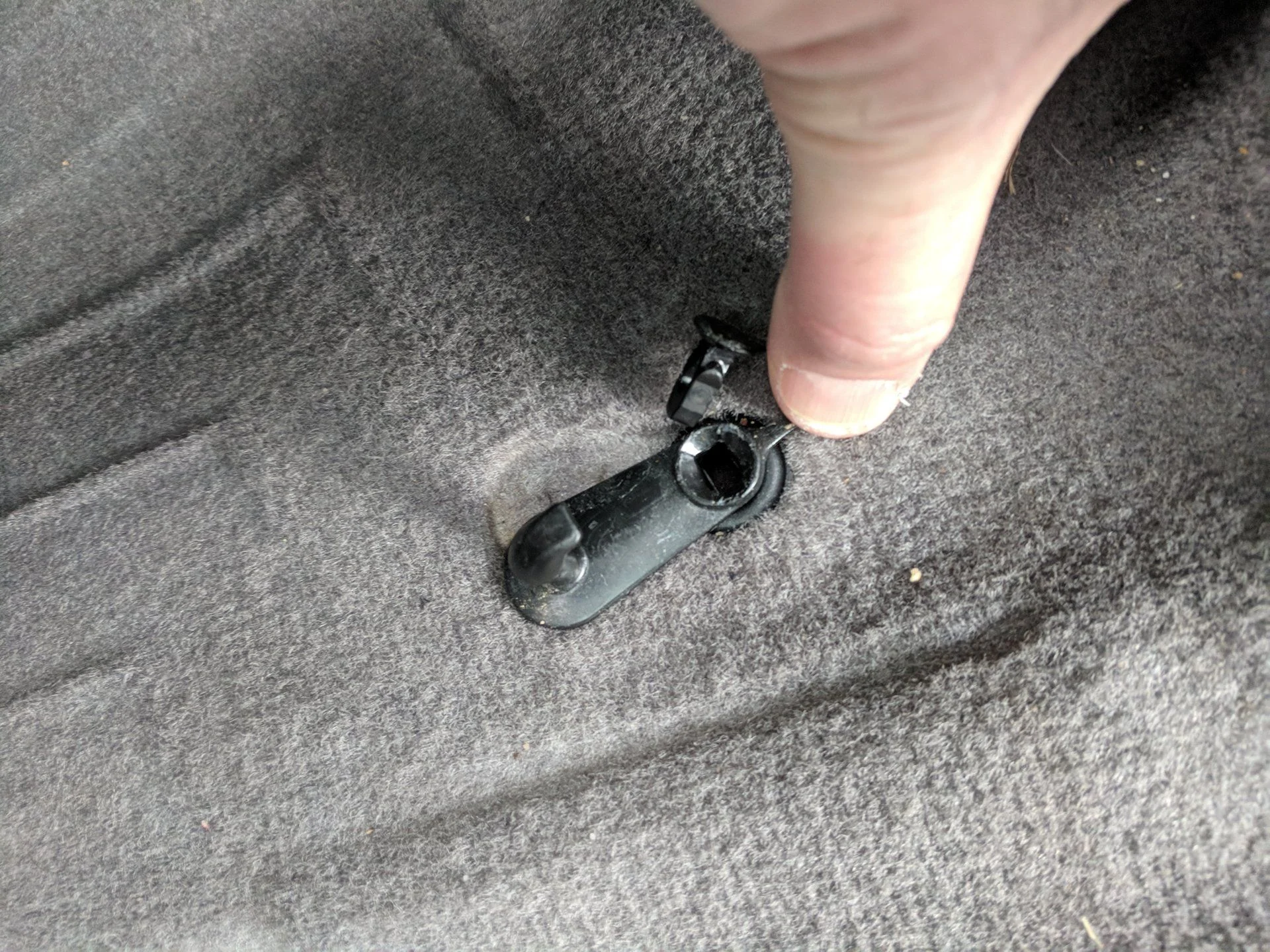

I wonder if it would be easy to relocate the pre-2013 models' retention clips to align to the 2013+ floor mats?
Edit: this is my DS clip (closet to the door) on my 2011.

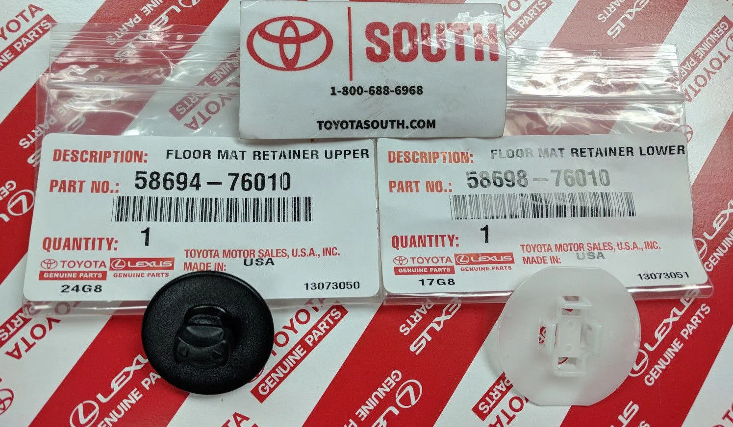

Toyota sells the new style attachment clips independently which you can then install in the carpet to use the new style mats.
Would you happen to have the part number?
