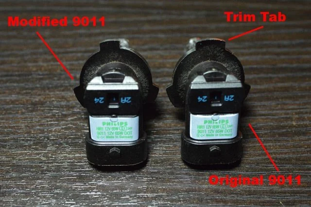

Also consider 9011 HIR bulbs in your high beam location. They need a very simple modification to the bulb base but plug in to stock wiring and improve light output noticeably without any weird color or light pattern changes like the LED options.

I hadn't heard of the 9011 bulbs, What needs to be modified? Meaning it doesn't fit in the standard housing of the high beam?
Edit to add: I used toenail clippers to make the snips. Worked great.
