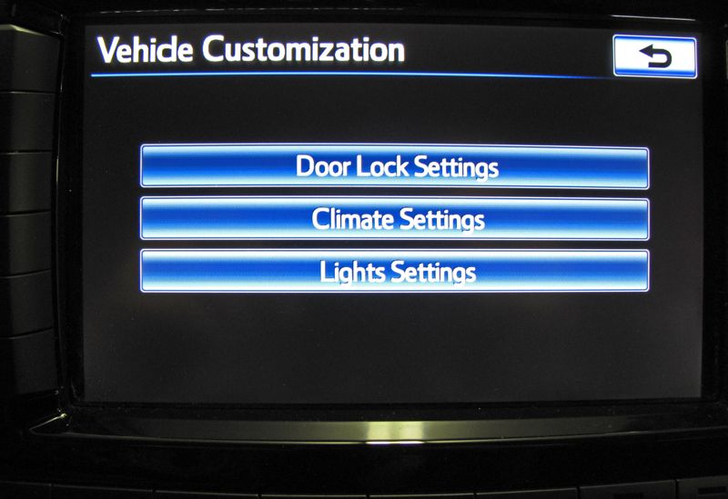

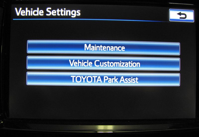

With your ignition ON, simply go to the Vehicle Customization screen and change the door lock settings to suit you.
Press the "Setup" button to get to this screen:
Then press the "Vehicle" tab on the screen to get to this screen:
After selecting "Vehicle Customization" select "Door Lock Settings" on this screen to set the door lock functions as you like them:
HTH

The good news is the NAV screen shots are from my 2013 LC, so hopefully will work for the OP.
HTH
