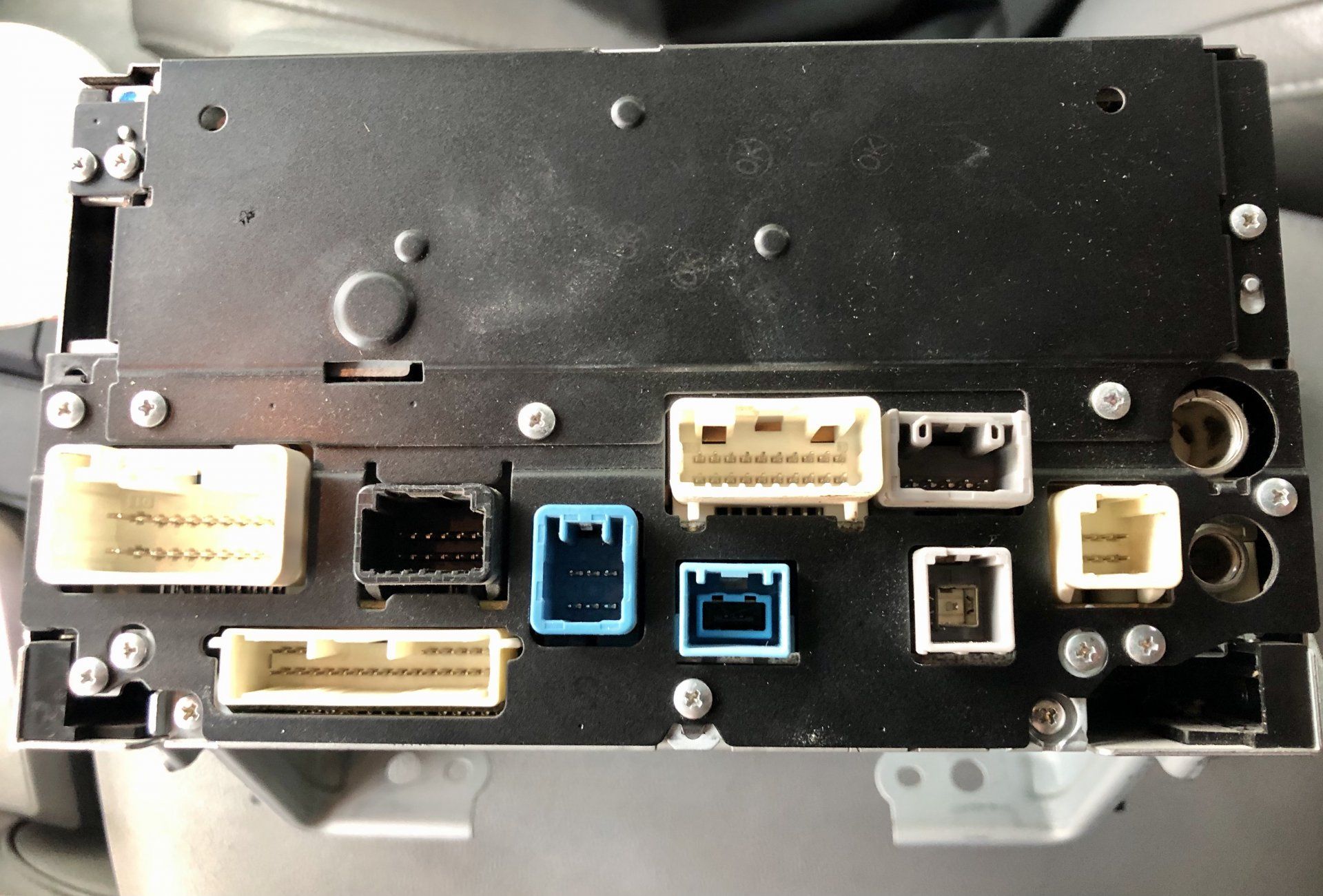

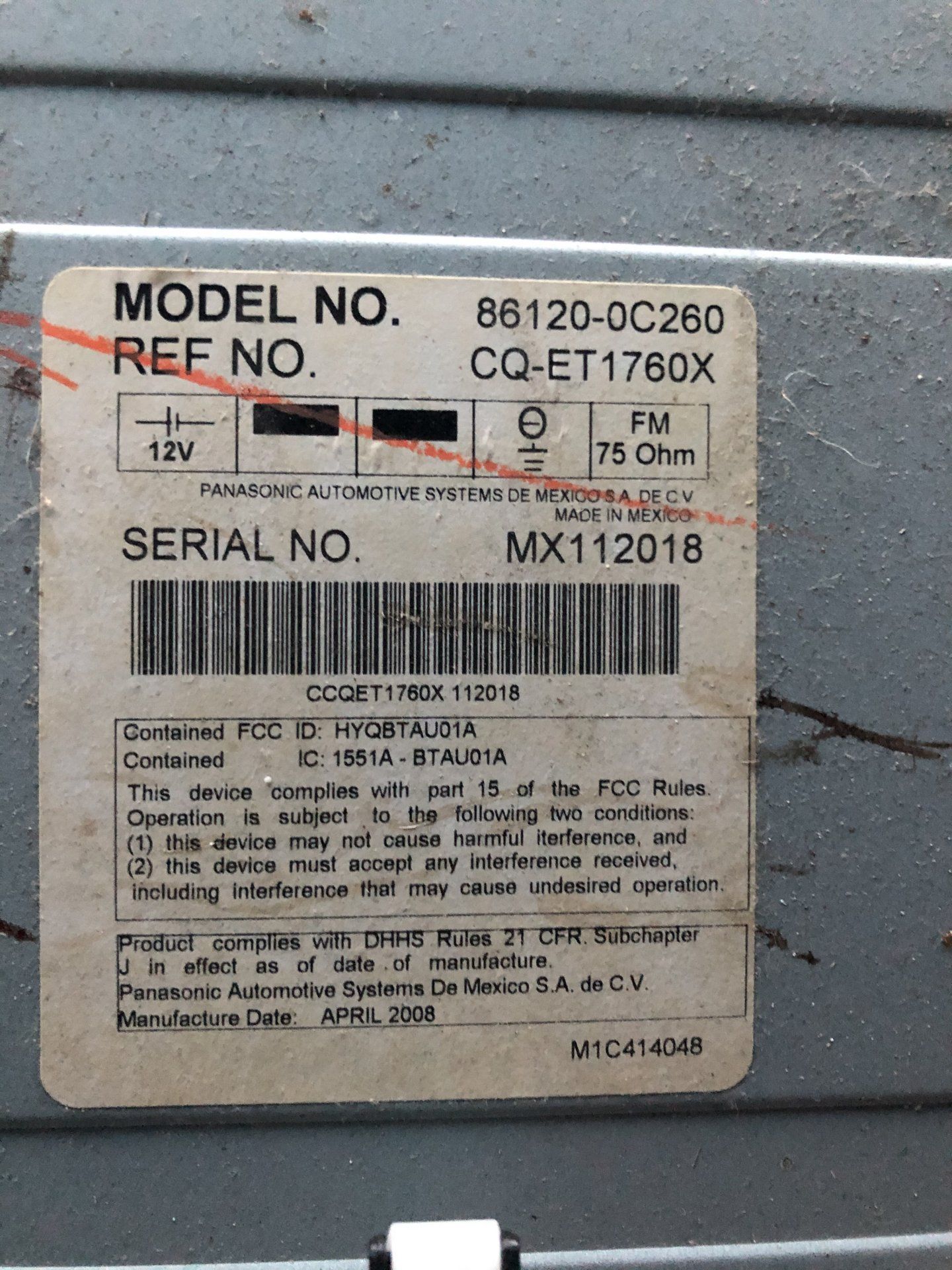

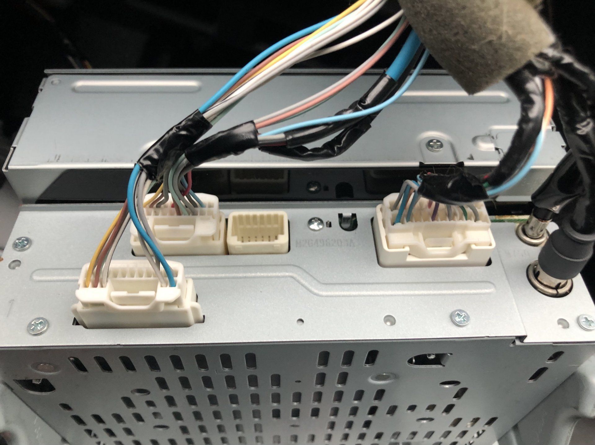

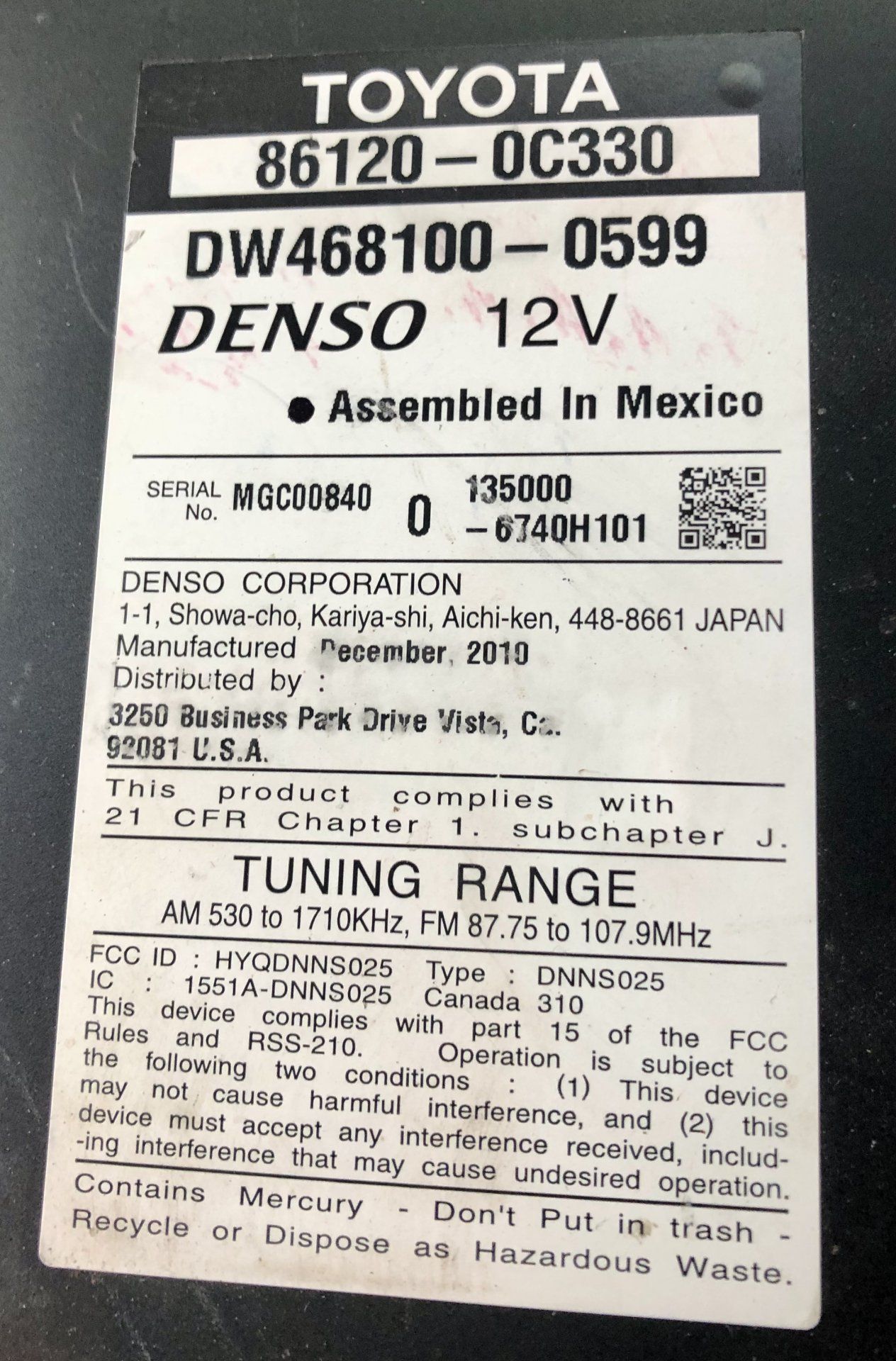

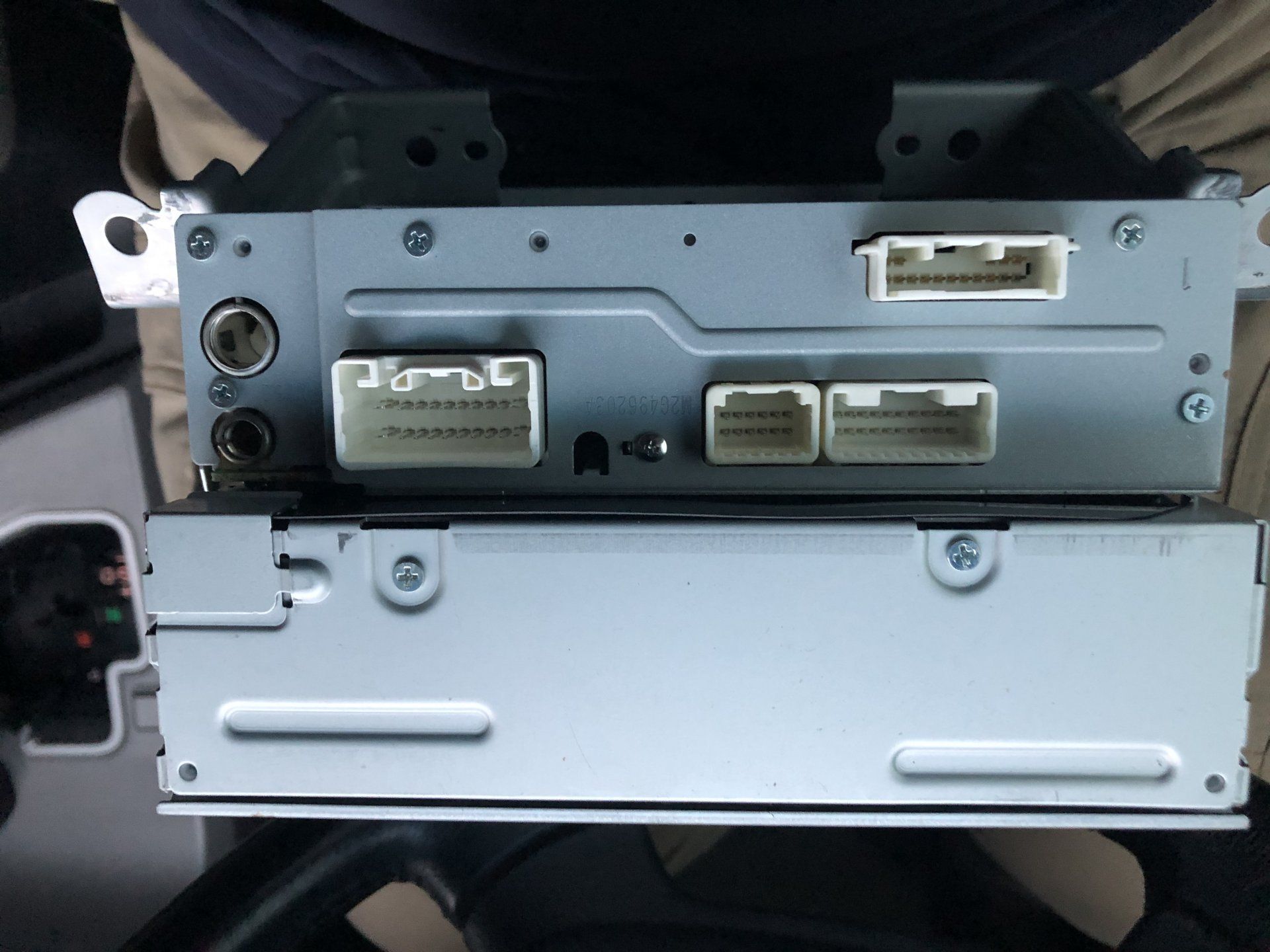

I suppose some pics might help ...
OLD UNIT
NEW UNIT
And here is the wiring plugs from the old unit
