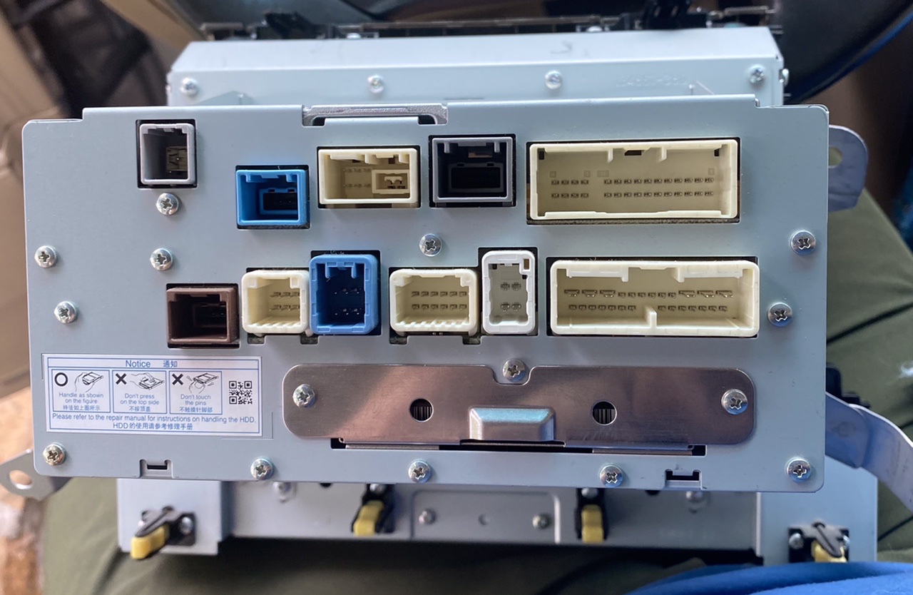

Greetings Everyone. My recently purchased 2011 LX 570 had a very faded and dim screen, so I decided to look for an alternative. I came across a listing for a replacement correct year and part number, but upon receiving it, taking out my unit and noticing the wiring harnesses in the rear are different, as are the part numbers. slightly. I plugged in what works, and the screen works and most things function, but clearly is not working properly, with no audio. I am hoping with the part numbers below and the photos, someone might be able to give me some advice on what options I have in getting this one working properly, or if it is not possible and I need to look for another alternative.
Original Radio Part number on top is 86431-60130
Part Number of Replacement is 86430-60041
The 1st photo is my original head unit, and the 2nd was the replacement. I don’t have the patience to re-wire all of this to experiment with it. I am hoping for options based on others experience. I was unable to find anything concrete via searching and researching which I am also doing, but really need solutions.
The fronts of the radio/units both look identical as well. So, I am wondering if around 2011 there was a part/number change. I have seen other 2008 and 2009 radios listed online and their harnesses look like the one I bought.
Can anyone else confirm if wiring harnesses or if the entire radio/interface changed around 2011 resulting in some 2011’s being different than others?

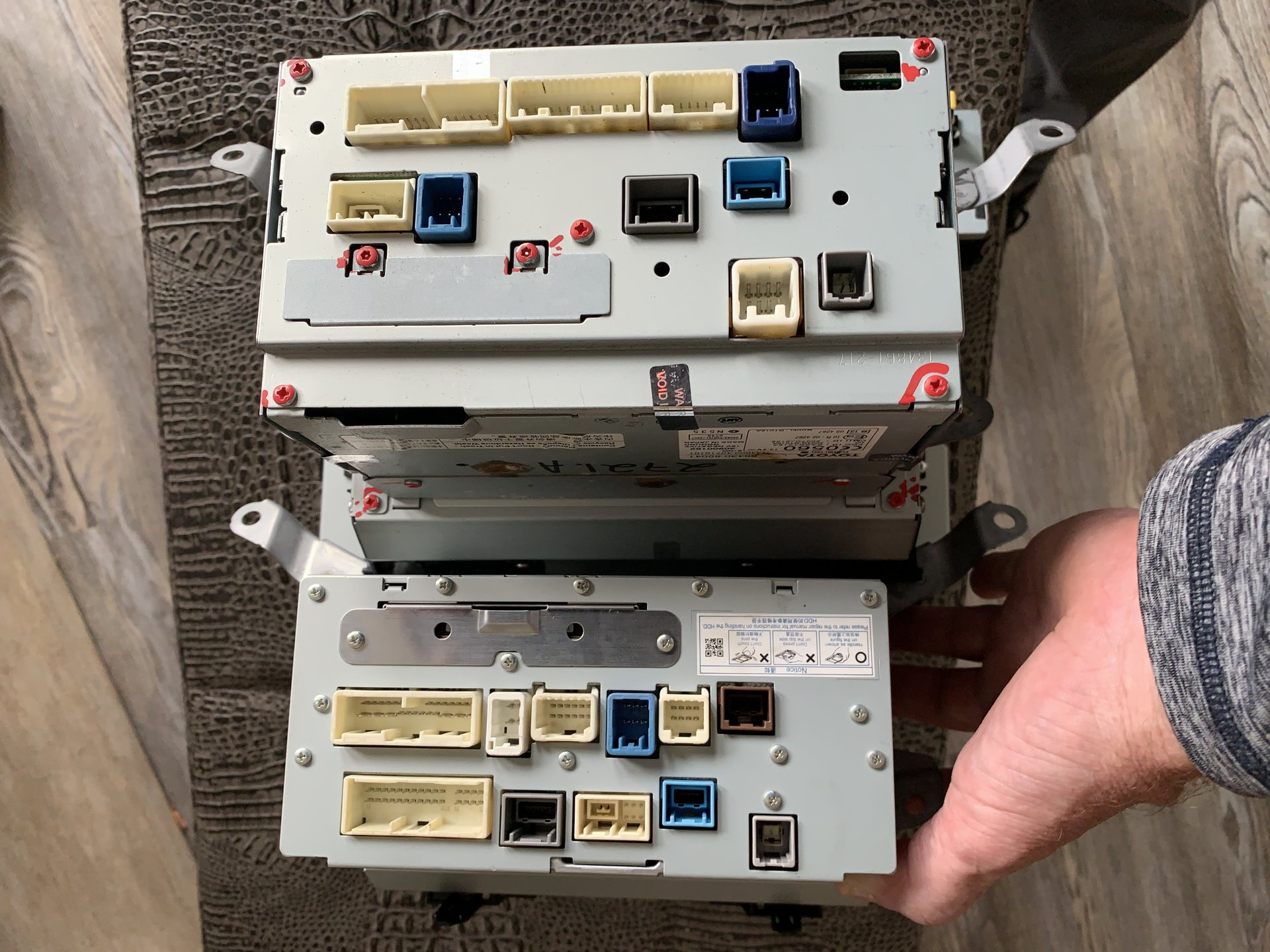

None of your pictures loaded. I doubt it matters though. I’d be surprised that you’d be able to make use of the replacement screen. There were changes almost every year from 08-15 in the infotainment system. Especially in the 09-11 years. This was when Lexus was first experimenting with its Entune Suite.
if you were handy, your best bet would be to try changing out just the screen between the two units. I have no idea if they are the same, but that would be quickest path to success. Also, if I was attempting that, I’d look for a new replacement screen over parting out a used one.

excellent info. Thank you. I bought a new screen and swapped it first, and come to find out it was a little different as well. The ribbon cables connected the same but didn’t work properly. No backlight. Put the old screen back in and the backlight worked again, so either a bad brand new screen, or it’s different as well.
The one with RED all over the screws is the new replacement.

I just recently had mine out to install a GROM Vline2. I didn't mention, but there are also variations within year. I believe the trucks with rear entertainment are probably different than ones without. I have a 2010 with RES and I believe mine looks like the lower one without painted screws. I didn't take a picture, but i do know all my plugs were in two rows like that. I will have to take it out again to complete my Vline2 wiring, so I should probably take a picture of it then.
I'm far from an authority on this, but just on features alone, I'm fairly certain the below is true. This means just for 08-15 there are probably at least 6 different monitor units. And in Partsouq there were possibly models that didn't have NAV, which would be another curveball. I doubt there were any Non-NAVs delivered in USA though. Considering the screen, the dvd unit and the amp all have to work in unison to provide all the AV features, you have to be very careful trying to replace any of the units.
