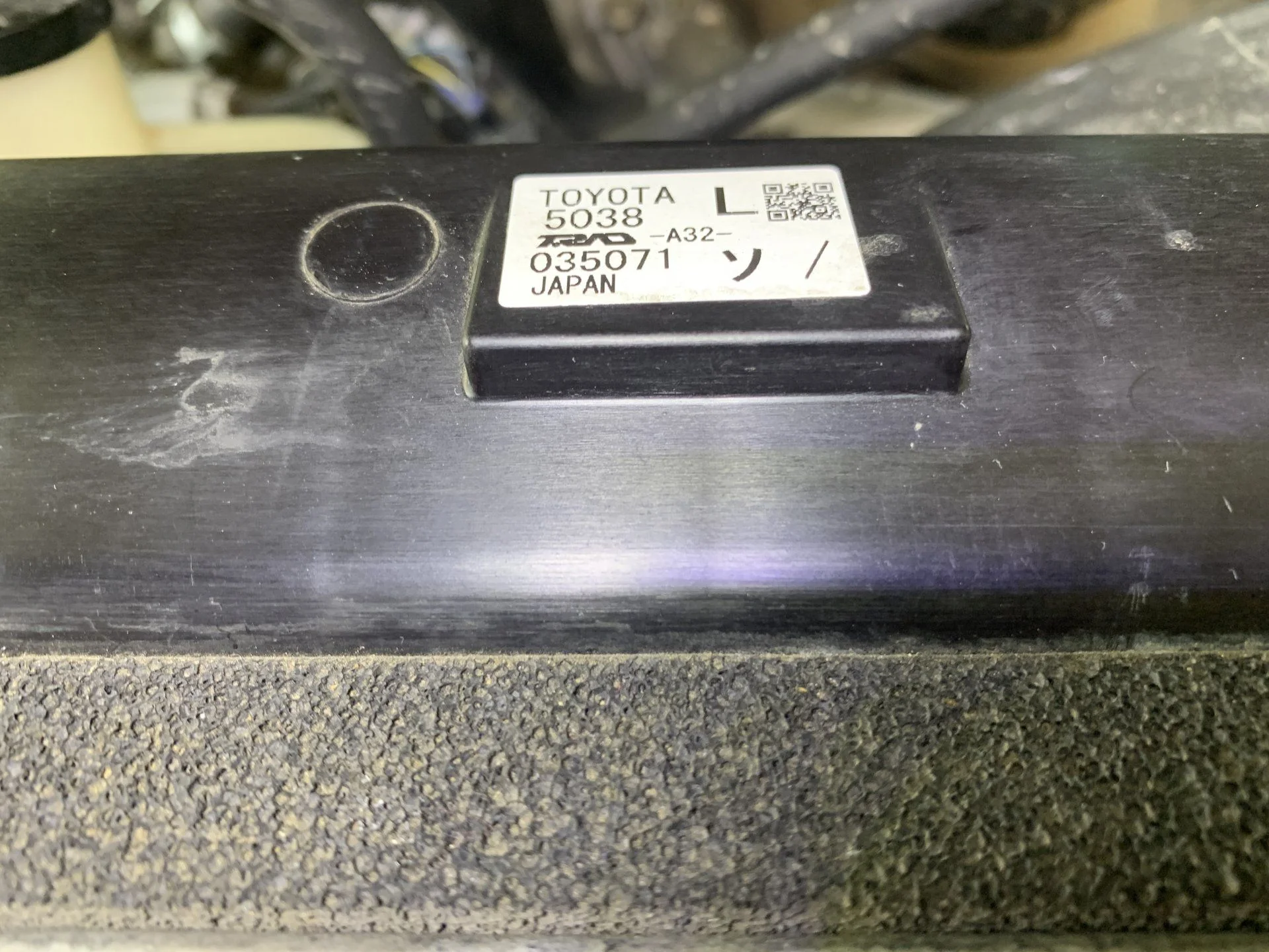

How's the radiator? Check the front of the flat area for a hairline crack.
It looks ok. I will take a closer picture tomorrow. I looked up the service history and it was replaced at 118k July of 2017. Its now at 178k. Unfortunately they didn't put the new style in.

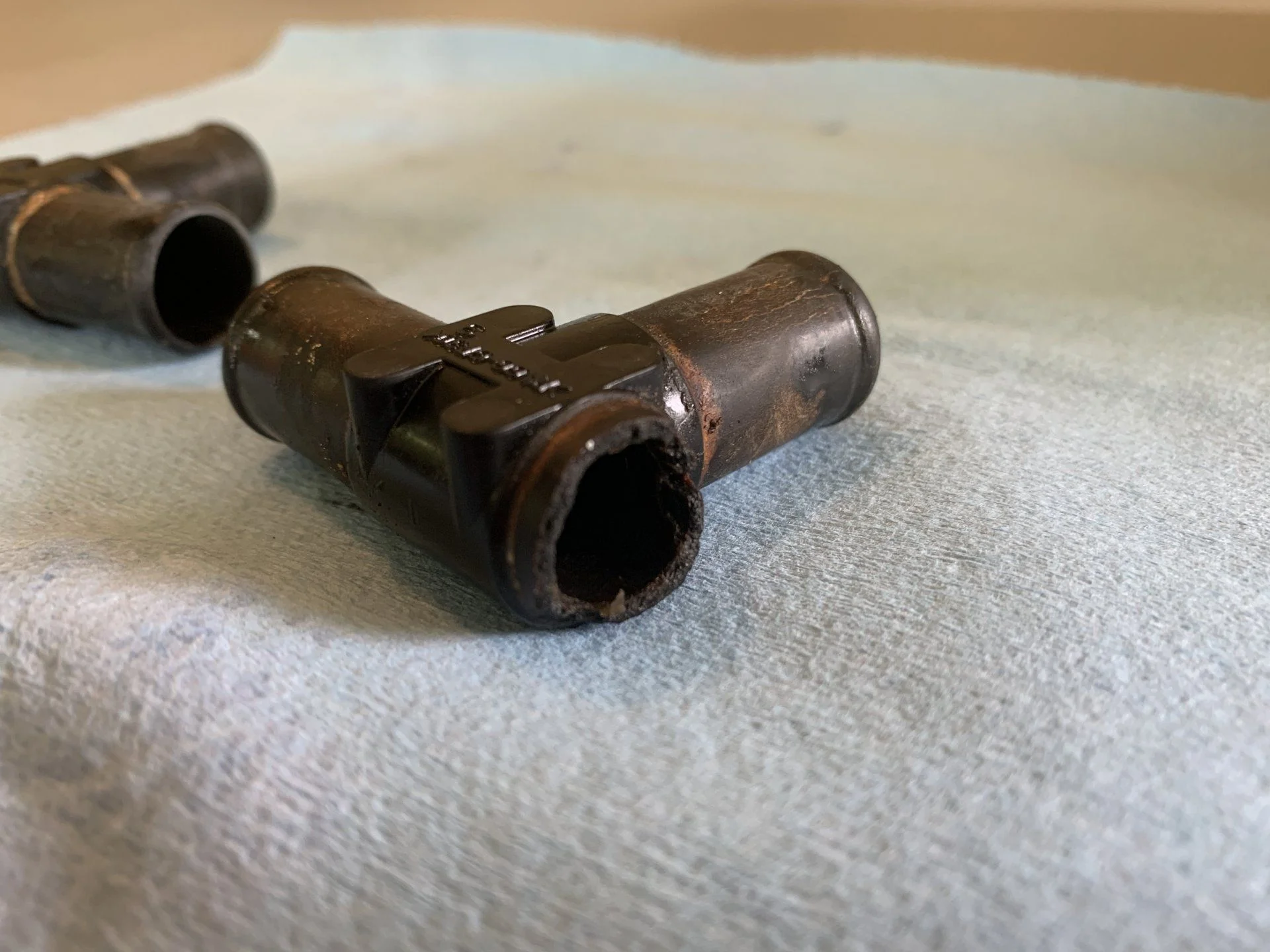

Got the pcv in and the coolant tees. If you have not yet replaced your tees, do so now or carry a few with you at all times. I barely touched one of them and one of the necks broke off. Getting the neck out of the hose, it was a crumbly mess. Also a pic of rad crack area. Hopefully it gets approval. Lol. Time to clean up the intake area on heads and set the intake in.
Those tees are in bad shape. Mine were in good shape but I replaced them anyway just because. PN is 87248-08030 (for another model but same size).
Radiator looks good, If it was already replaced you should be good for awhile, even if it is the old design. Just keep an eye on it.

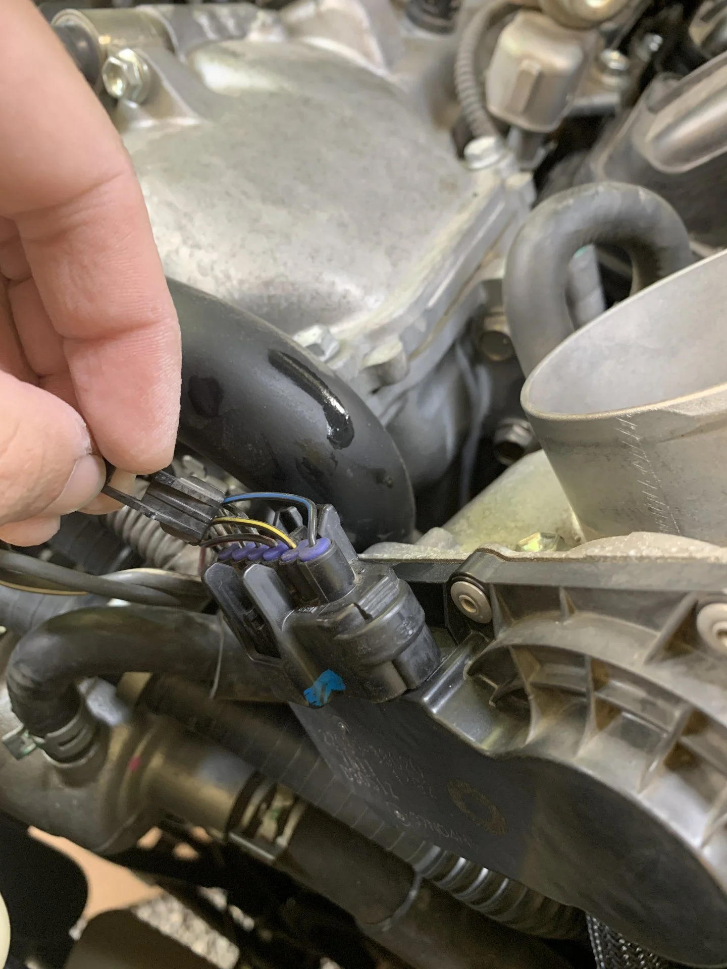

I had planned on replacing them. Maybe next time I will go with some metal ones when I replace the hoses. Almost finished. I guess I broke the throttle body connector when taking everything apart. I assume we can buy replacement connectors? A ziptie will work for now.

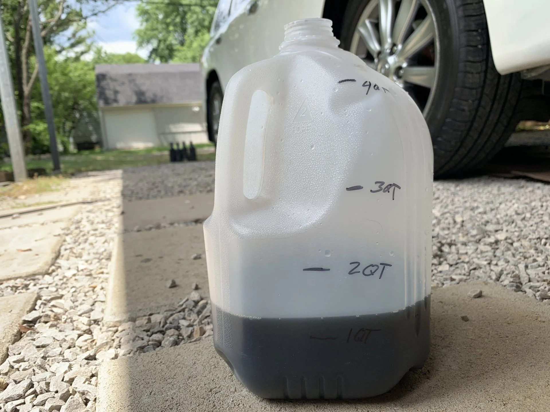

Continuing the baseline. I will just keep this 1 thread going to not spam the forum. Next up is the AHC fluid. Vacuum out a little over a quart from the reservoir. Looks pretty dark.
