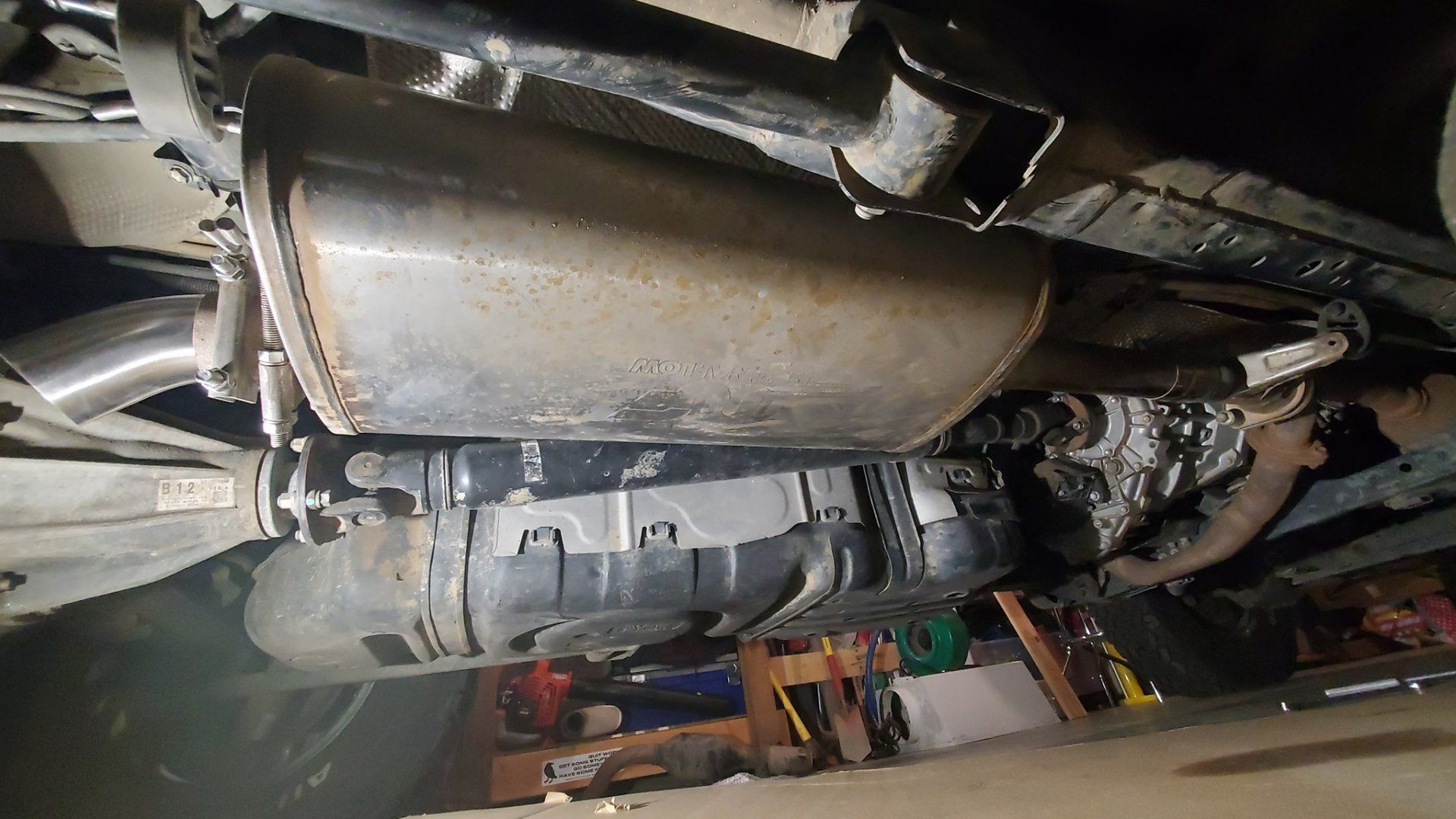

I messed around with my exhaust. I saw the Magnaflow Overland series, but for $650 it seemed like I could do something similar to that for a fraction of the price. I drove a straight pipe for a couple of weeks. It was fun to turn heads as I puttered around parking lots, but it was obnoxious at 3K and 70MPH driving up a grade to get home BLLLLAAAARRRGGGHHHHH
My first iteration was a Magnaflow 11xxx series muffler, dumping right before the axle. I "bolted" it in, starting right at the Ypipe. But that muffler honestly didn't make much difference. Maybe a bit quieter on normal acceleration, but still, BBLLLAAAAARRRRRGGGHHHHH climbing up a grade:
So I went to the longer, wide 12xxx series, and cleaned up the install once I committed to the measurements.
The 12xxx series is much better for me. It smooths out to a mellow tone at 3K RPM up a grade, is stock quiet on idle, and growls when getting on the gas. A much better compromise!
Still have to use those bulky ubolt clamps on the short downturn since they also acted as hangers for everything after the ypipe.
