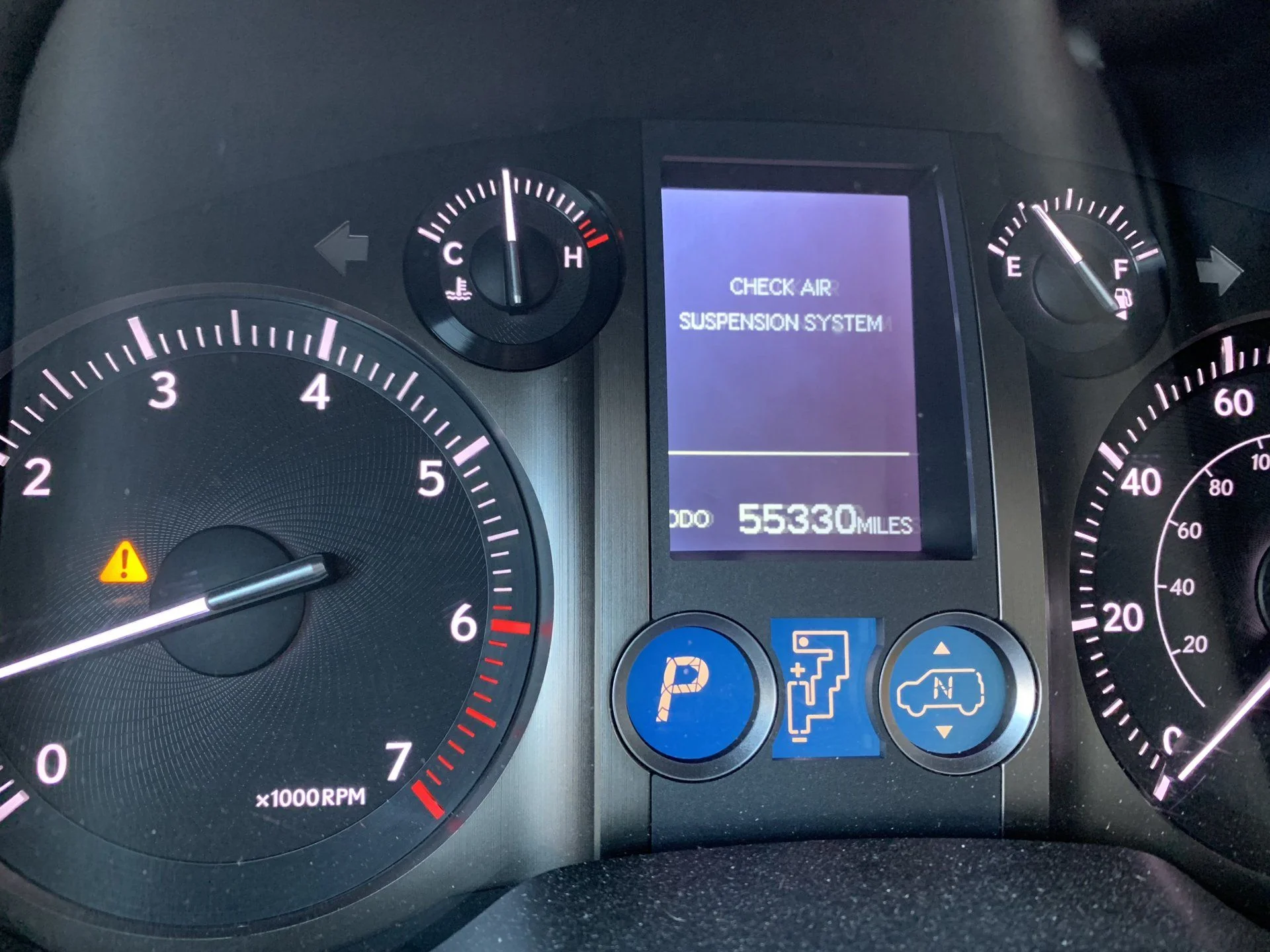

Hello,
2010 460 airbag delete done but have this message. “Check Air Suspension System” and a orange triangle with an exclamation point.
Removed Air Sus 50A and Air Sus Fuse #2

So I bought a 2013 with a lift and rear air bag delete, and it also has this message on the dash. Has there been an easy fix determined here on MUD that I have not been able to find thus far? Thanks!!!

After the washers have been added, is there some sort of reset you need to do? I've got all my washers on (including longer bolts) but the message is still displayed on the dash.
Do you have Techstream or OBDLink handy? You could pull codes to isolate what it is still unhappy about.

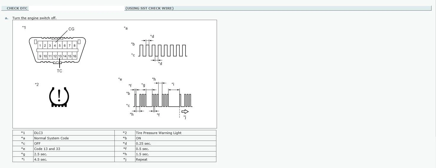

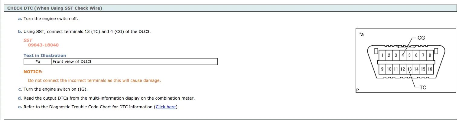

••WARNING: I have never done this myself so I urge extreme caution as this is just what is printed in FSM. Proceed at your own risk.
••WARNING2: Pay careful attention to the OBD port. In actuality it is upside down under the dash and not same orientation

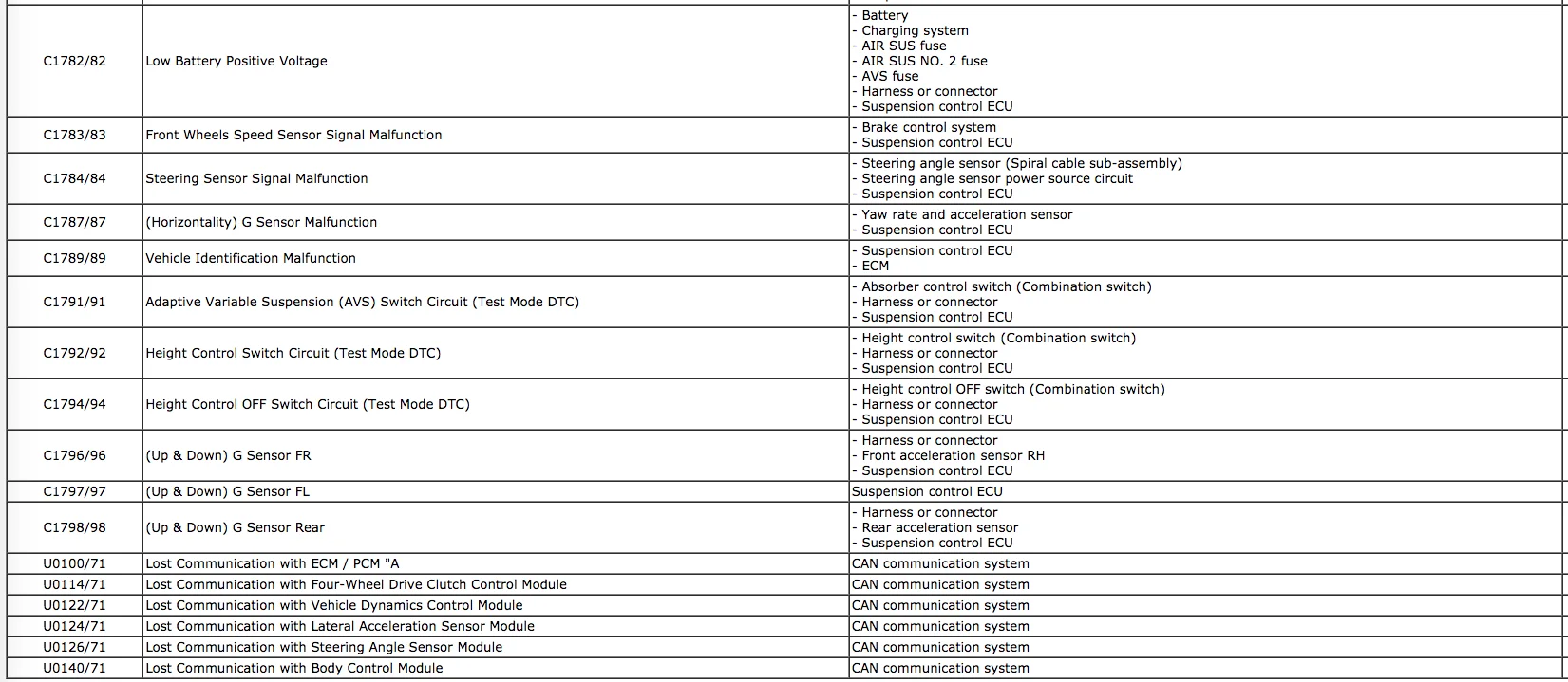

The codes for missing AVS shocks will be unavoidable. They will always show up in a scan tool as well with them removed.
Flash pattern legend
How to get into this mode

Numbers after "/" are the blink patterns

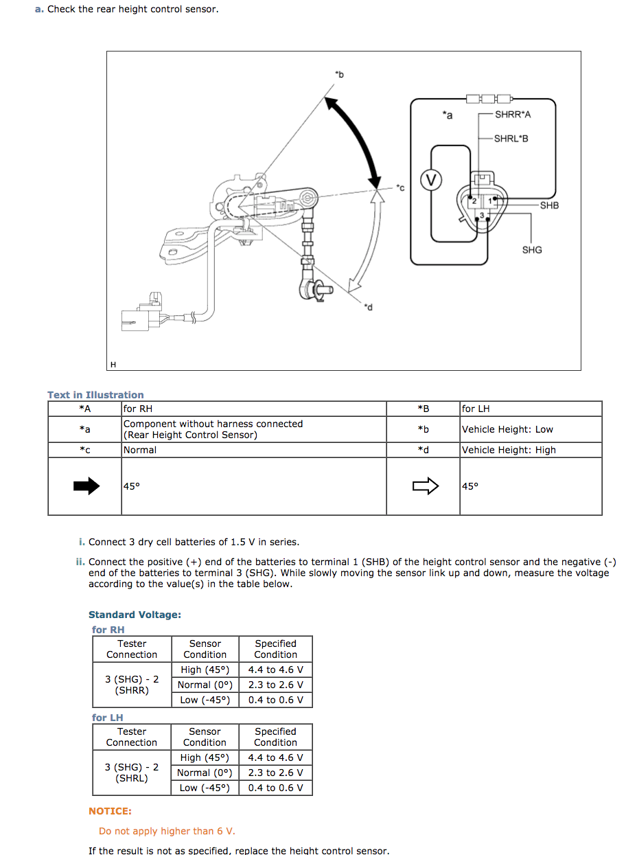

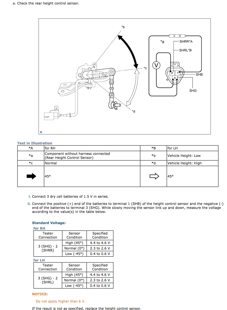

Height control adjustment parameters
IMO: Get within 2.3-2.6V range since over 18-19MPH it defaults to this range.
There IS only one AFS senosr, in the right rear of GX's, correct??
I just did this test and my AFS sensor is working, well very close.
I'm reading:
High 45°: ~4.28 (outside tolerance, a little on the low side)
Normal 0°: ~2.5 (within tolerance)
Los -45°: ~.47b (within tolerance)
So even though my high is is a little off, that shouldn't cause my AFS light to default on all the time, right??
