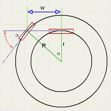

I did some math, and if the way Toyota is measuring the turning circle has changed from curb-to-curb to wall-to-wall, then the difference in numbers makes sense. Here is how I interpret the measurements:
Curb-to-curb turning circle is measured at the outer front wheel.
Wall-to-wall turning circle is measured at approximately the corner of the outside front bumper (the farthest point from the center of the turning circle).
Here are the numbers I'm using:
Wheelbase = W = 109.8"
Overall Length = 192.1"
Front overhang = (192.1 - 109.8)/2 = 41.15" (this is an approximation)
Turning radius (curb to curb) = R = 38.1' / 2 = 19.05' = 228.6"
Using all those numbers and the diagram from this web page:
2014099
Based on my calculations, the front wheel turn angle = alpha = 28.7 deg.
Then, I calculate the rear wheel's turning radius = r = 200.5"
Finally, the wall-to-wall turning radius ends up being 251.0" (not shown in the picture), which equates to a turning circle of 41.8'.
(Let me know if you want the math details for the previous calculations.)
Like I mentioned, I am approximating the front, overhang, and the bumper corners are rounded, not squared off. That's why my number (41.8') is larger than what Toyota reports (41.4').
I should also mention that if I calculate the front wheel turn angle based on the steering ratio (18.4:1) and steering wheel maximum lock-to-lock (3), I get a maximum front wheel turn angle of 29.3 degrees.
This results in a calculated wall-to-wall turning circle of 41.7' which is also close to Toyota's number.
Tortoiseracing,
Great job doing the math. I think we solved the puzzle and you confirmed it. Considering that a stock GX could get hung up on many curbs... Measuring wall to wall is a more accurate real-world reality with any low hanging front end.
