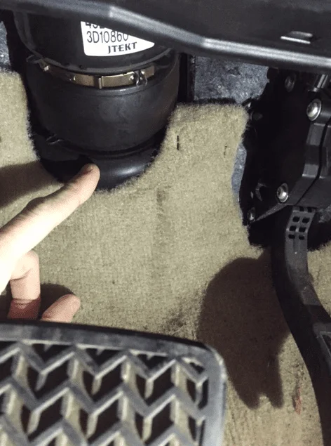

I noticed it starting again last night. I may try to full pull the boot back and grease it, rather than trying to just shoot a bit into the area. I'll take a few photos and let you know how it goes
Ok so this is the boot. You can slide it upwards quite a bit from the bottom but it appears to fit down into the firewall. Rather than grease from the bottom this time I shot a bunch of silicone grease in at the top of the boot. There's a little hole in the plastic panel which makes it fairly easy to spray grease like that if your bottle has a little red wd-40-style tube.
That seemed to quiet things down for now. If it persists I'm going to look for a replacement boot/clamp or something online before I take it apart to stuff it full of grease, since that metal clip looks like something I won't be able to re-secure once I pull it off to get inside
