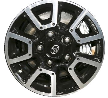

I don't like the Method wheels that came with the vehicle so I'm switching over to Tundra wheels just like these with 60mm offset it appears.

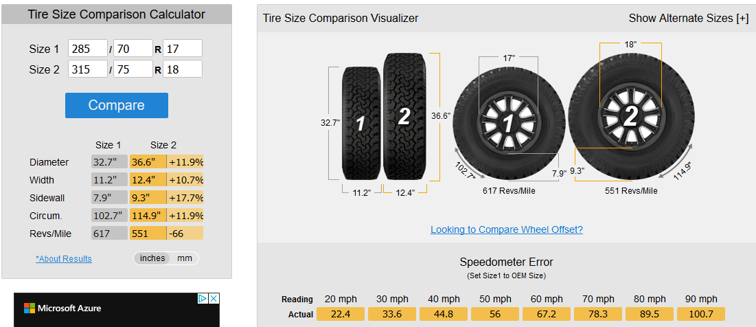

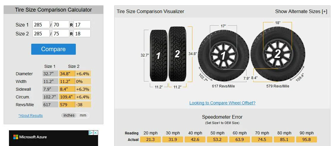

Will I be able to run these wheels with 285 76 r18 AT's or 315 75 r18?
Tire Size Comparison
or will there be to much rubbing issues?
Will I need to re-gear to 4.88's?

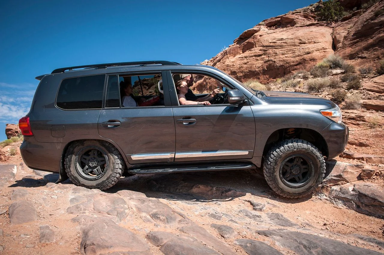

My 1.5 cents: (As a guy with 35’s)
At best, 35’s will rub somewhere...sometimes...at certain compression and turning...against something.
Exactly where that rubbing occurs, and whether it’s a real problem...depends on a ZILLION variables like UCAs...forward/rearward adjustments during alignment...spacers...KDSS relocation brackets or not...front bump-stop sizes...rear bump-stop sizes...wheel offset...tread WIDTH including the shape/tapered nature of the specific tire model...
In other words—It’s complicated, and until they are actually on your vehicle...don’t believe any blanket promises of a simple yes or no. And no...even engineers cannot tell you exactly what will specifically happen...because there are too many unknown, real world measurements you simply cannot look up...and how various installs ride and sit differently depending on nonstandard factors in each truck’s other factors like weight, etc.
If you want to save a lot of adjustments and prefer skipping expensive regearing (not required, but recommended) or simply want to avoid all rubbing...stick around true 33ish (I say “ish” because 285/70/17’s are often called 33’s...but are usually more than a full inch shorter than that on the truck).
I run “35’s” on BP51’s with OME 2725 rear springs (super heavy) and have Slee’s KDSS relo, SPC UCAs, forward-adjusted wheels via alignment, .75” Bora wheel spacers in combination with 50mm offset Rock Warrior wheels with 35x12.5x17 Nitto Ridge Grapplers.
Despite ALL of the above, my rears touch the rear wheel well on full stuff (not dangerously, but they can touch), and occasional sway-bar touches in front under extreme articulation when turning to full lock.
The most reasonable approach is almost undoubtedly 33’s. I like my 35’s but going in with eyes wide open is important.

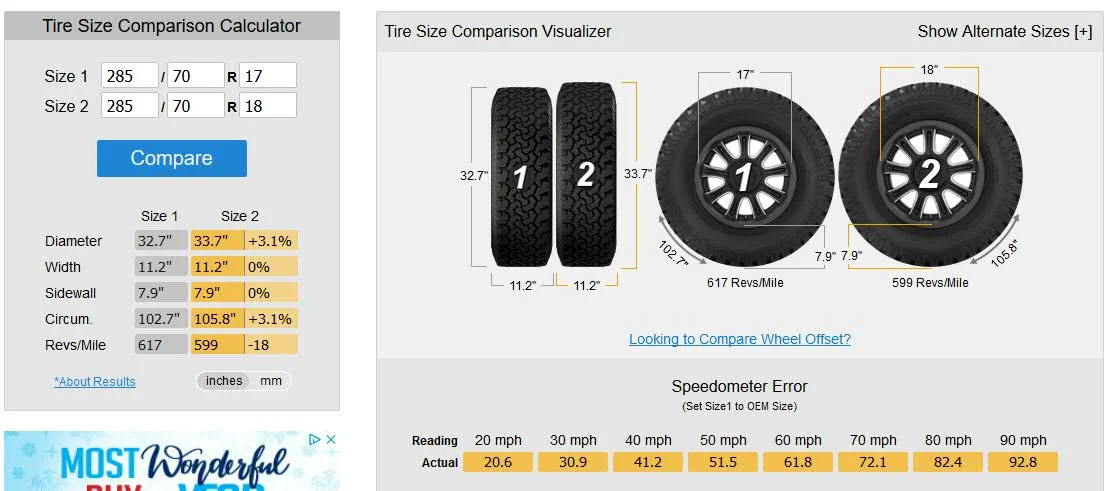

The particular size would be a 285/70/18 as mentioned earlier. If you want to make that a bit more aggressive, consider adding more width - 305/65/18.
Awesome feedback from everyone here which is greatly appreciated. Since I'm running 285/70/17 now and wanting to switch up to 18" Tundra wheels I think the best option I'm hearing for those is also a 34" or 285/70/18 or for more width 305/65/18 though I think I'll stick with the skinnier tire size. I'm thinking for tires:

I picked up these rims:
TRD Pro Wheels on 200 Series
I see Builds - Nitro Gear / Justdifferentials, Project 200 Series Land Cruiser
is running a 285/75/18. Is this because he is running aftermarker UCA/LCA's? I am running SPC uppers, but the tire shop (Discount Tire) I went to said the Tundra wheel with the 285/75/18 Nitto G2 and 1.25" spidertrax spacer still rubs against front swaybar and something else on driverside.
I added spidertrax 1.25 spacer and still I get rubbing with that combo.
How are others able to make this work and is what I'm doing worth the effort or just go down to a 275 tire with this rim/spacer combo or just get an aftermarket wheel with the right offset and if I do that, how much offset would I need?

are others running spacers with the stock Tundra TRD Pro rims? The ones I have say 60 inside so I'm guessing that is +60mm offset (2.3622 inches) but that is on a Tundra.
I've tried spidertrax 1.25" spacer with TRD Pro stock 18" rim at 60mm positive offset with a 295 70 18 and on driver side it barely rubs/catches on the swaybar.
A 285/75/17 or a 285/70/18 or the equivalent of 34" is what I'm planning to stay within.
275 70 18 i believe is the safest. No wheels spacers needed, stock wheels 60 offset
