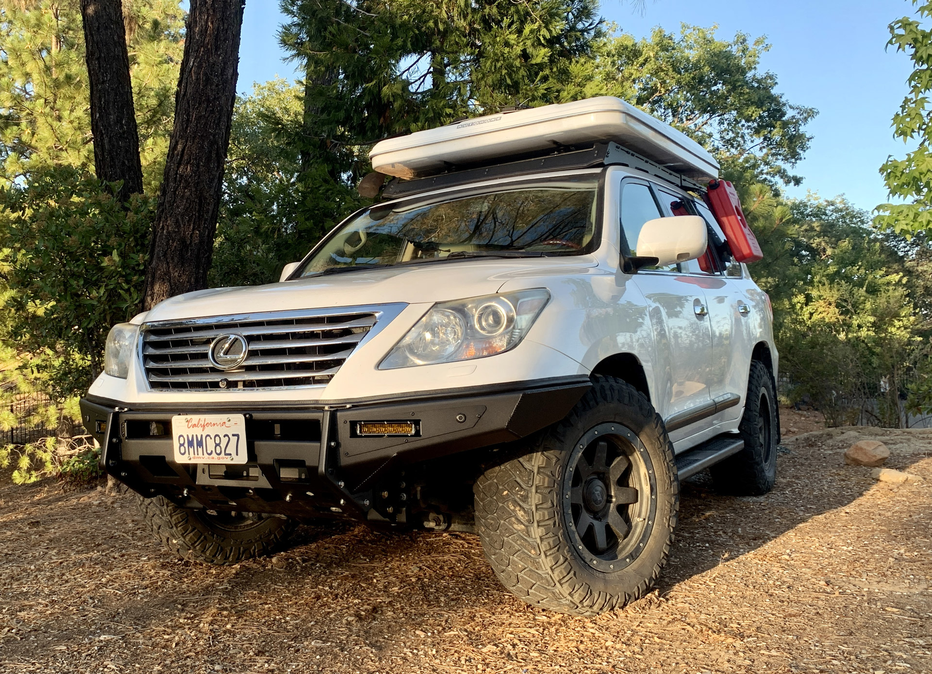

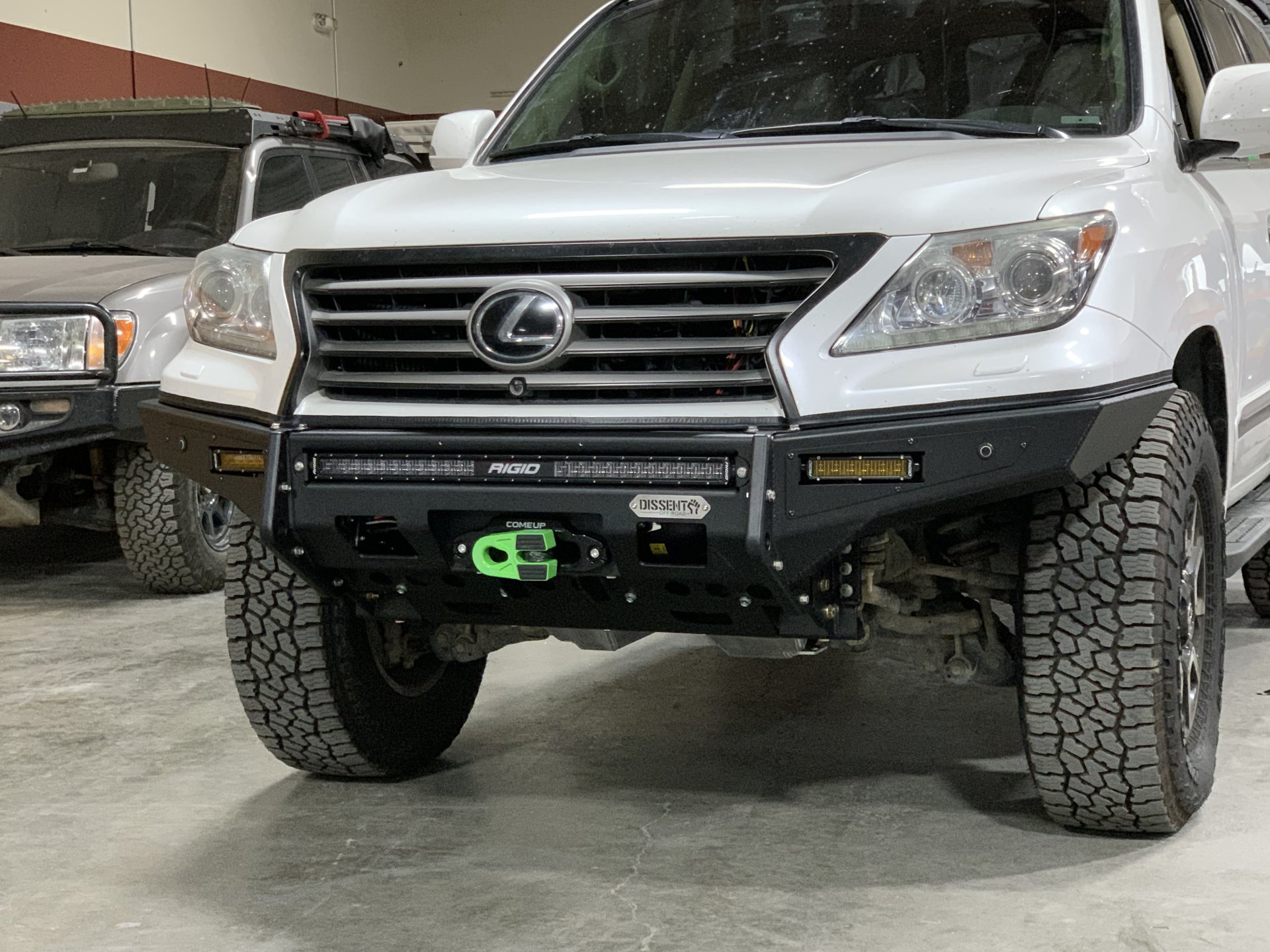

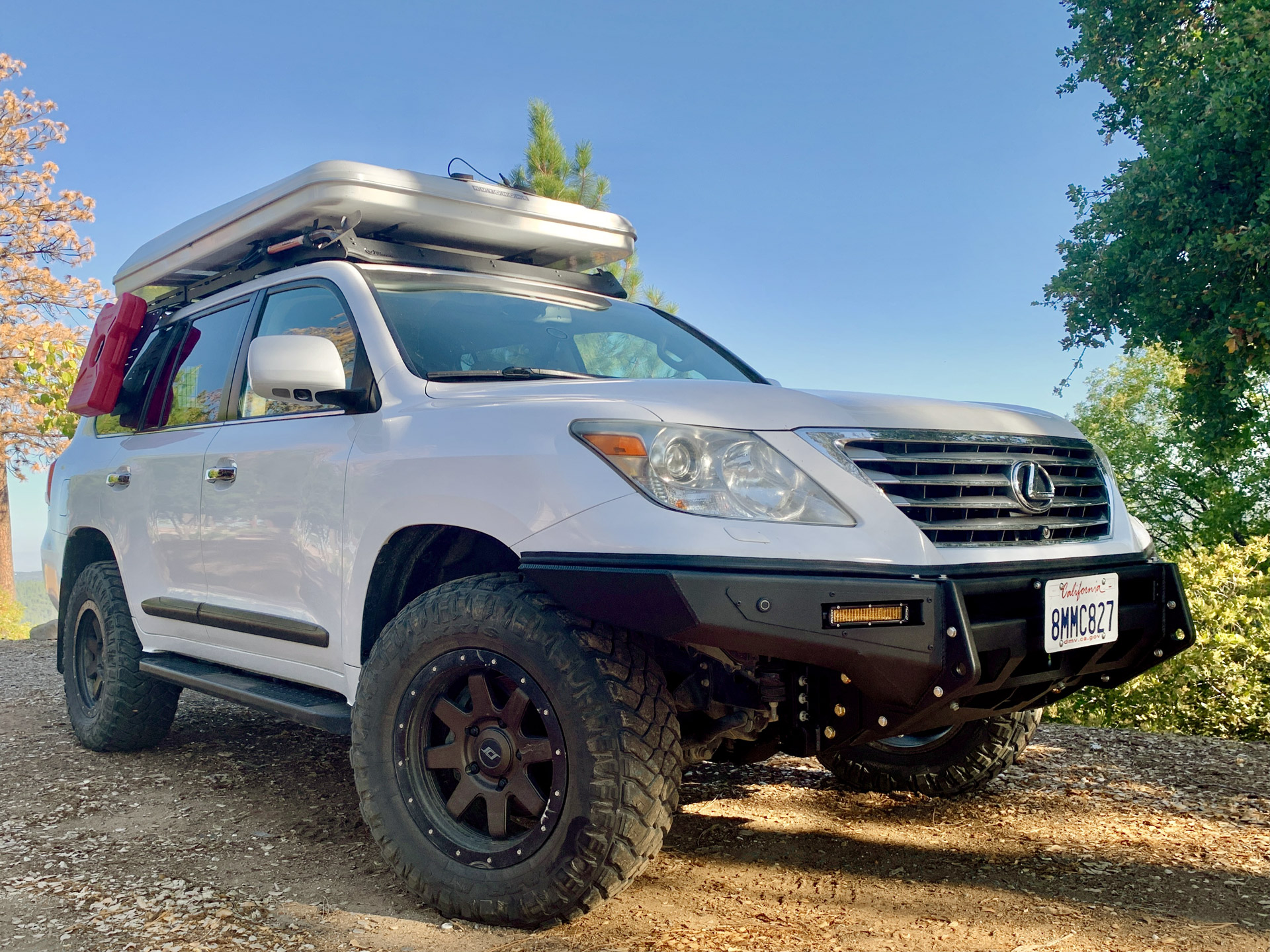

From a pure aesthetics standpoint, you're never going to beat a bumper that is specifically made for your model (vs a LC bumper made to fit).
Dissent's bumper is made of aluminum so it does carry a slightly higher price tag, but you get a properly strong bumper without the weight. Comes with a lightbar center section, yet it can still support a winch, several other aux lighting options are available integrated into the bumper.
Yeh seconds on fit and finish. Very cool looking!
I have a white '13 I want to get done.
Did you get it done at a a local 4x4 shop? Any tricky install issues?
Have you checked clearance and approach angle differences from stock?
How much does it weigh?

Full Disclosure, I work for Dissent, that LX in the photos is a customer vehicle.
The bumper is bolt-on and very doable by someone if you set aside a day and don't rush it. What usually intimidates people the most is cutting the factory plastic bumper cover (our bumper re-uses the very top portion of the factory cover to achieve a clean look). Taking your time and getting the appropriate tools you'll see it's not too bad and the supplied weatherstrip will completely hide any small deviations/mistakes in your cut.
It's an aluminum bumper (with steel frame brackets) so it's one of the lightest bumpers for the LX 570/LC200, we need to weigh it but our estimate is 65 lbs. The clearance and approach angle to stock cannot be compared, it's a night and day difference.
