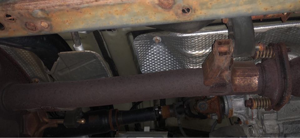

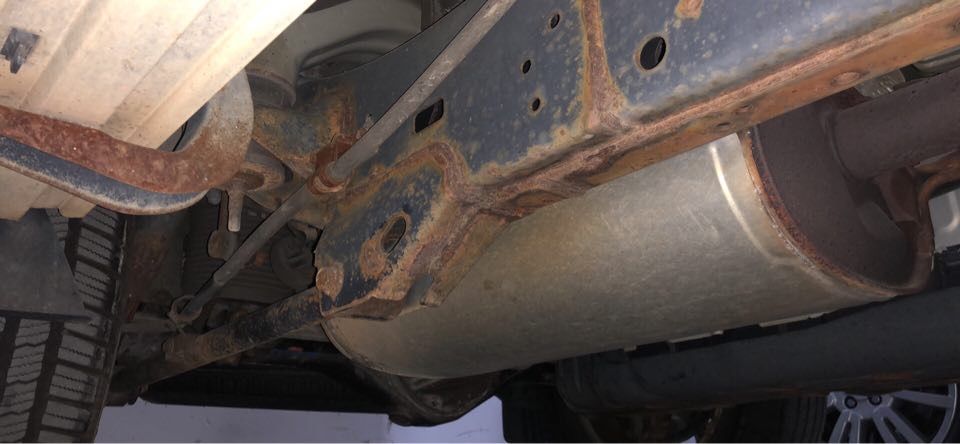

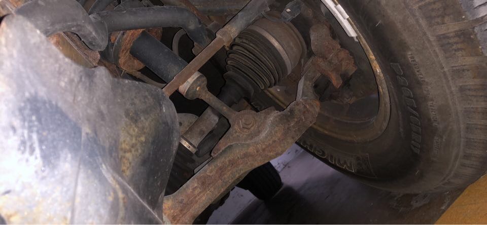

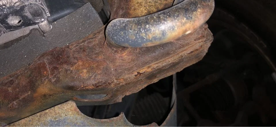

I am researching available GX 470's in Texas. One I came across seems to be a good candidate except that it spent half its life in NJ. It was a single owner and has an extensive service history with dealer service every 5k miles like clock work. The timing belt and water pump replaced right at 90k, etc. Price is 13.5k but I think I can get it down to the 12k range at least.
They claim it is a sport package with KDSS but the markers such as black wood do not seem to be there. So that leaves me with 2 questions from the pictures below:
1. Should the level of rust in the pictures below keep me from purchasing
2. Can you tell if the KDSS is present just from the pictures
Obviously, being in Texas there are other options out there that did not see such harsh winters, and I want to know if this one is worth the trouble. Thanks.
5 Images attached full album below:
Jan 17, 2005
5,471
Southern Colorado
It's not destroyed, but there are gobs of rust-free ones out there. I just bought an all-TX-driven 2006 here in Colorado that is super clean underneath.
I would pass on this, as every fastener for everything underneath will require a torch or cursing to get off. I had the top of a Toyota Highlander fuel tank rust out (truck was in NY/OH for 6 years) - so sometimes the things you cannot see are just as bad as what you can see.
The 1-owner and service history are admirable, but there are others out there about as nice (in that regard) without the rust.

Mar 9, 2020
132
NYC
Doesn't look horrible at all, no holes rusted through, if you get it for a good price and it's been maintained well. Wire wheel it, slap on some rust treatment and enjoy.
Jul 6, 2017
549
Charlotte, NC
Brother (edit: or sister), you are in TX which is not a big rust state. Keep looking... That one isn't bad as far as the upper east coast is concerned but you are in an area that will have better options. If you lived in NJ, NY, MA, etc. the it would be worth considering.
