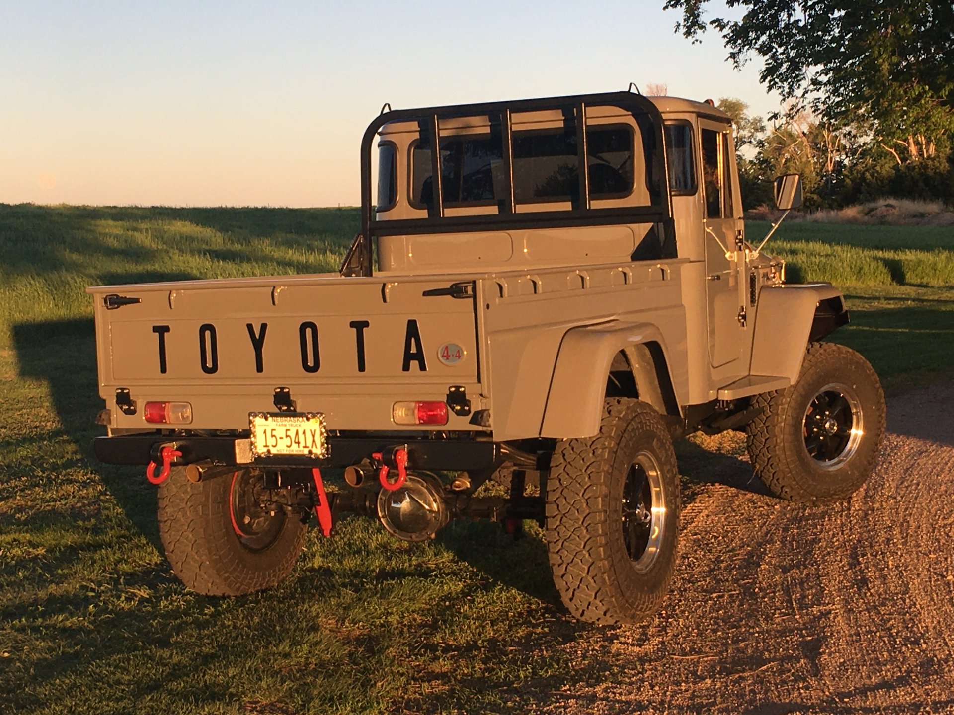

We’re having a problem with the computer maintaining a memory when the battery is disconnected on my modified FJ-45 Landcruiser. The chassis / engine / trany is all Chevy.
(1500 4X4) When it comes to the computer ... I am brain dead. Does the computer have any kind of internal backup system that’ll hold a memory for an allotted amount of time ? Any help here is appreciated....
