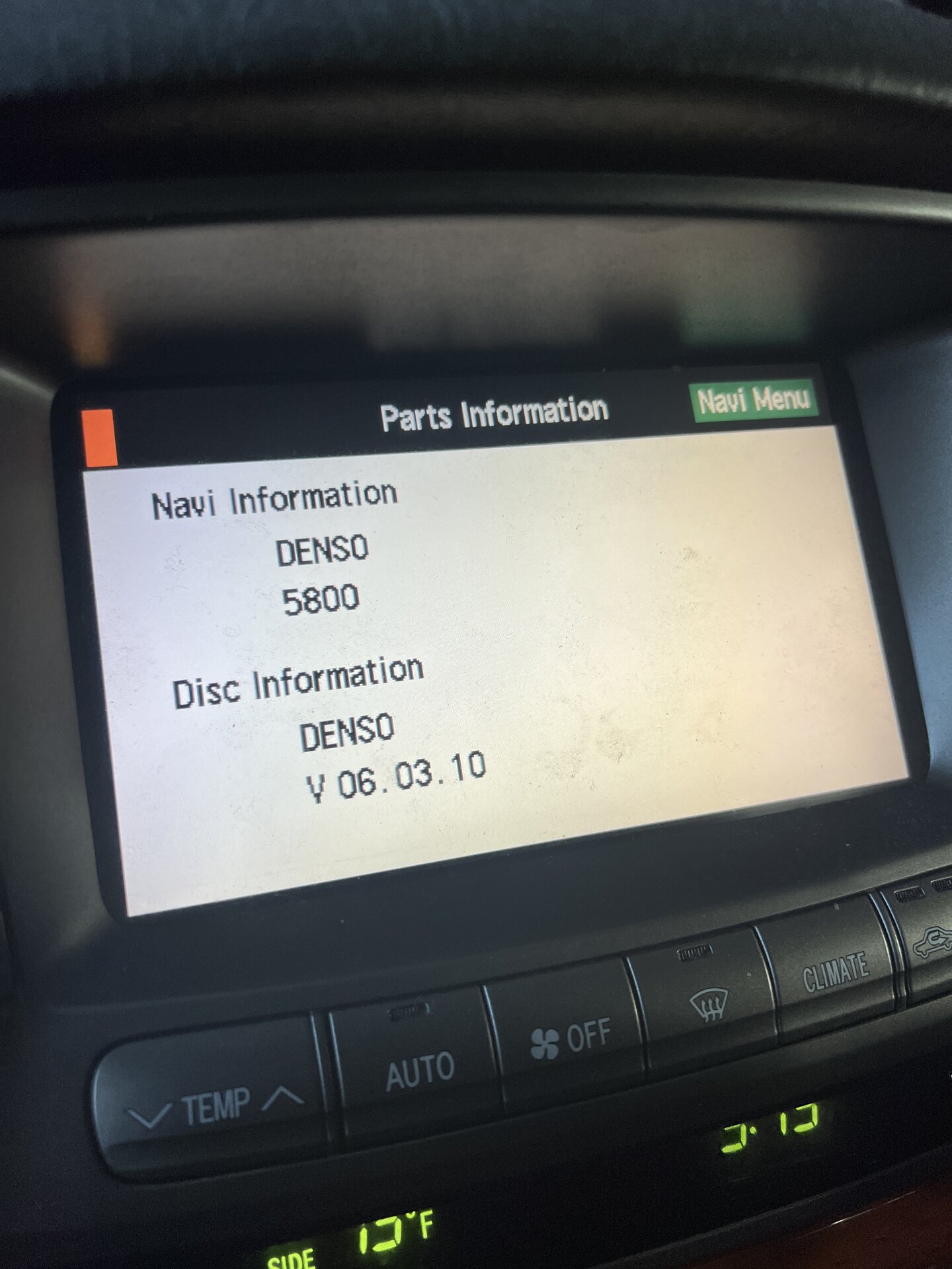

Can you hop into the secret menu and check the Navi Info and Disc Info? (Mine attached)
Process:
1. Turn headlamp switch to off
2. Turn ignition to Run
3. Hold Info
4. Cycle park lamps on 3 times (Off > Lamp : Off > Lamp : Off > Lamp)
Process:
3. Hold Info
Hi but after open the secret menu there is something to do to change the dating simply using the menu or I must find an upgrade by disk or use the toyota techstream? in my country everytime goes into Toyota is an drama history thank you for help

I followed your instructions but I wasn't able to do anything, if you can explain to me how it's possible because not even Toyota /Lexus Officine knows anything.
I do this and appeares this on my screen
