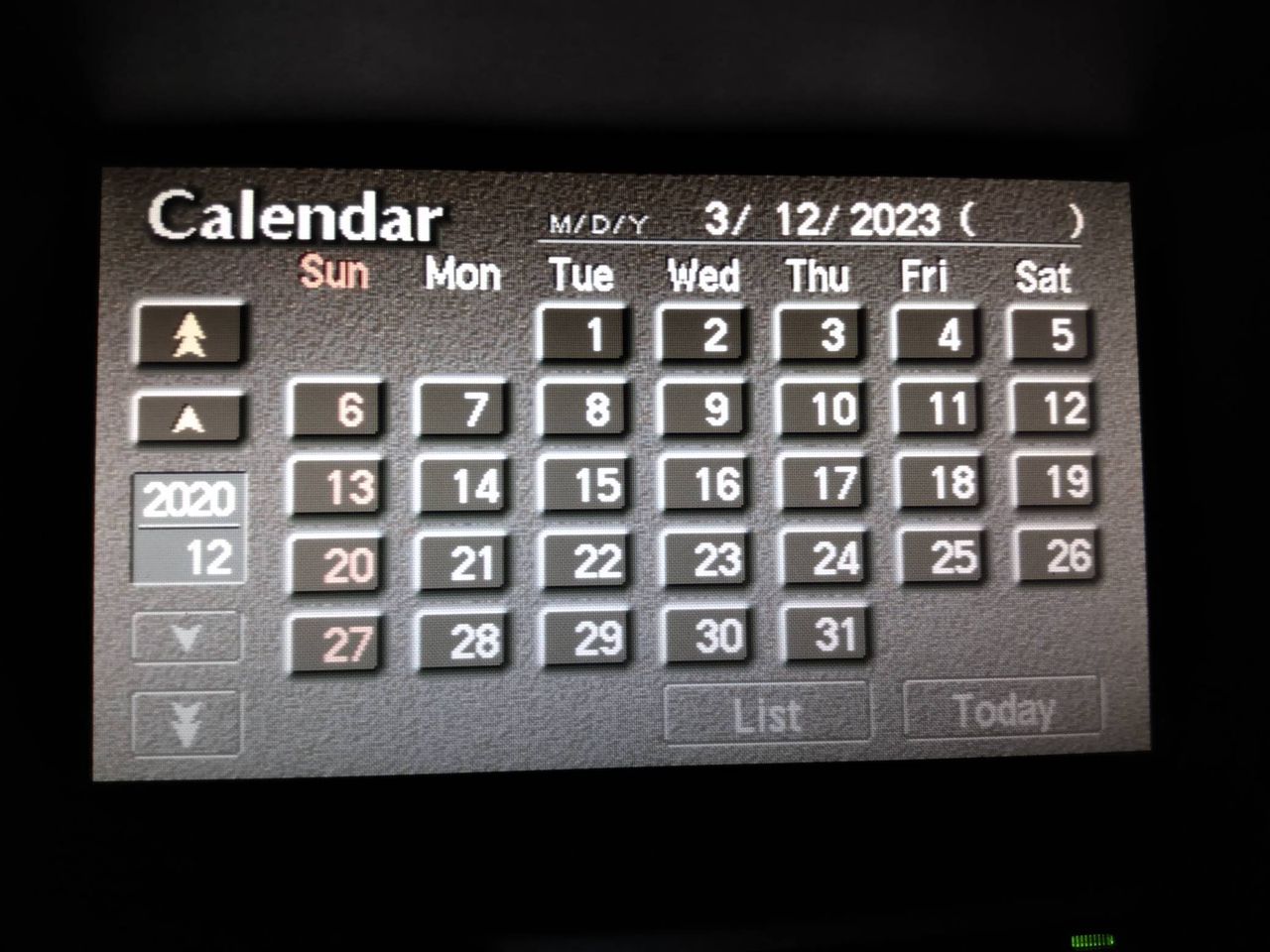

It won't let you set a service date that is older than today's date.
We are beyond the ability of the unit to add anything. As far as I can tell there is no way to change today's date to current (that I'm aware of) on the nav unit or to roll it back to a year in the past.
When Calendar option is selected on the menu, today is NOT circled in yellow as it normally would be because the unit does not understand anything beyond Dec 31, 2022.
So what you said is 100% accurate but it also won't allow you to set a service date for an hour from now much less a week or a month. :hmm:

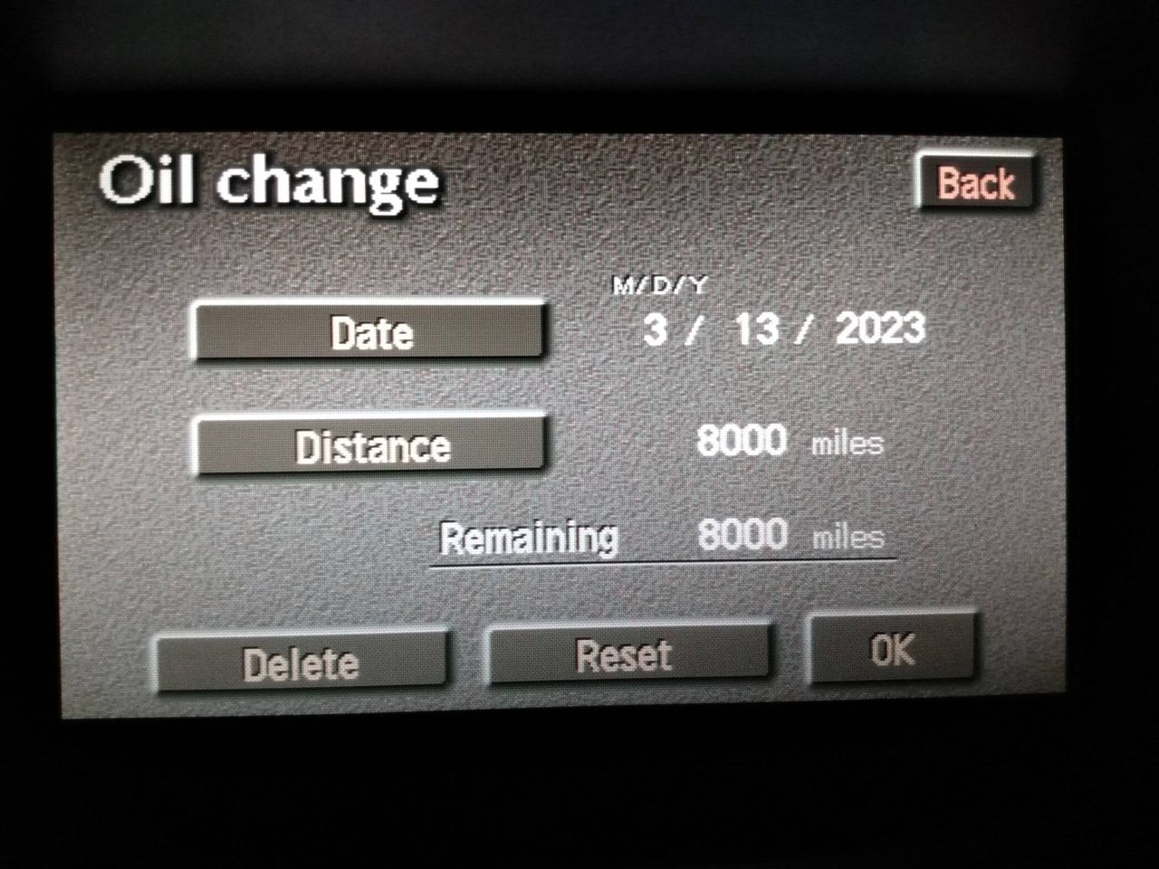

Cruiser God must like me!
May 31, 2003
9,592
Anything particularly special about your cruise? Mine is a 2006 LX and it won't even let me update the date.
2003 LX470. Nothing special that I know off. Not sure if this is related, previous owner subscribed to Lexus Link system before but it has been discontinued for a long time. I still have the antenna for that on the roof.

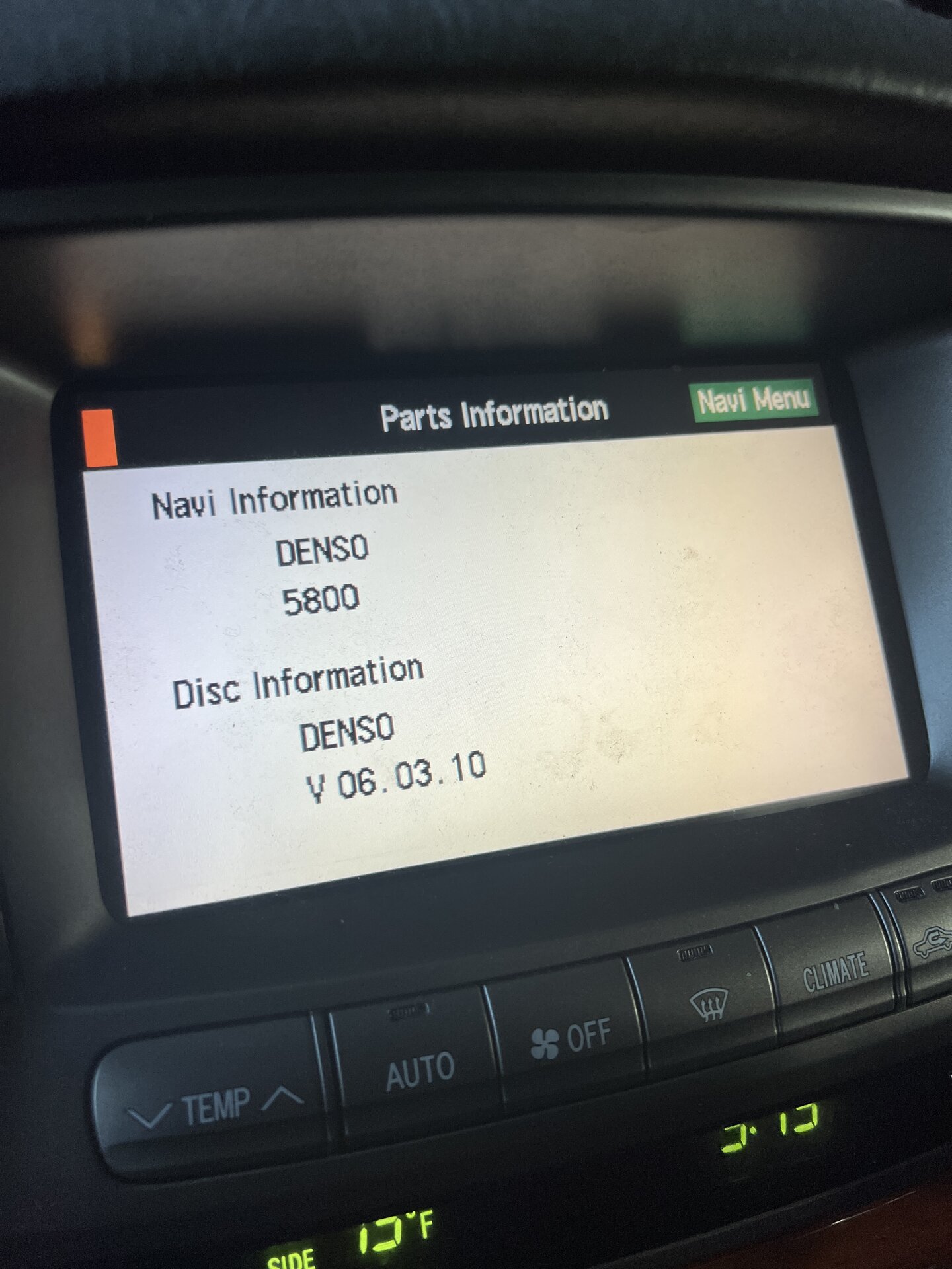

Can you hop into the secret menu and check the Navi Info and Disc Info? (Mine attached)
Process:
1. Turn headlamp switch to off
2. Turn ignition to Run
3. Hold Info
4. Cycle park lamps on 3 times (Off > Lamp : Off > Lamp : Off > Lamp)
