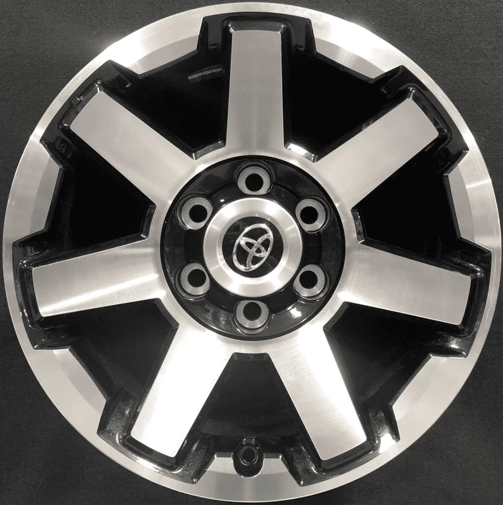

2019 stock 4Runner and Tacoma 17" wheels require spacers on the front Sport and Limited larger brake calipers. Fact. I literally have them on my 08 sport edition right now. I installed them last weekend and couldn't figure out why they were touching until I found out the backspacing is different.
The 17x7.5" wheel has a different offset.
I'm seeing he is going for TRD wheels. Are those different that what comes on the 4runners stock right now?
These don't fit:
