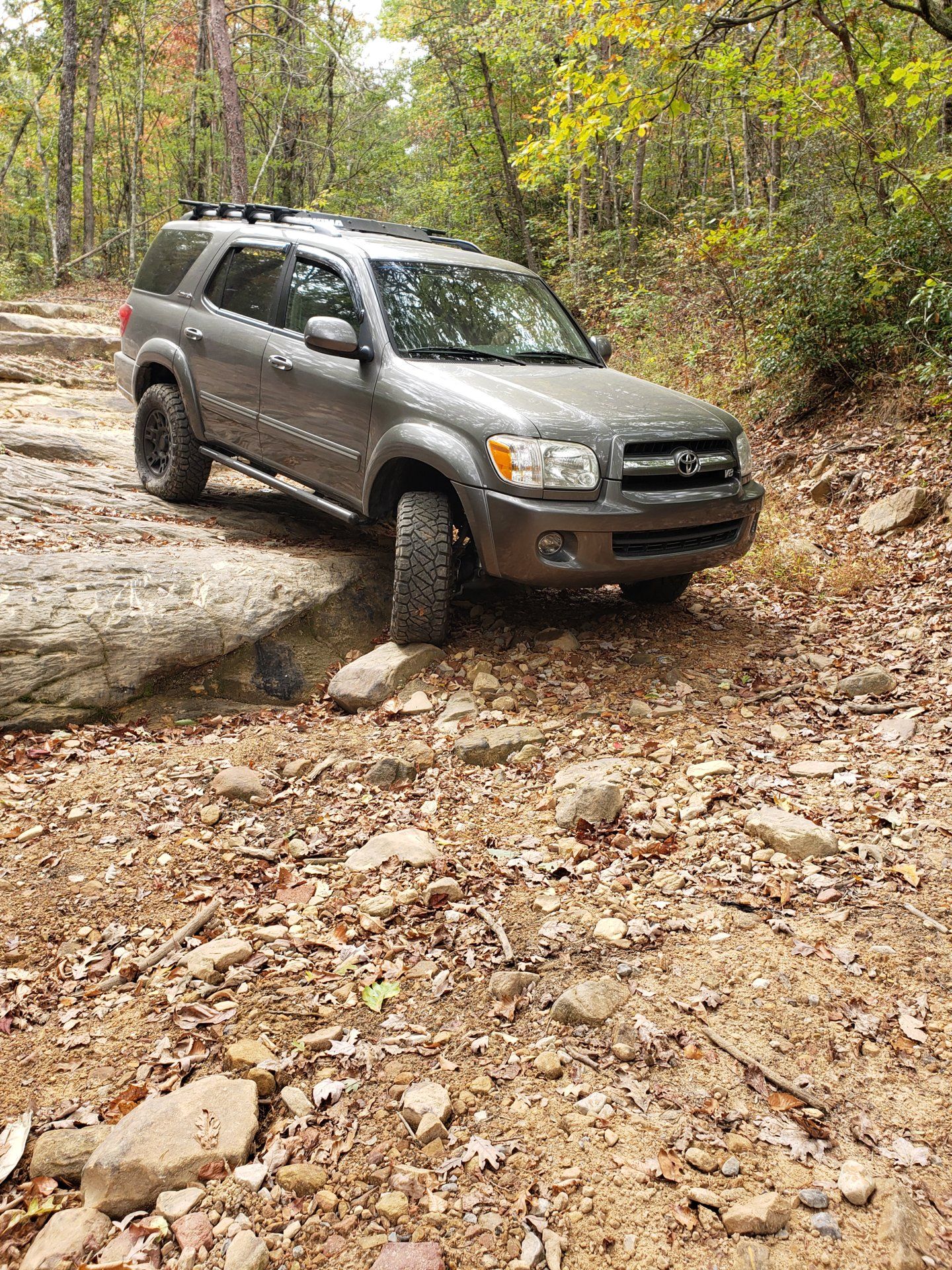

@Jgrauman What are you running for a roof rack? Love your build man 👍
Thanks man! It's been a fun one. Just Yakima rail Grabbers on the factory rack 2-58 inch bars on the outside and 2-48 inch bars on the inside. Running the longer bars on the outside so my bike racks fit
Thanks - couldn't tell if you had something custom going on inside of the factory rails. I've been researching custom racks for a while so always keeping an eye out. Roll on!
