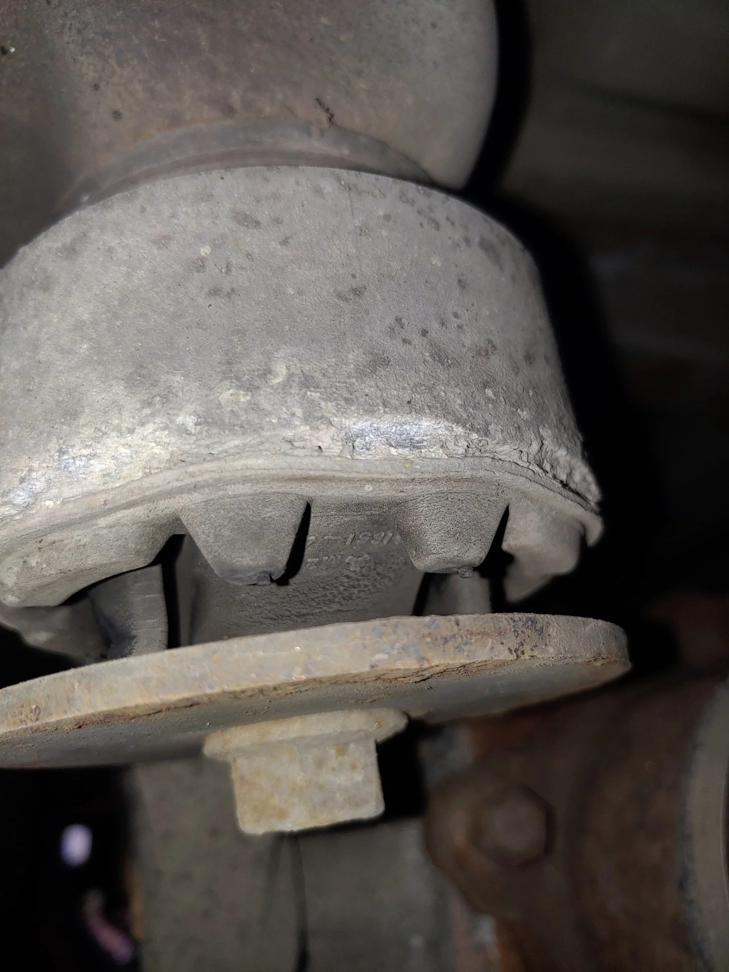

-Front right sway bar bushing is torn

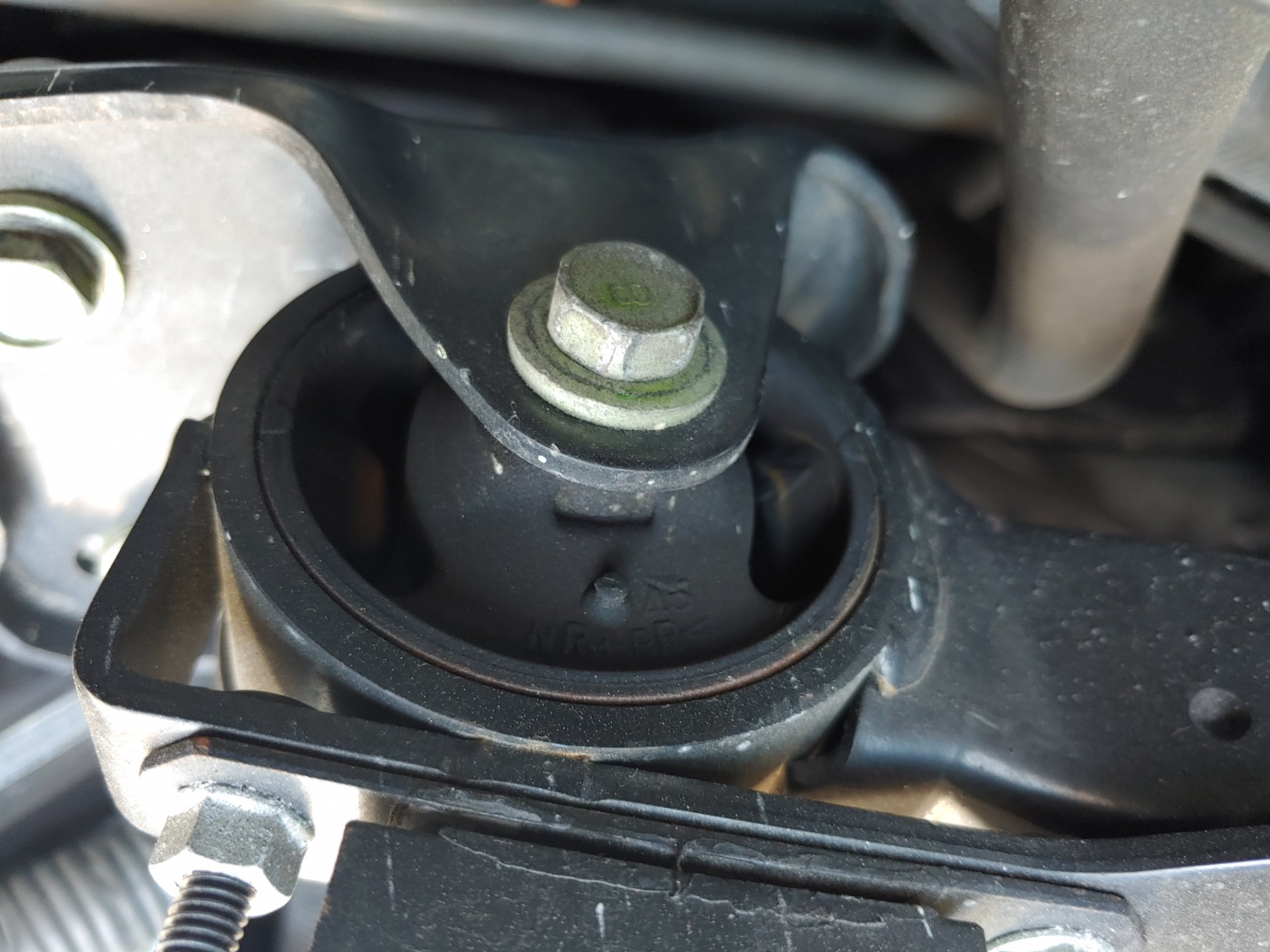

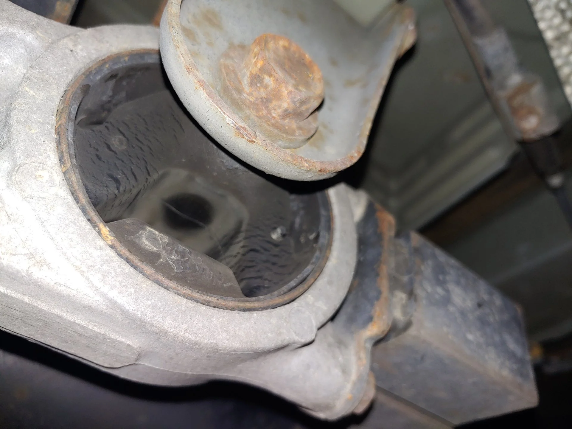

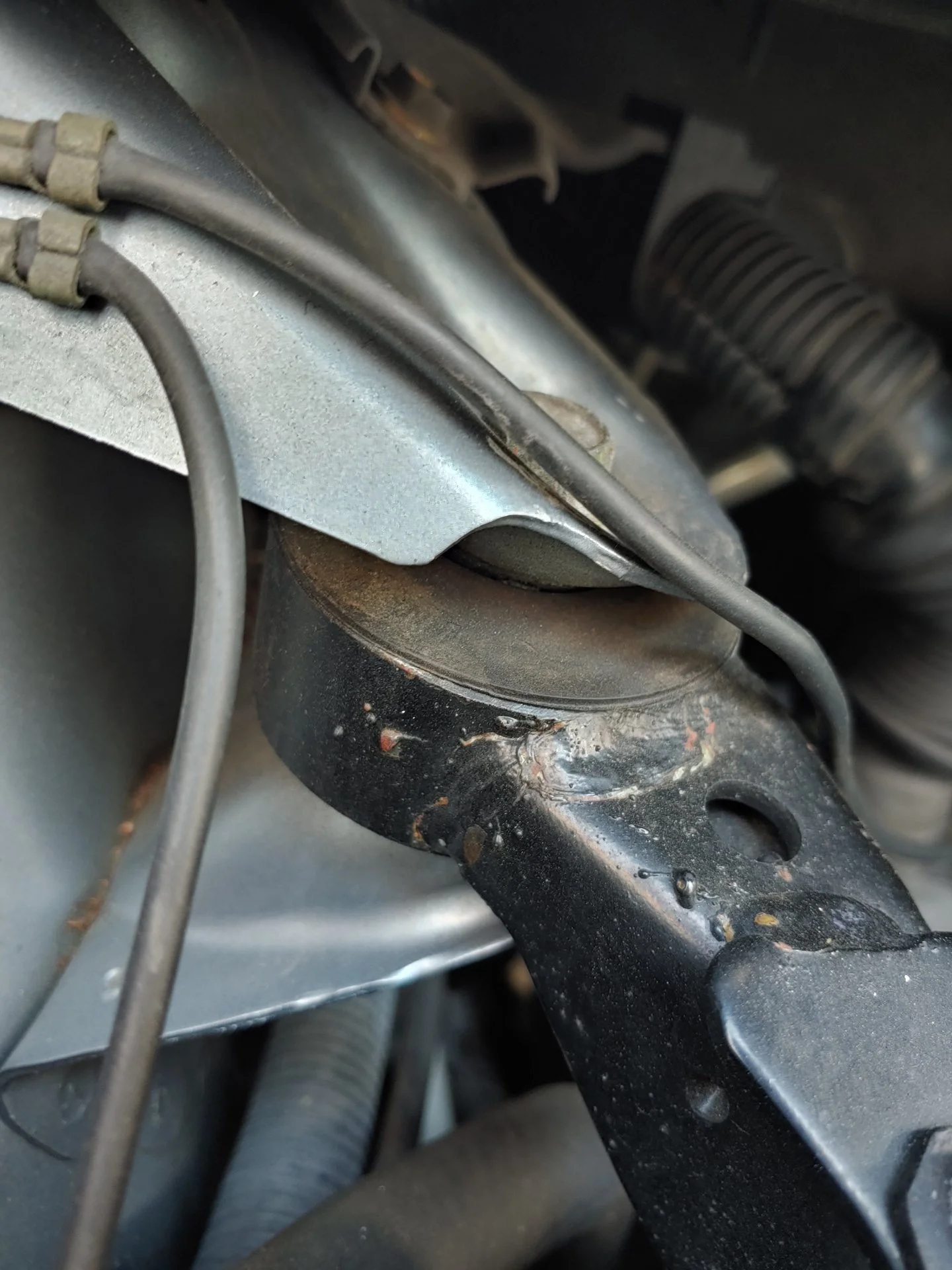

Rear Differential Mounts
Left - photo 1
Right - photo 2
Front - photo 3

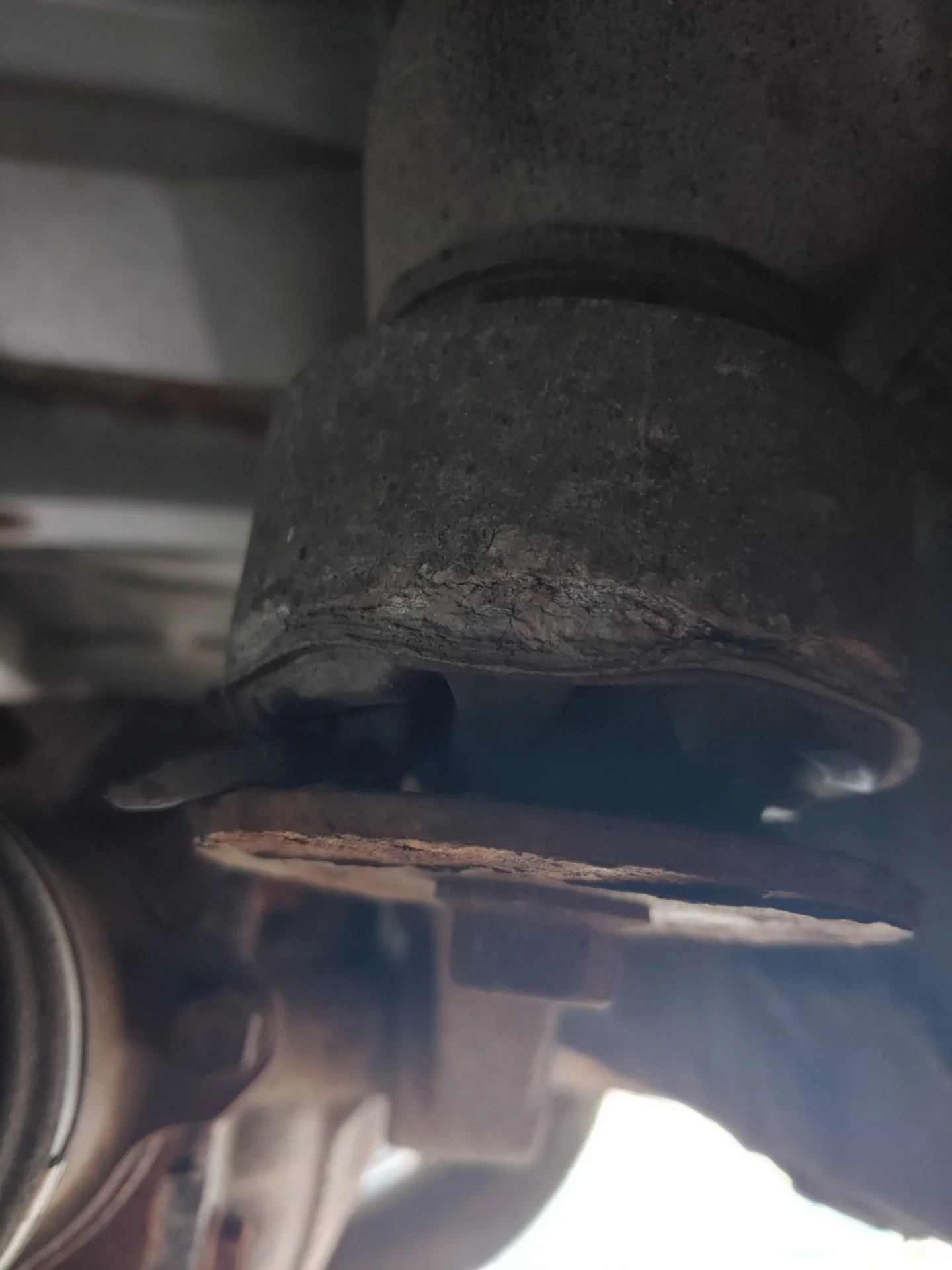

Cracked sway bar bushing - photo 4

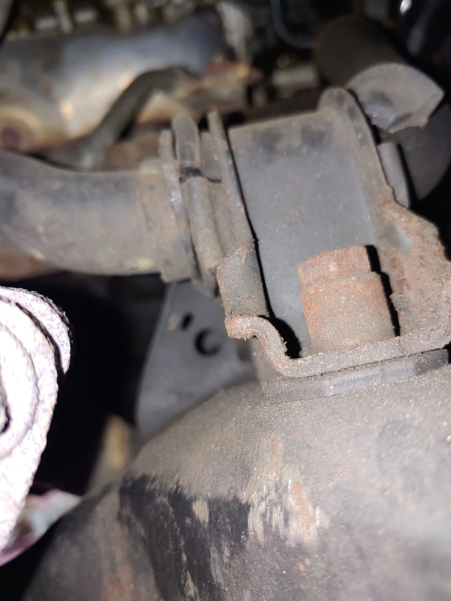

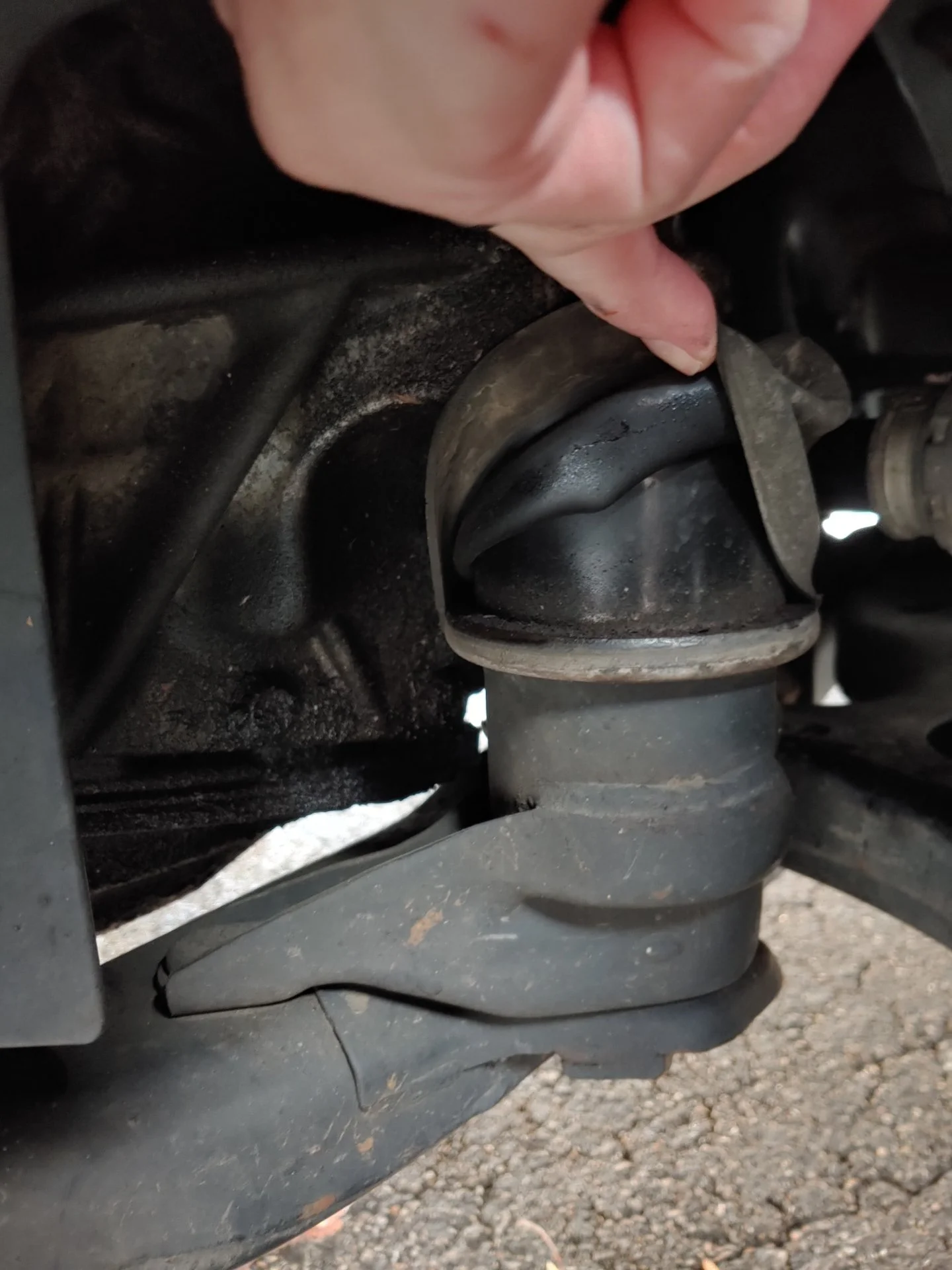

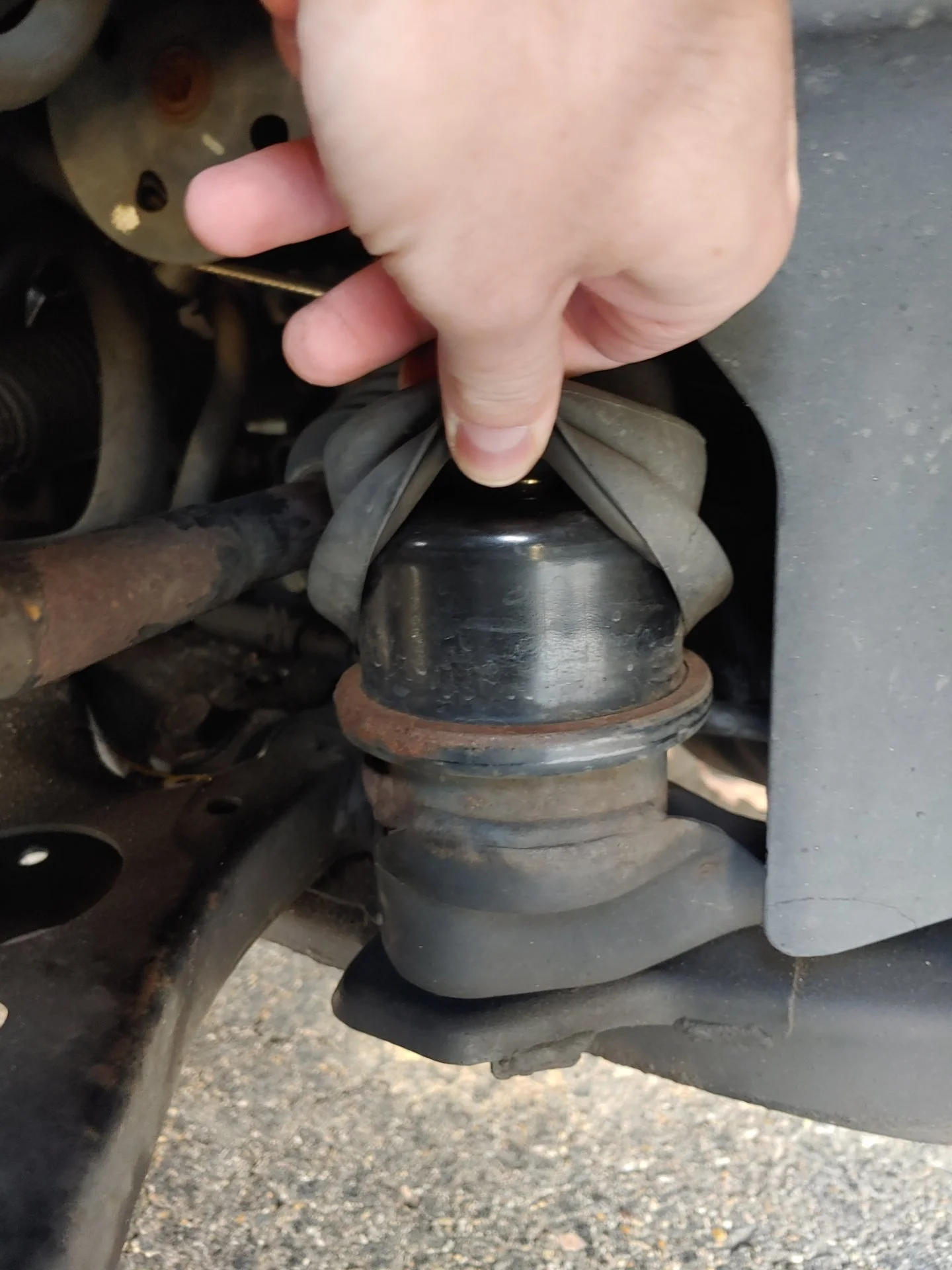

Front Motor Mounts
Front Left - photo 5
Front Right - photo 6
Front Center - photo 7
Top - photo 8/9
Rear - photo 10
Right now I'm thinking it's probably the cv joints although the rear differential front most bushing could also use some changing it looks like the rear diff is hanging a little low due to that worn bushing...???
Unfortunately there is no change with new cv axles. I guess I'll do the differential bushing since it is obviously bad. Maybe do the top wishbone and front center motor mount since those seem to move the most when observing the motor when shifting from p-d-r etc...
