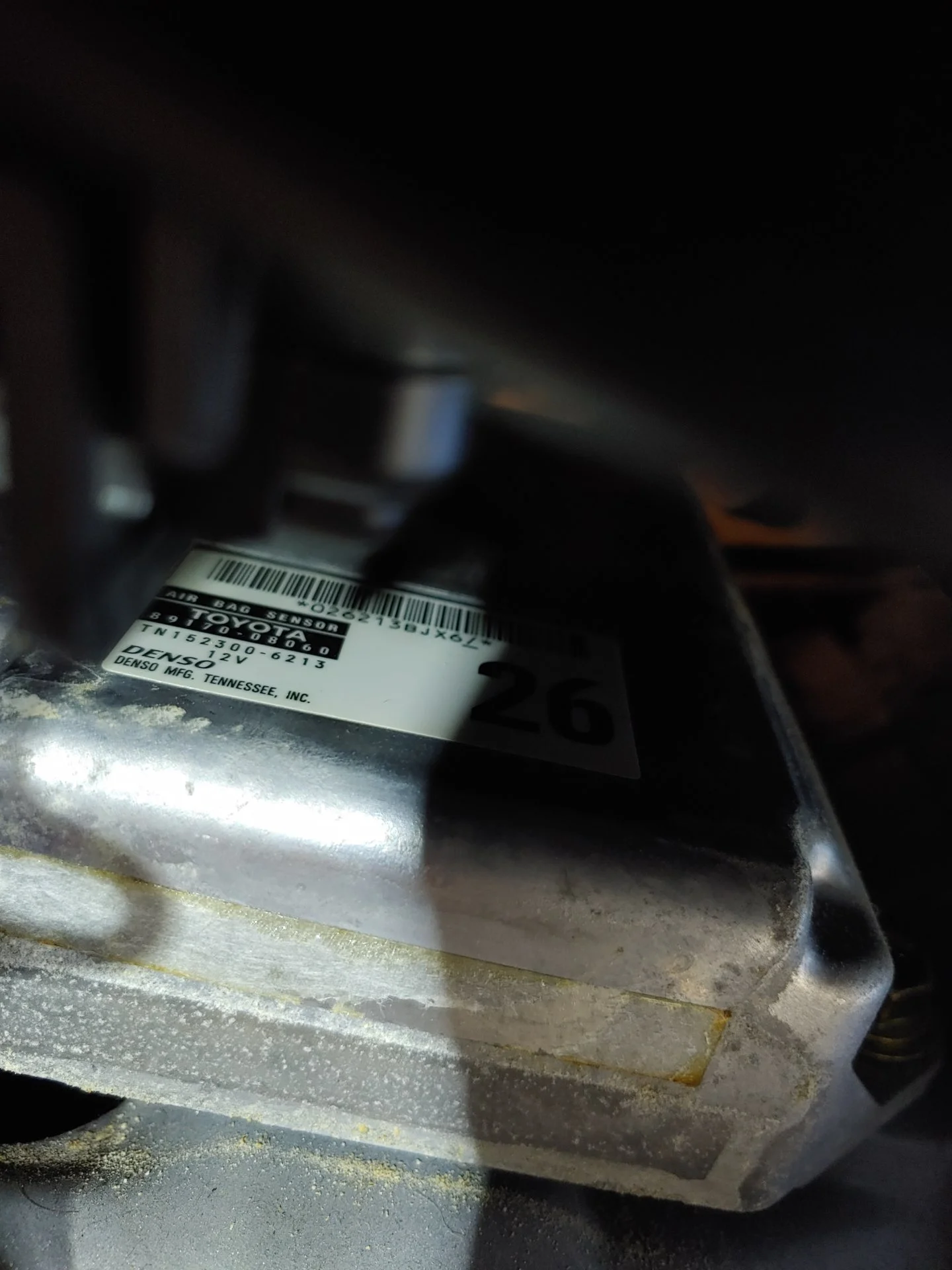

One thinf I'm trying to understand at the moment is it seems they used the same ecu 89170-08060 for models with and without side curtain airbags. Is there internal programming that makes them different or will a unit from a car without curtain airbags work just the same since the part number is the same?

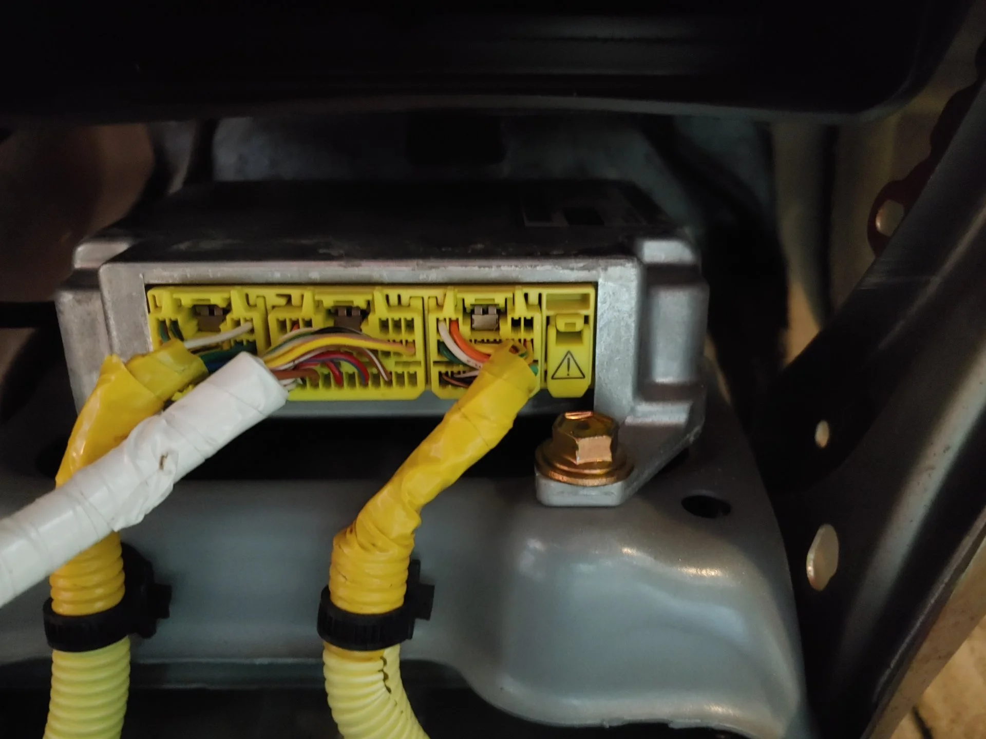

Here is a photo of the ecu if that matters.

Basically if the wiring is solid, you need the ecu. Always a pita to diag. Sounds like yours comes and goes.
Pull it and open it up see if it looks funky or smells like majik smoke.

I tried the diagnostic tests measuring resistance for the spiral cable and instrument panel wire and got 0 for both. Not sure I am doing it right... anyway I ordered an airbag ecu with matching part number from a junkyard 2004 Sienna without air bag deployment and with curtain airbags. Looks like I am going to have to put 1300 miles on my 100 series carting the family cross country for Christmas after all... bummer... hopefully this fixes it
