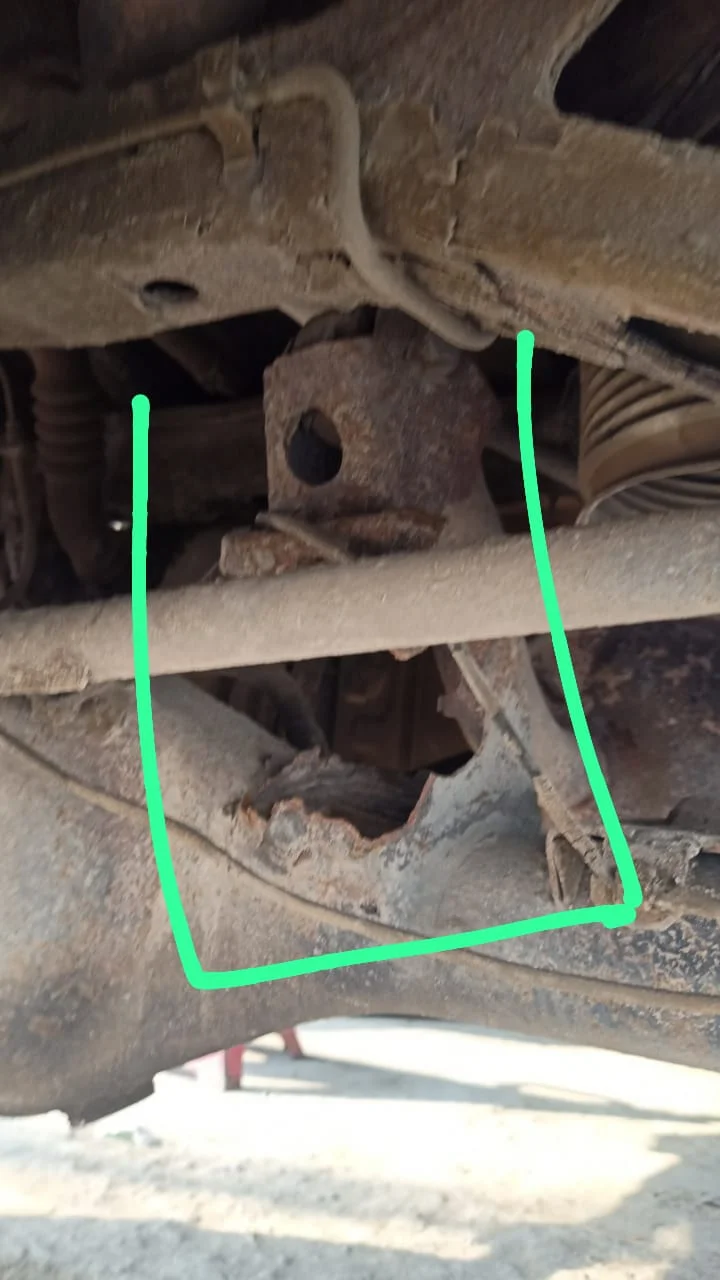

The main issue is that the main bracket for the rear axle snapped, placing excessive load on the rear air suspension which, in turn, broke. The car is undriveable - it sits at an angle/very low ride height, severely bounces/vibrates and clunks, and the handbrake, ABS, and VSC lights are permanently on. The mechanic is recommending a full replacement of the rear axle (whole assembly), and replacement of the rear air suspension + related parts. Some sensors/wiring will also need to be fixed. The axle would be from a salvage yard, and the rear suspension parts all new. I did test him on if a weld repair would be sufficient; in his view, the rusting (the cause of the original breakage) is too significant that he would not have confidence in a repair holding.

Thanks for your response. If it helps, this is the picture he sent.
I think the price is reasonable, but the frame above looks to be very rotted as well. If the rest of the frame is in similar shape, I would have concerns about putting money into the vehicle, as the frame damage can be very difficult to repair and may compromise the structural integrity of the vehicle.
Yeah… that’s a lot of rusty cancer in the frame. That bracket that broke is pretty thick steel to begin with and rusting enough to snap would make me worried about the rest especially if this is gonna be used in rough conditions going forward.
This might be a fix, sell, and buy something better scenario if you need 18 hopefully trouble free months out of it.
