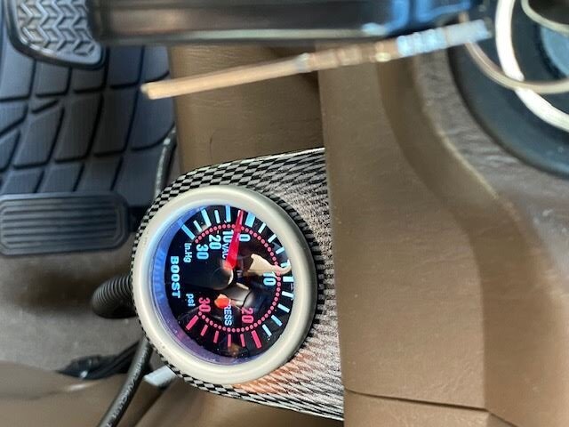

Dear Sequoia Forum,
I installed this Boost gauge under the key ring slot of my 2003 Toyota Sequoia SR5. See photo.

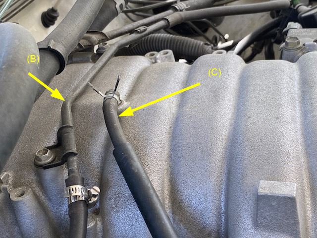

However I'm having an issue where I connected the 1/4 in rubber hose to what I thought was a vacuum line but there's not enough pressure.

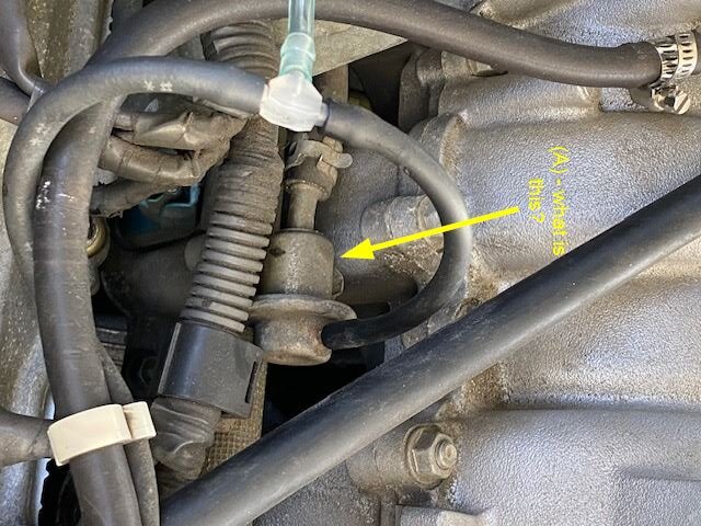

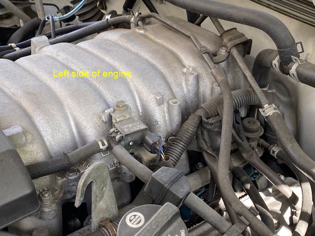

In the attached photos, I've labeled the various lines - can someone tell me which one of these is the correct one to hook up to?

@algtrader The first picture A is a fuel pressure damper/regulator.
The others look like part of the evap system.

If you're going for a vacuum gauge that makes more sense and any line of proper size coming directly off of the intake manifold should suffice. Just make sure whichever line you chose, that it doesn't go to the brake booster.

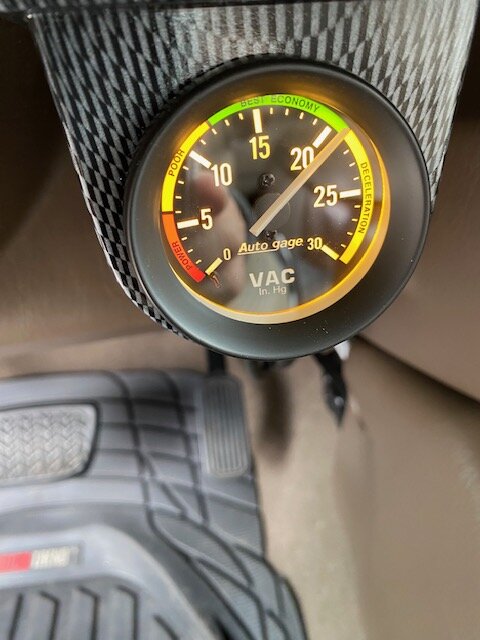

Replaced the vacuum/boost gauge with a Vacuum only gauge. See photo. From this forum, I got comments that the combo vacuum/boost gauge didn't make sense since I didn't really have a turbo on my vehicle. I just planned to read the gauge and use it as a fuel economy indicator. Through this forum, I got help on where to 'T' off the vacuum hose at the intake manifold. Thanks guys!
