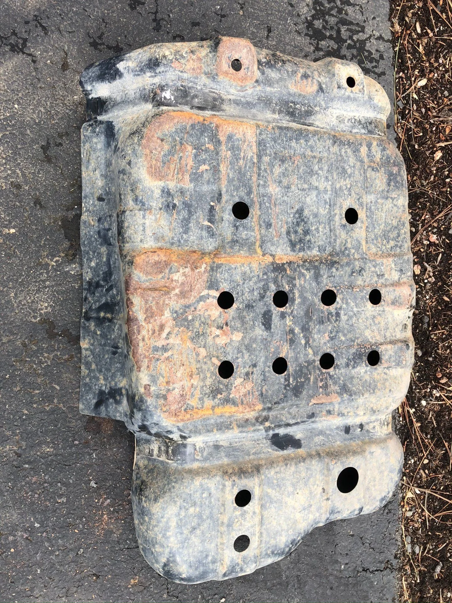

Update: I've gone ahead and ordered a used one off eBay. To me, this looks the same as what I have, and after cleanup and some underbody coating should look as good as new, right?
1998 1999 2000 2001 2002 TOYOTA LAND CRUISER GAS FUEL TANK SKID PLATE SHIELD | eBay
The skid has the same part number in 2000 and 2003, so that's the right one.

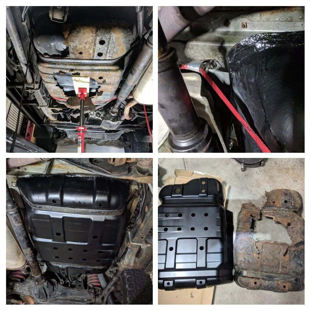

If you are replacing the straps note the pins may have become corroded and will be very difficult to remove. I ran into this recently replacing the skid and the rearward strap. I was able to get the cotter pin out but the actual big pin holding the tank up was frozen solid in the strap. Of course I probably have the most rusty LC known to man so take that into consideration.
I ended up onbolting the rear strap which was tricky due to the bolt location and the previous mentioned rust. Bolt sits about 1.5" above frame rail meaning I could only get an open ended box wrench on the 14mm bolt. Took several heat cycles with a torch to get that bolt unfrozen. Was more difficult than the other bolts on the other side but was doable. All the other bolts have excellent access, even with drive shaft in place (some remove driveshaft but it's doable without removing anything).
One other thing to note, my actual gas tank had rust on it as well so I had to treat that with rust converter and Por15 before putting the skid back on.
Good luck, it's a fun little project!!

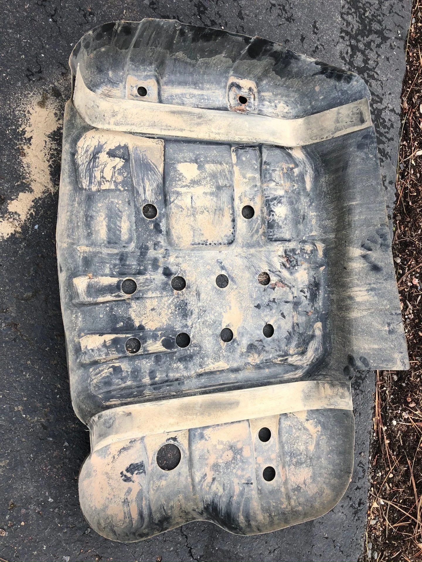

I dented my OME fuel tank skid plate, I think at Slick Rock. I ordered an OEM replacement and had it installed. When I told my son he said "Why didn't you just drop it, bang out the dent and replace it? Why do you need a new one?" Well by the time I talked to him I had the replacement plate in hand. He was right, my rig spent its whole life near Santa Cruz, CA. Has little rust and few dents until I bought it and took it off road. The new OEM plate was about $300 plus $90 shipping. I kept the original plate, pounded out most of the dent and now it's ready for a good home. Only superficial rust, I purposely didn't paint it so you could see how it came off the truck. I should have followed my son's advice. Oh well. If anyone wants it, $75 plus shipping, probably about $90 dollars. If you're close to Bend OR you can pick it up.

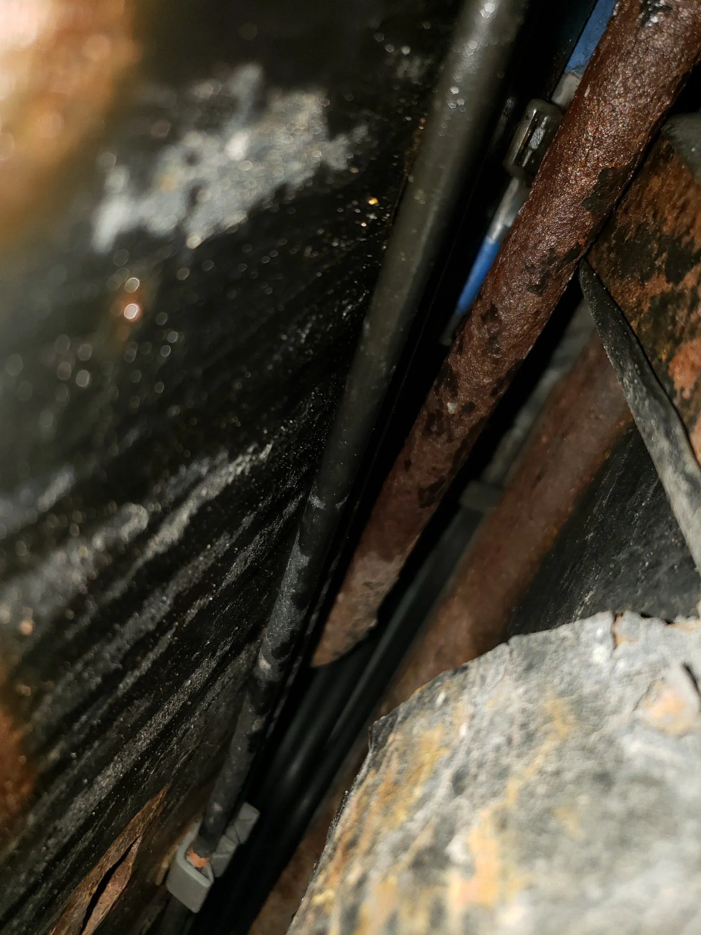

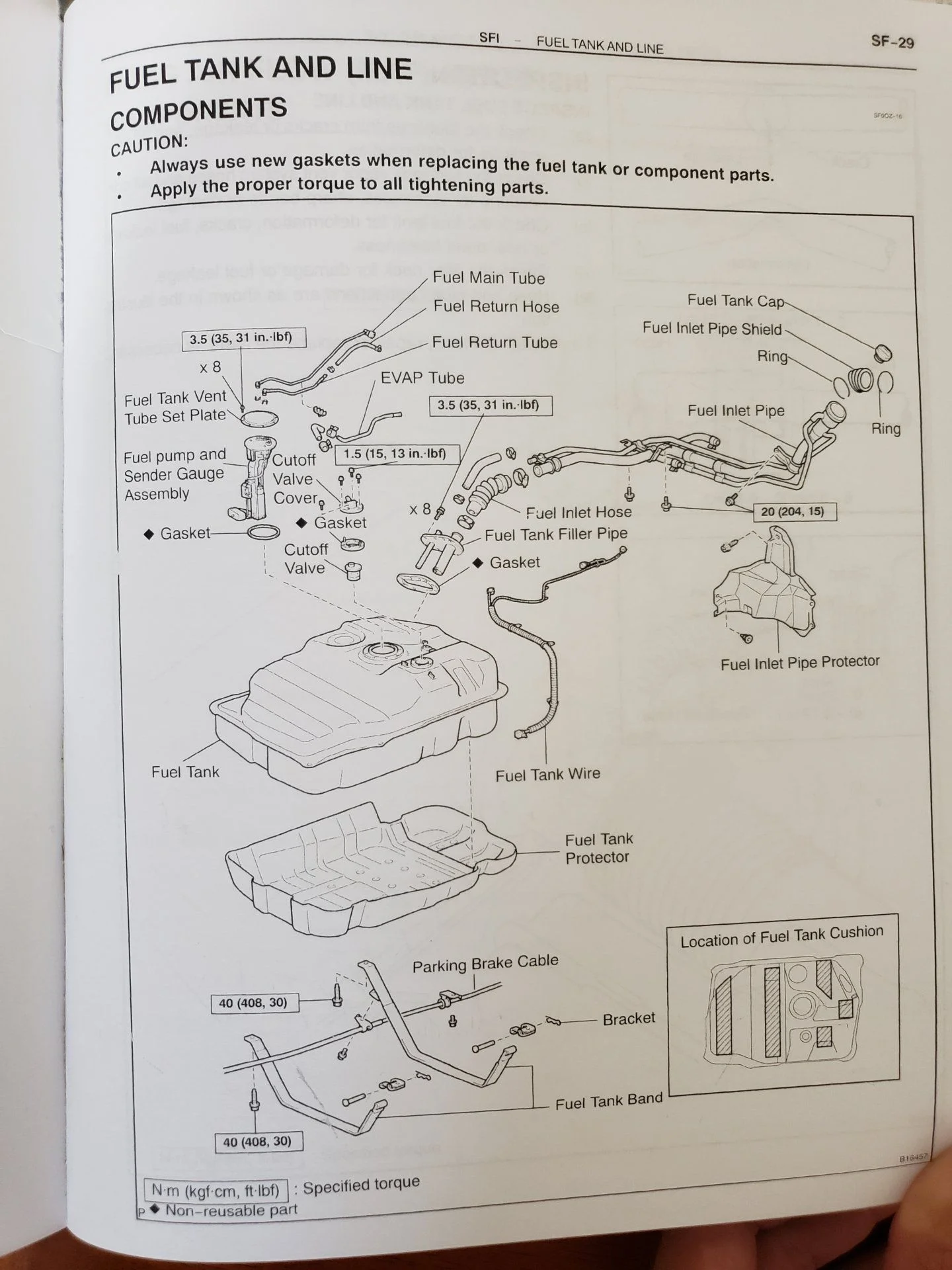

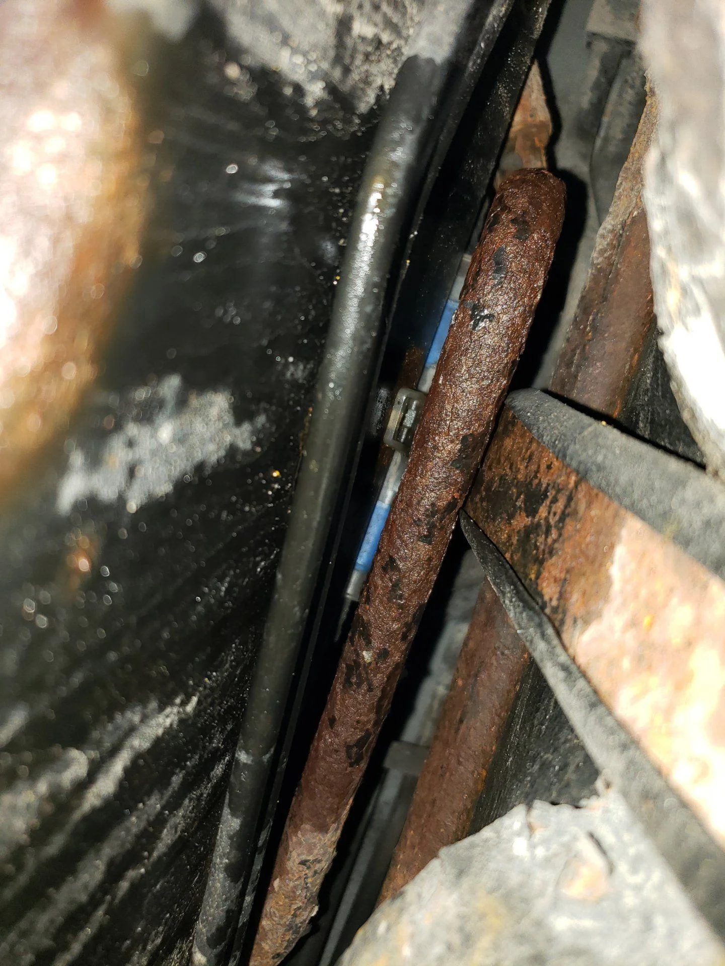

I have a question for you about that drivers side rear strap pin location. What is this in the way of the cotter pin - the parking brake cable? Or one of the AHC lines? I can't trace down what it is and can't figure out how to get it out of the way to even get to the rusty pin 😅 It turns to route over the frame rail just in front of this position (see second pic).
Thanks for any help you can give 👍
Dang.. it is an AHC line 🙄 I thought the it looked backwards from the diagram to be parking brake cable.
Well this sucks. At this point I think I'll just wait till I remove AHC cuz with how rusty everything is that's going to be a giant PITA to either attempt to work around it, or remove that line temporarily. I'll ask my shop how much for them to do it, but I don't think it's bad enough that it's an emergency to have to shell out for the labor, or even risk that AHC line prematurely.
