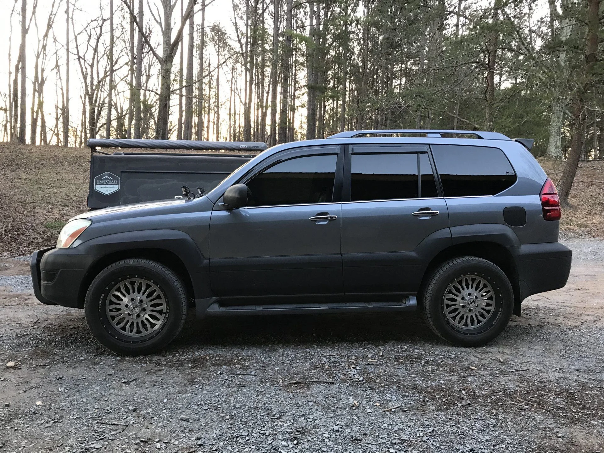

Howdy friends,
Just got this beast and would love some support and tech advice.
Known issues: valve cover gasket needs to be replaced
Power steering hose leak.
I’ve also noticed some squeaks on the back shocks, which I plan on changing out soon for kings. But I also plan on keeping the AHC system.
As you can tell the wheels are going back to stock (found some stocks on marketplace for 200. That will do for now).
I wanna get get steel bumper to replace the bull guard and current bumper lol
Also I plan on trimming the back bumper and replacing the running boards for rock sliders
For the rest I plan on following Dirtdawg’s proceedure for the coils and sensor lift
