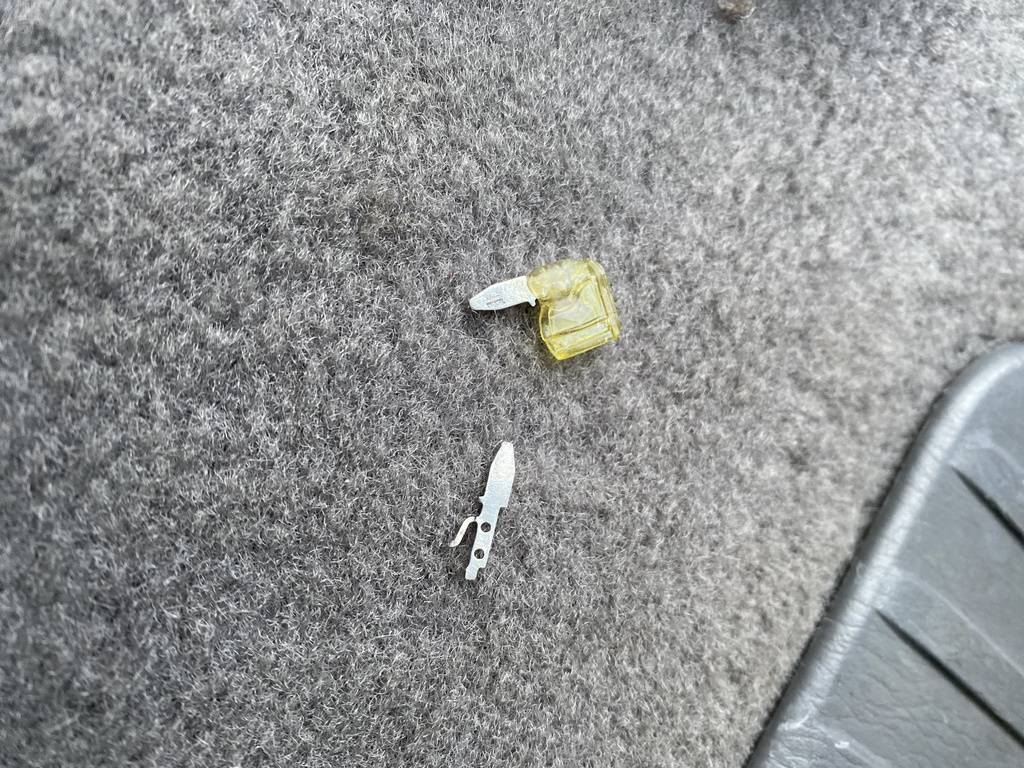

SOLVED! i know its late but for anyone looking in the future, for series !00 land cruisers and Lx470. if you have a crank and no start issue its not the EFI relay, fuse or fuel pump. It's the fuse block in the engine compartment itself. best way to diagnose it, when you have the no start and cranking only issue, have the key in the ignition and position TWO (where the instrument cluster lights up) see if your check engine light up or not. If your ENGINE light comes on, this is not for you. if your ENGINE light is not on, the pin on the fuse block where the EFI relay plugs (bottom right pin) is not getting contact, therefore you have no fuel and and a no start condition. Try jump a a small wire from Battery positive to the bottom right have pin where the EFI RELAY plugs in with the relay and start the car, should guide you to where the problem sits its upto you on how you solve it with a new fuse block or just finding a way to put contacts for the relay don't throw $$$$$ at the EFI relay or pump etc. i have seen too many people here being misguided i cannot stand it anymore

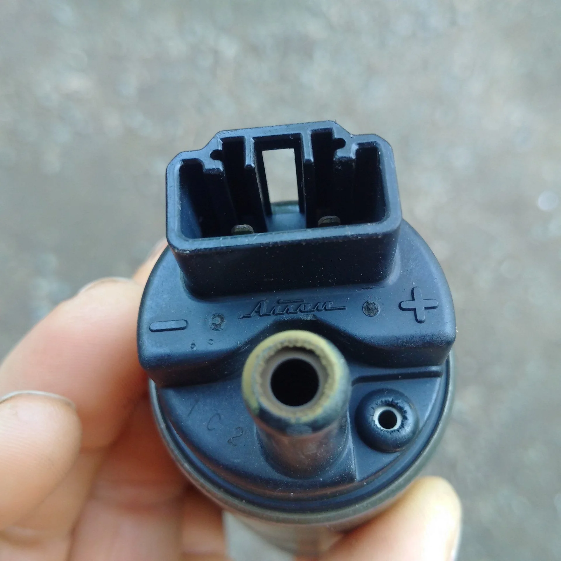

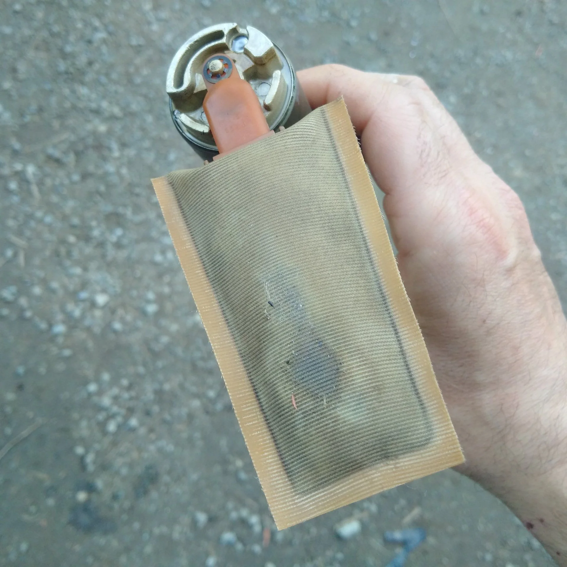

Thanks very helpful, troubleshooted mine today after it died pulling out of a parking lot. Mine was the fuel pump, original with 268,000 Miles. Imprinted Aisan on the pump top.

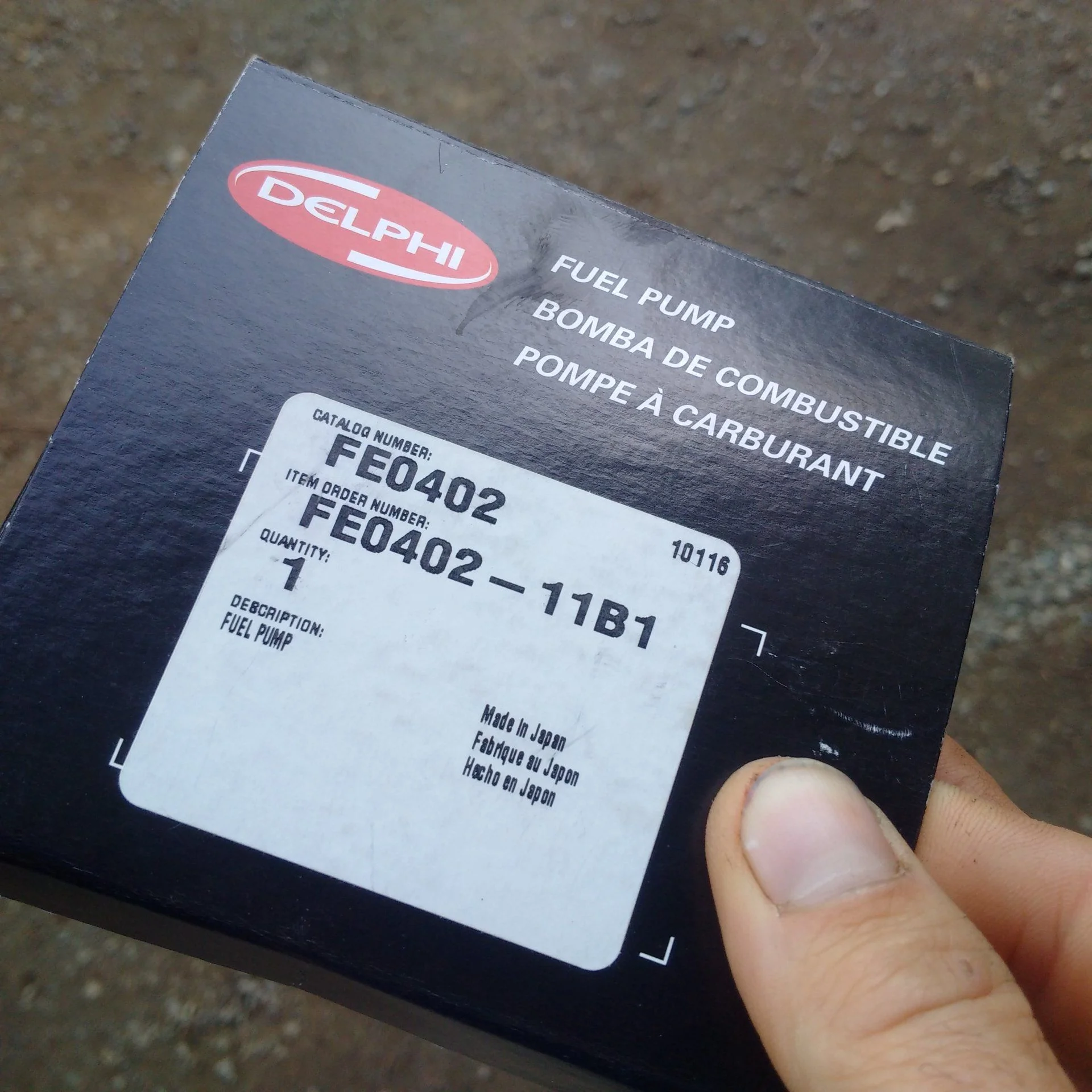

Only pump I could get this long weekend was a Delphi FE0402. Strainer extra. Pump labelled Made In Japan on the box and is a Denso with Toyota factory part number laser printed on the pump with a sharpie felt pen over it. OEM parts in aftermarket box, fairly common these days. Identical, same plug, no cutting for different wiring plug. Delphi strainer made in China but quality was very good.

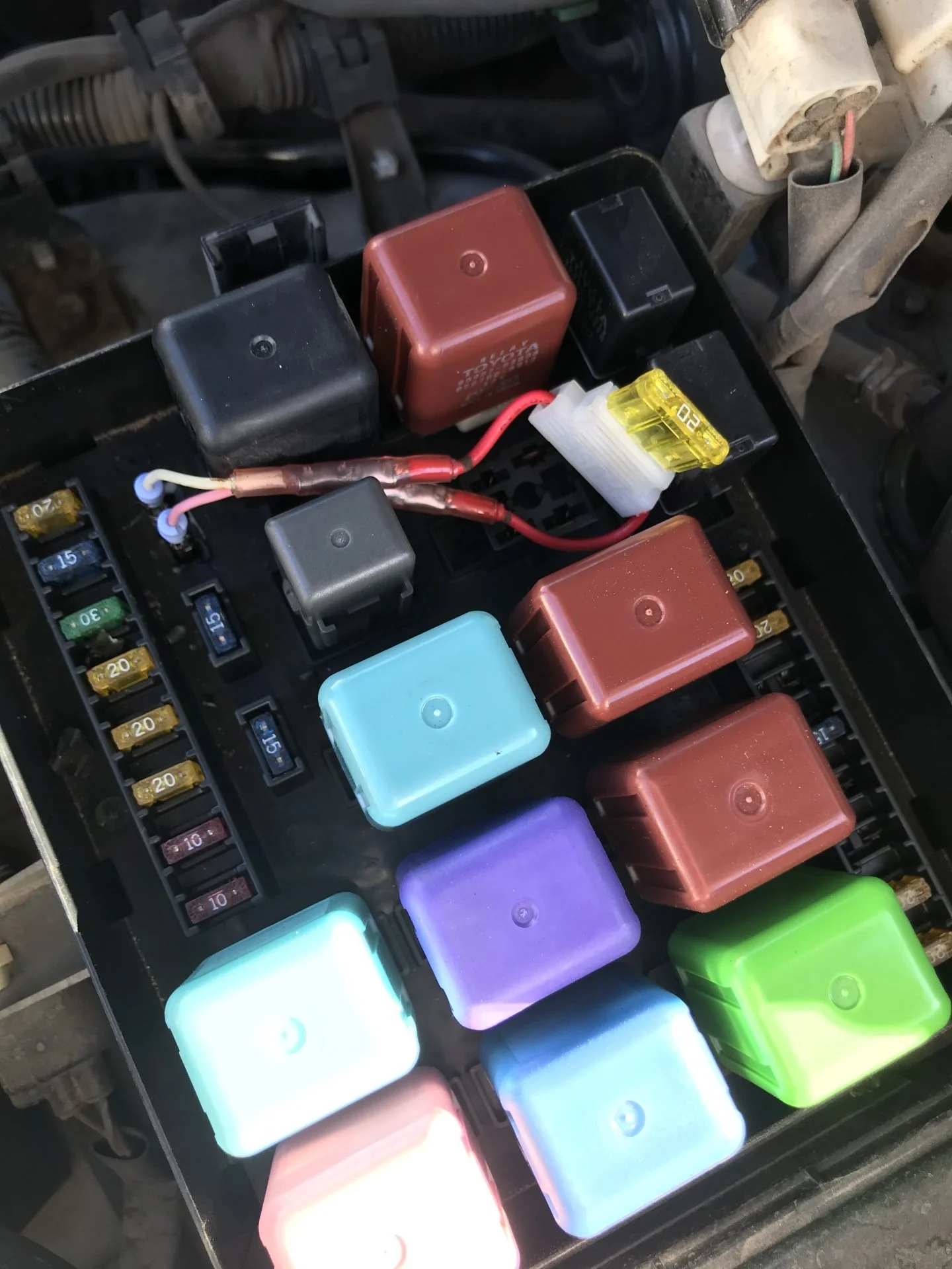

Mohammed! you are the man! I can not believe this worked. I have been trying to figure this out for months. I have a 2000 LC with 305k. I ran a small wire just as you described and presto! LC fired right up.
Now I need to find a permanent fix. Anyone have any Ideas on how to rectify this issue and bring it as close to factory as possible with out buying a whole new fuse box?
The clips that hold the 20AMP fuse in at the EFI get hot and the connection is lost. This happened on my 98 and now again on my 2002. My mechanic figured it out on my 98 and now just fixed it again on my 2002 for $75. You can spend thousands and get a new fuse box (if you can find the right one) and the mess of changing it out or do this simple fix. I put 100K miles on my 98 with it like this before I sold it. See the attached pictures. My symptoms were the same. Wont start, then would start. wiggle the fuse and then it would start. This worked for me and hopefully it can work for you. Happy Cruising!
If you Google intermittent no start LX470 there's a good video on why the fuse box fails. Inside the box as the connections get old they corrode and start to get hot. It's usually the EFI fuse that melts first, but inside the box where you can't see it the connections start to come apart. So sometimes they work and sometimes they don't. It's a tough call though because so many things can cause a no start. If it's the fuse box there's no fix, you have to replace the box (unless somebody has figured out how to repair it please tell me)
Well, as I wrote this the fix was posted, thank you. However, for me I will replace the fuse box as eventually the other stuff will fail.

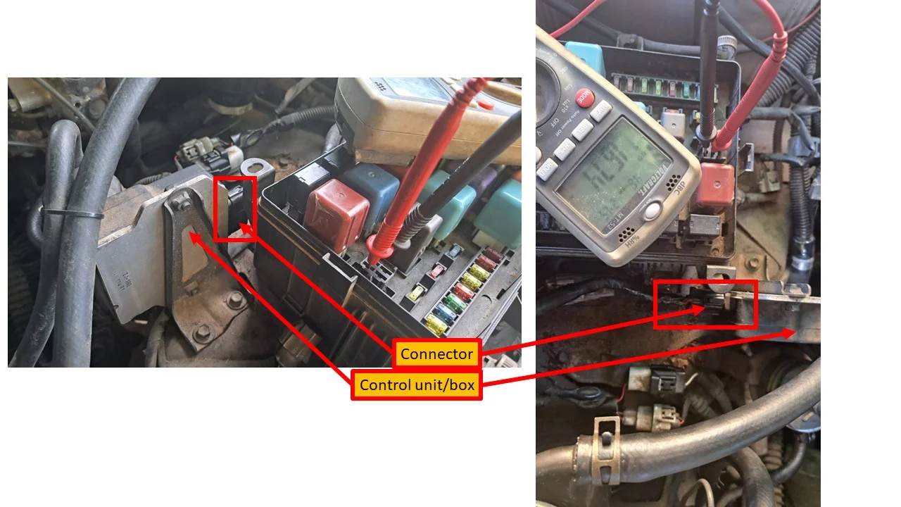

Alright.... I have some development of this issue. FOR THIS MOMENT IT IS SOLVED FOR ME, BUT DRIWING LONG TERM TEST IS PENDING
This morning I came to car and it started right up but run for like 10seconds and died. From that moment same story - cranking fine but no starting up.
I tried to measure all kind of leads and fuses again with no luck.
So in desparation I started to move cables to and from fuse box and I did aply presure to plastic cover on the bottom side of a fuse box in attemps to perhaps move some wires and or connectors to possibly restore conductivity before I disassemble it or perhaps order new fuse box.
Also I moved connectors in the area including some control unit which is beside the fuse box.
And car started right up.... No clue why so I kept tinkering.
So I found following:
-> While car is running I disconected fuel hose coming to the fuel filter (to remind I have 1HZJ 4,2l turbo diesl). I was expecting some stream of fuel, but non was coming out. Engin kept running for some 10-15sec befor it slowly died from no fuel. So I reconected hose and pumped few times with hand fuel pump. And engine cranked few times over and came back to live. Im surprised as I expected pump to be going and steady and perhaps slow fuel flow, but nothing. Yet engin is running and I also tried to load it for some misutes to like 3/4 rpm and it goes fine. Runing in idle for 10minutes. No sighn of any hickup. So despite no strong fuel flow it is going fine. I dont know if there should be presure or not, but car is running at least for this time no issue and there is no presure.
-> So I went to tinker with cables while car was running to see if I move it and perhaps disconect something again. Nothing happen as I tried to move cables and push again on bottom of the fuse box. Car running strong not even short chocking or slowing rpm.
->So I begin to move conectors and found that as I touched and moved just a little with that conector from that control unit engin sudely died. So I tried starting and it was dead again. So I wigle that conector on that control unit for a bit and apply some conductor spray, cleaned inside and reconected. Car started right up. So I tried to move that conector again and after moving some milimetrs towards unpluging car died again. So I think I found it. After some testing I found also it happens when you disconnect it replicate check engine light same as happen to me before when engin went out during driwing. If you plug it in and start engin immediately then check engine light goes off after few seconds. I dont know if this is solution for me for 100% as also it could happen that I restored some conection while moving those other cables and or pushed on the bottom fo fuse box. I will see and update here if there will be some development for me.
->Still I have a feeling this might be my problem as that engin went out just by only touching that conector initially. There was probably some cold conection. I will see on long term driwing.
-> Also for EFI relay draw was initially 4A and dropped to 1,6-2A. I had multimetr connected for 10minutes instead of fuse and draw was consistent while car was running.
->I tried to attach picture of problematic connector and also that unit. Perhaps it will help to someone. I still dont know what that unit is and what for, but clearly it kill engin. I will figure it out once I get time. If someone know then please let me know here.
