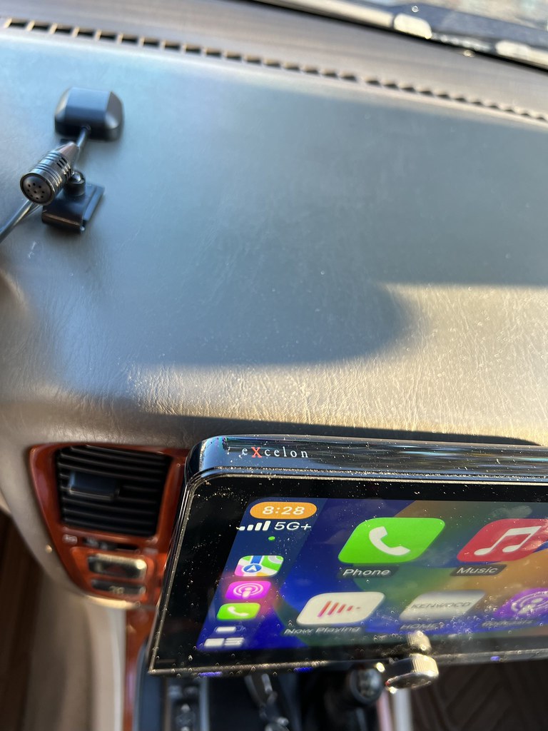

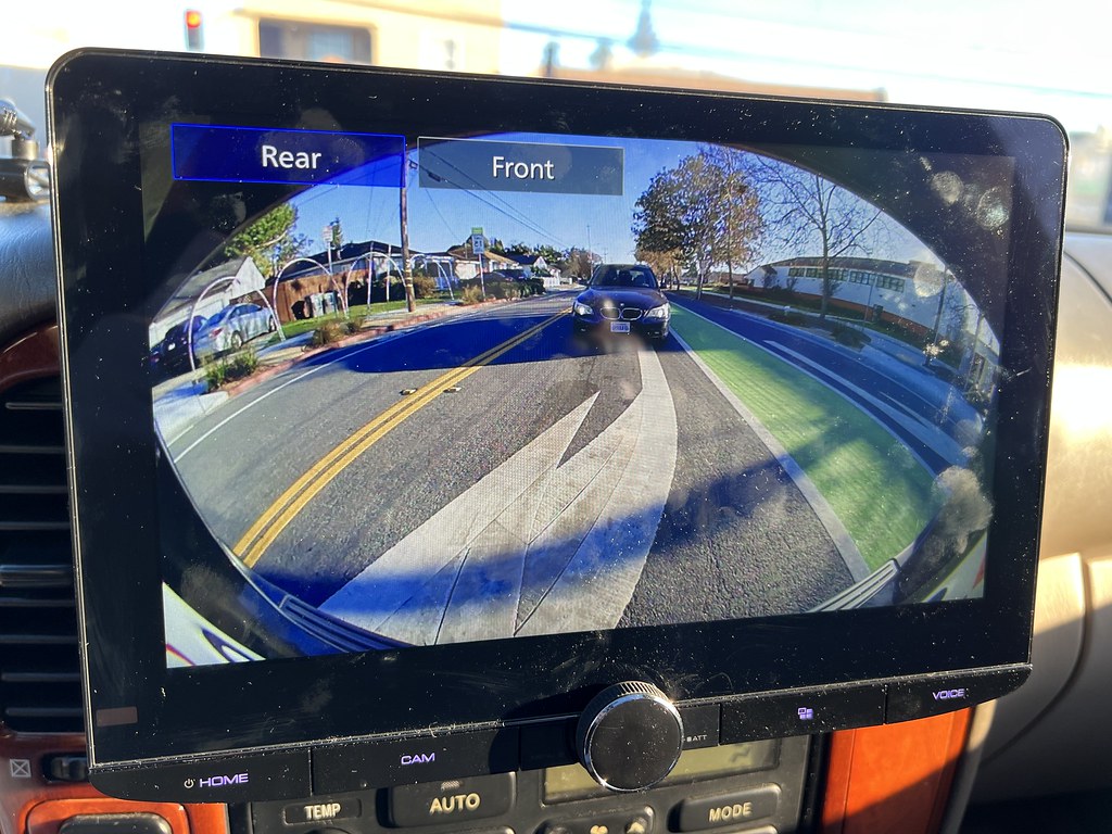

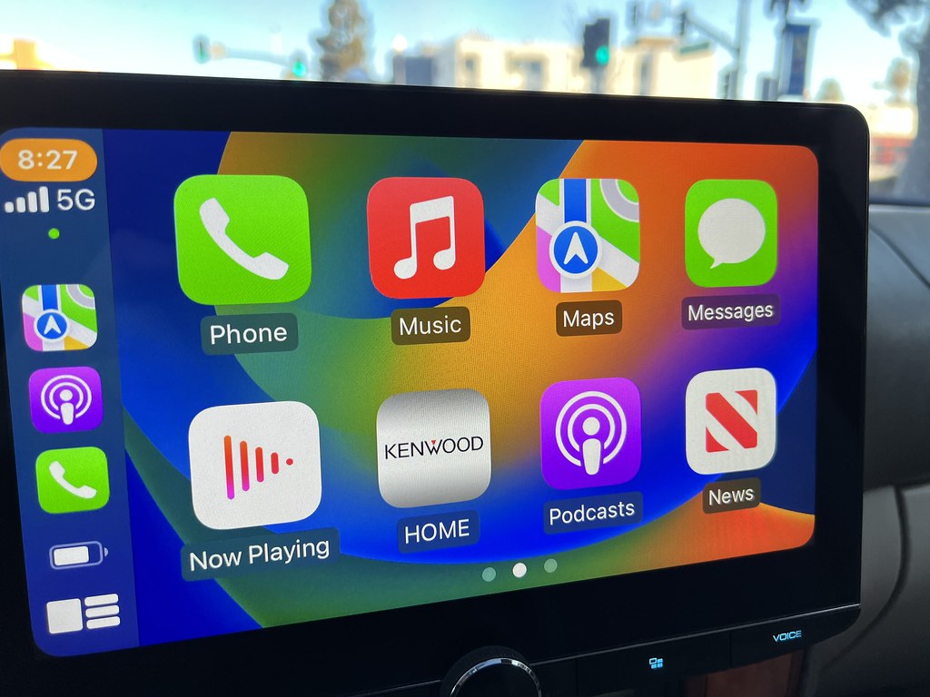

Finally had sometime to remove the Nakamichi on my 2000 LX and replace it with a Kenwood dmx1057xr with backup camera.
I keep the original amp and speakers.
Very happy with the result.
