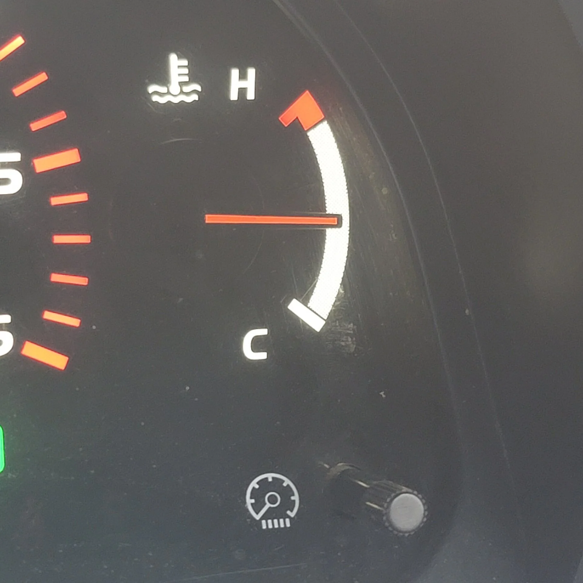

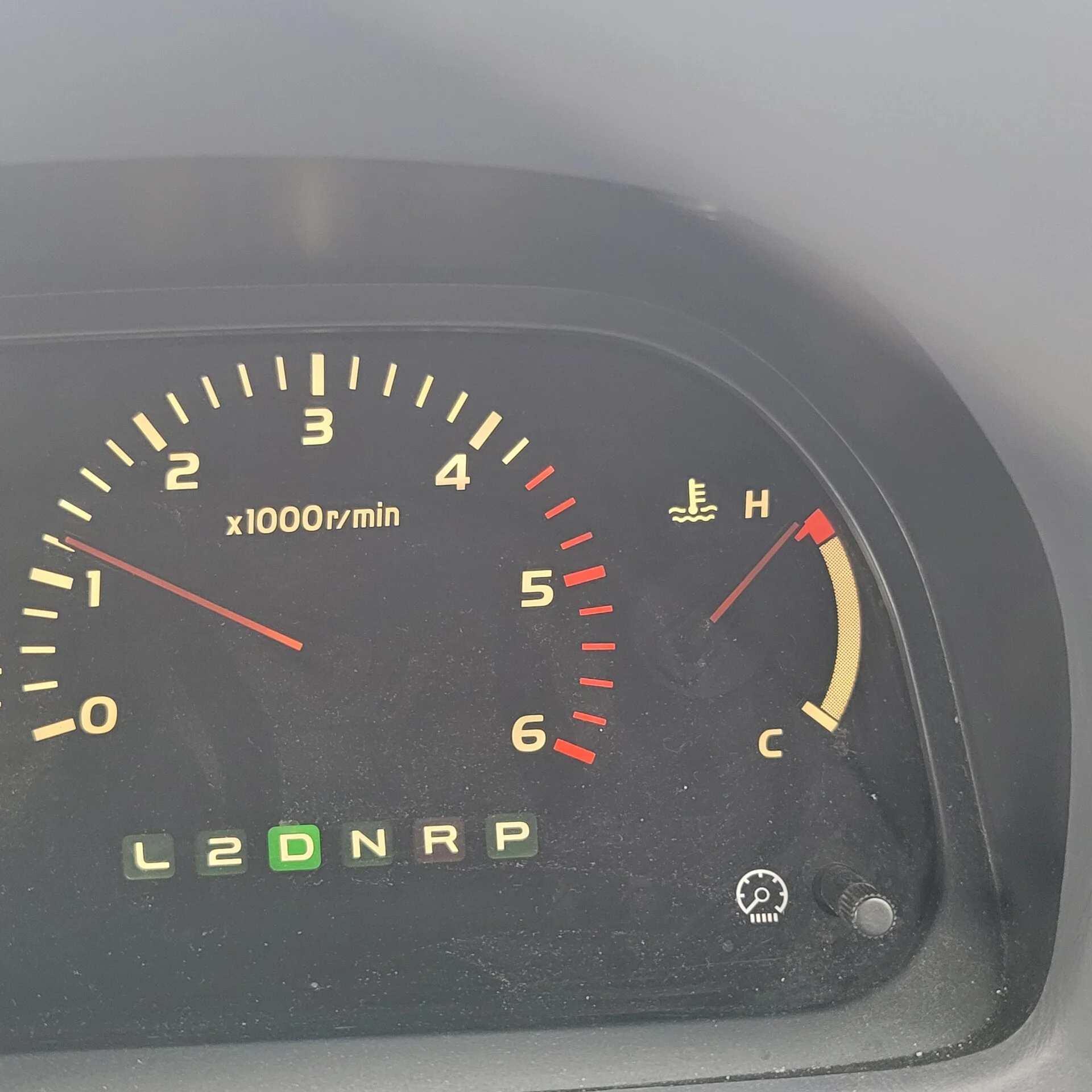

My Prado coolant gauge go on full high temperature when I drive. I have changed my coolant sensor, replaced and flush coolant, changed engine oil but the problem remains the same. Yesterday its stopped on the highway due to over heating. Engine gasket is still fine. Radiator fluid is full but the reservoir is little less than full.

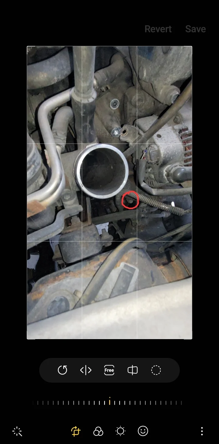

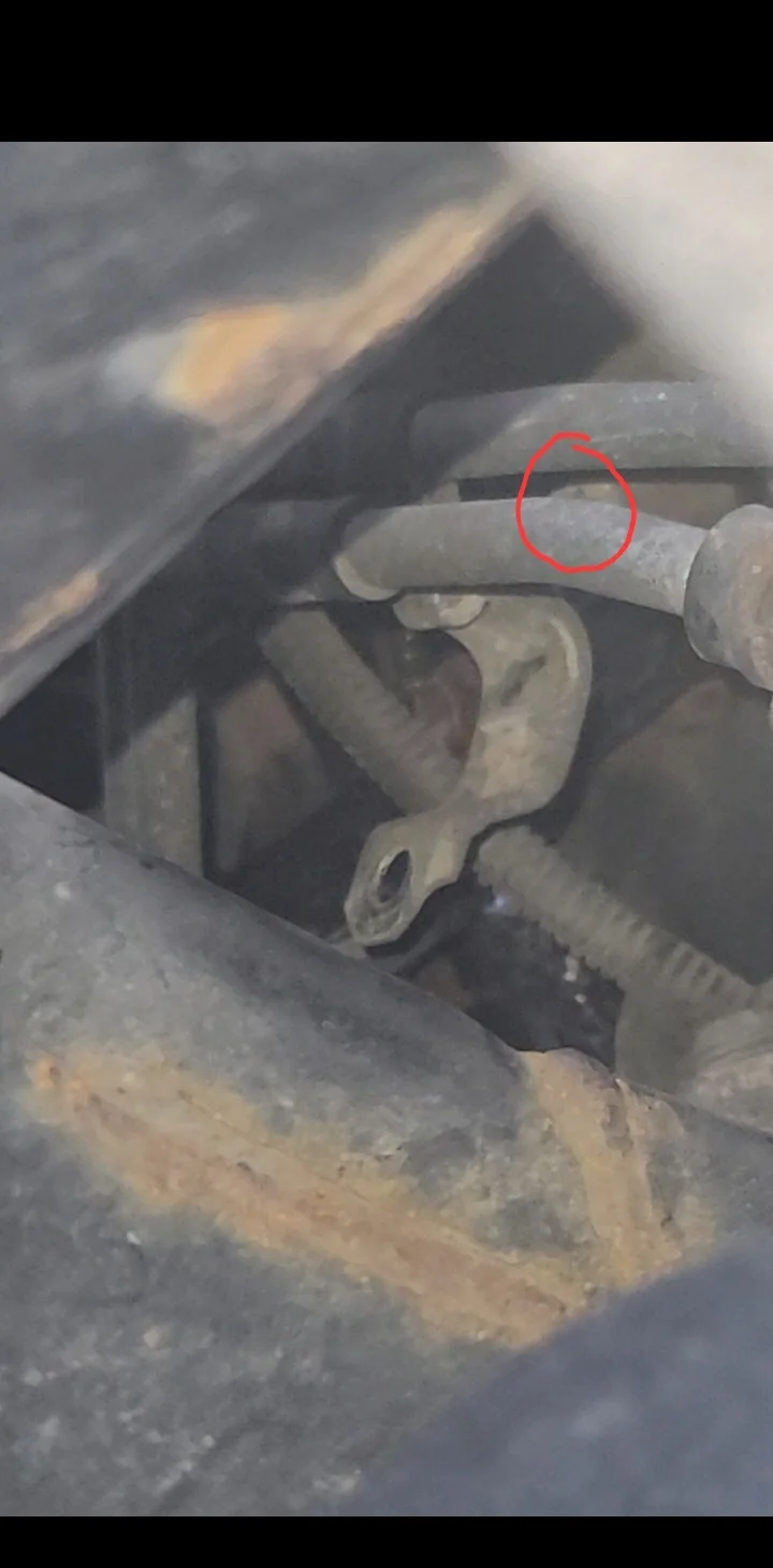

I have a thermostat now and I opened the two top nuts but couldn't reached the bottom one as there is two small metal pipes going in front which were attached with the thermostat pipe. I removed the nut but those two small dia pipes still not moving.
Here are the pics:
One is from the top ad when is from the bottom side of the engine. Any help will be greatly appreciated. I even bought flexible ratchet but that did not did the trick.
Thanks

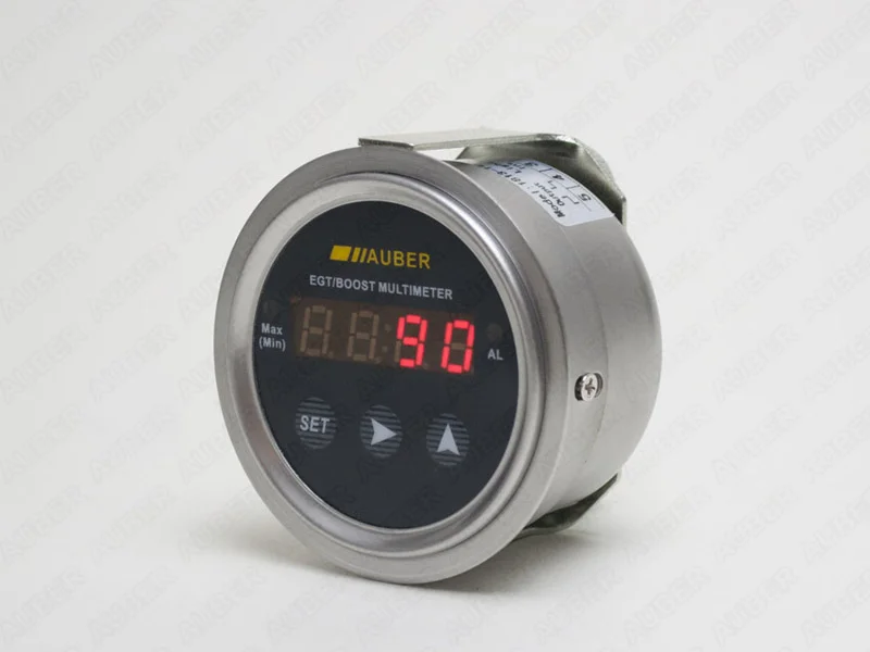

Hi JDM Journey!
I found this as you said with both oil and coolant temperatures. Is it possible I can use this on and replaced my oem coolant sensor with this:
i will email the company if its fit on mine.

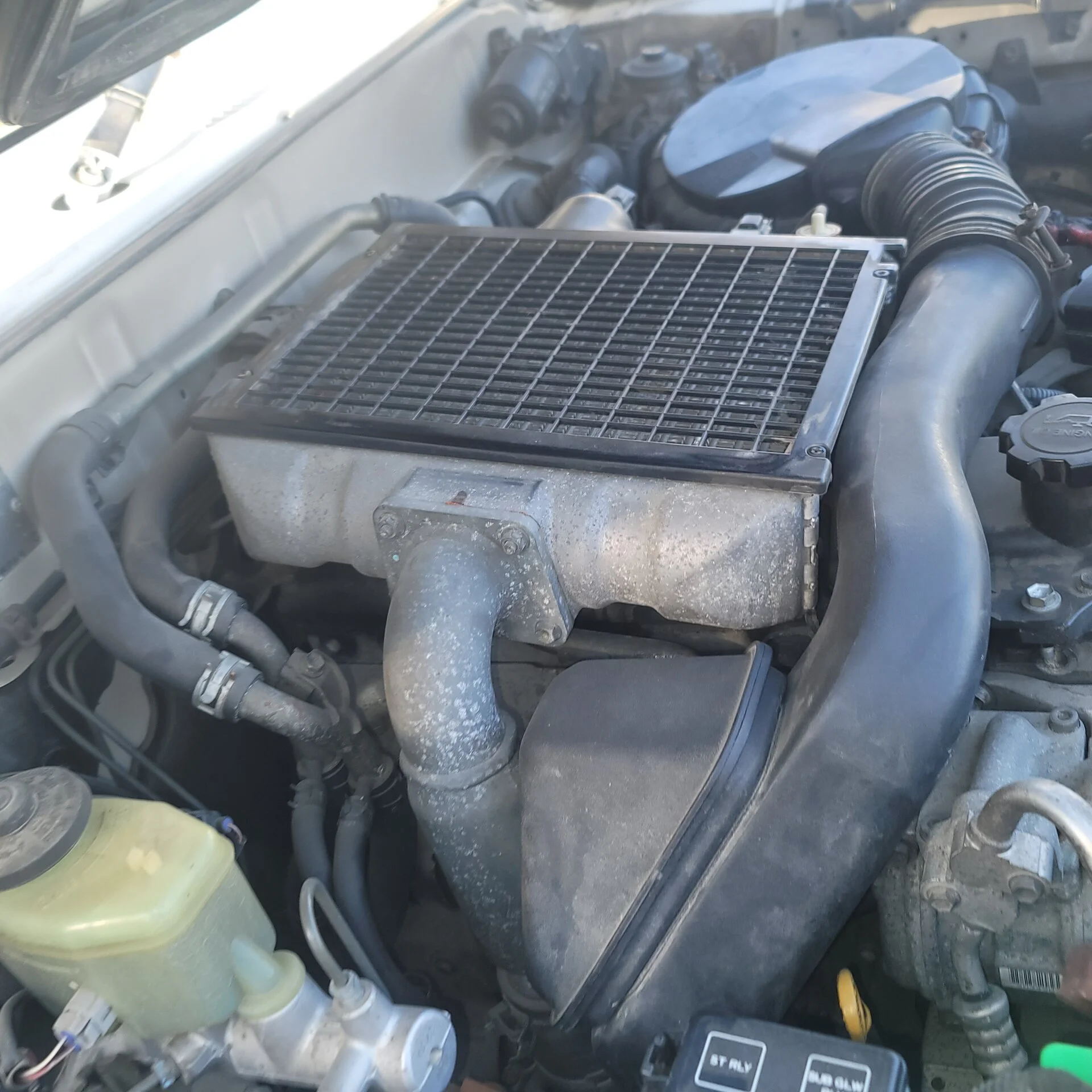

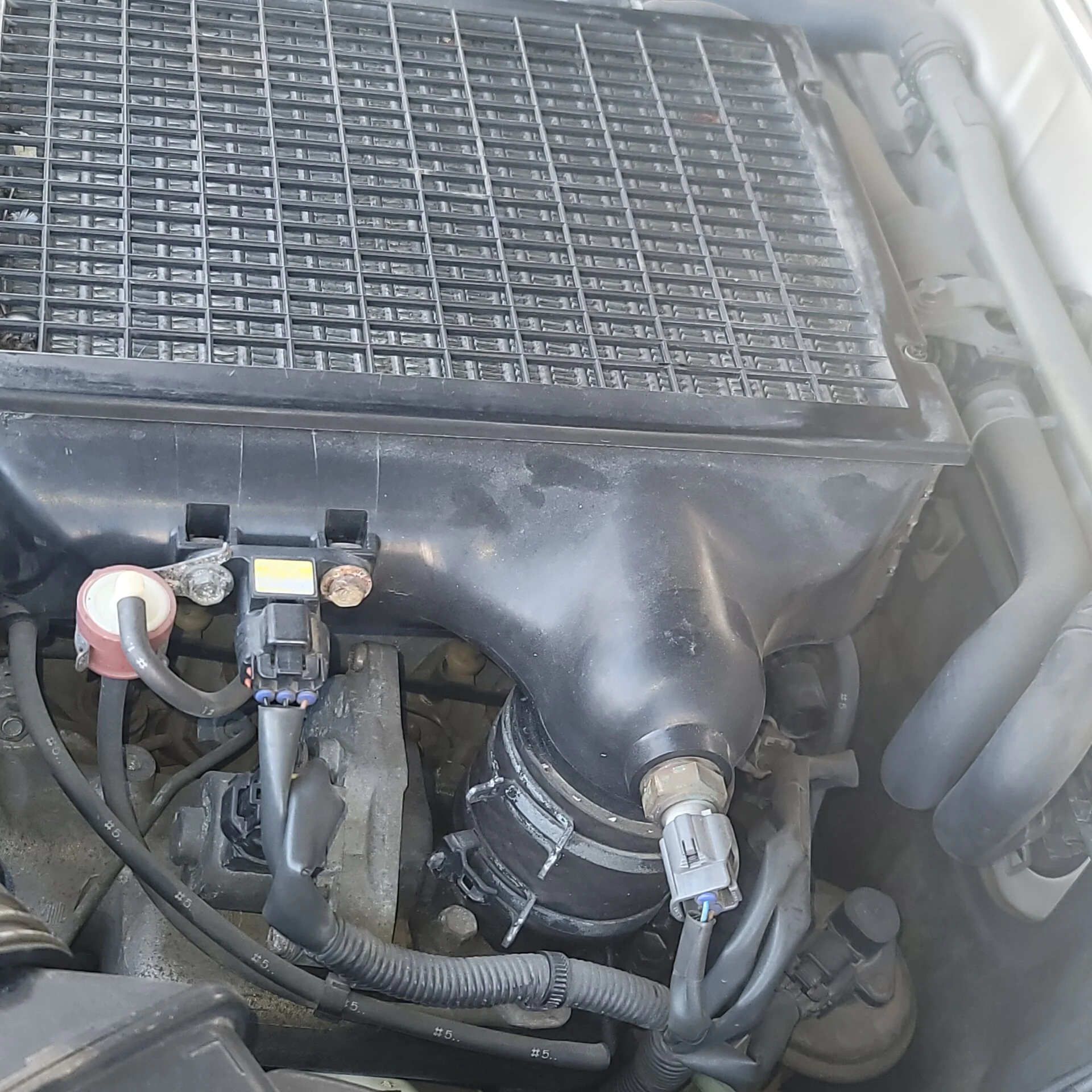

here is my engine turbo pic. any idea where to install EGT probe before the turbo 1/8 "NPT size?

Thanks for the suggestion. So far I have changed the Thermostat, Temperature Sender, Flush coolant, Radiator Cap, Fan clutch has been checked.
Temperature still go in red zone but Temperature of the coolant stay normal. Some people says bad cluster wiring or display meter malfunction.
