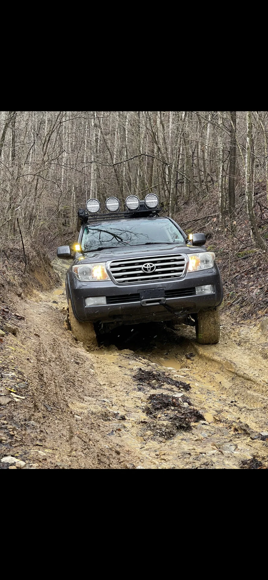

Love mine!!!! Works flawlessly. Went with the Smittybilt X2O Gen 3 10K
