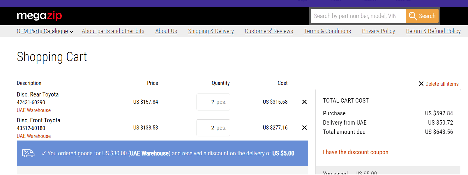

It seems like everyone here thinks rotors are cheap? is the almost negligible difference in performance really worth $500? I feel out of touch. It's a truck not a track car.
You need a new parts supplier :) Front OEM rotors can be had for less than $70 each, at least for the '08-'15 brakes.

@bloc @Sandroad I never asked local dealer but this is the price online at megazip for 4 rotors(idk if they are overpriced)
That's pricey!!
Try this. I don't know if they are the cheapest on the internet but they've been really reliable and fast for my needs.
You can try your local dealer also to see if they will price match. Can save on shipping with will call pickup, even if they don't completely match.
