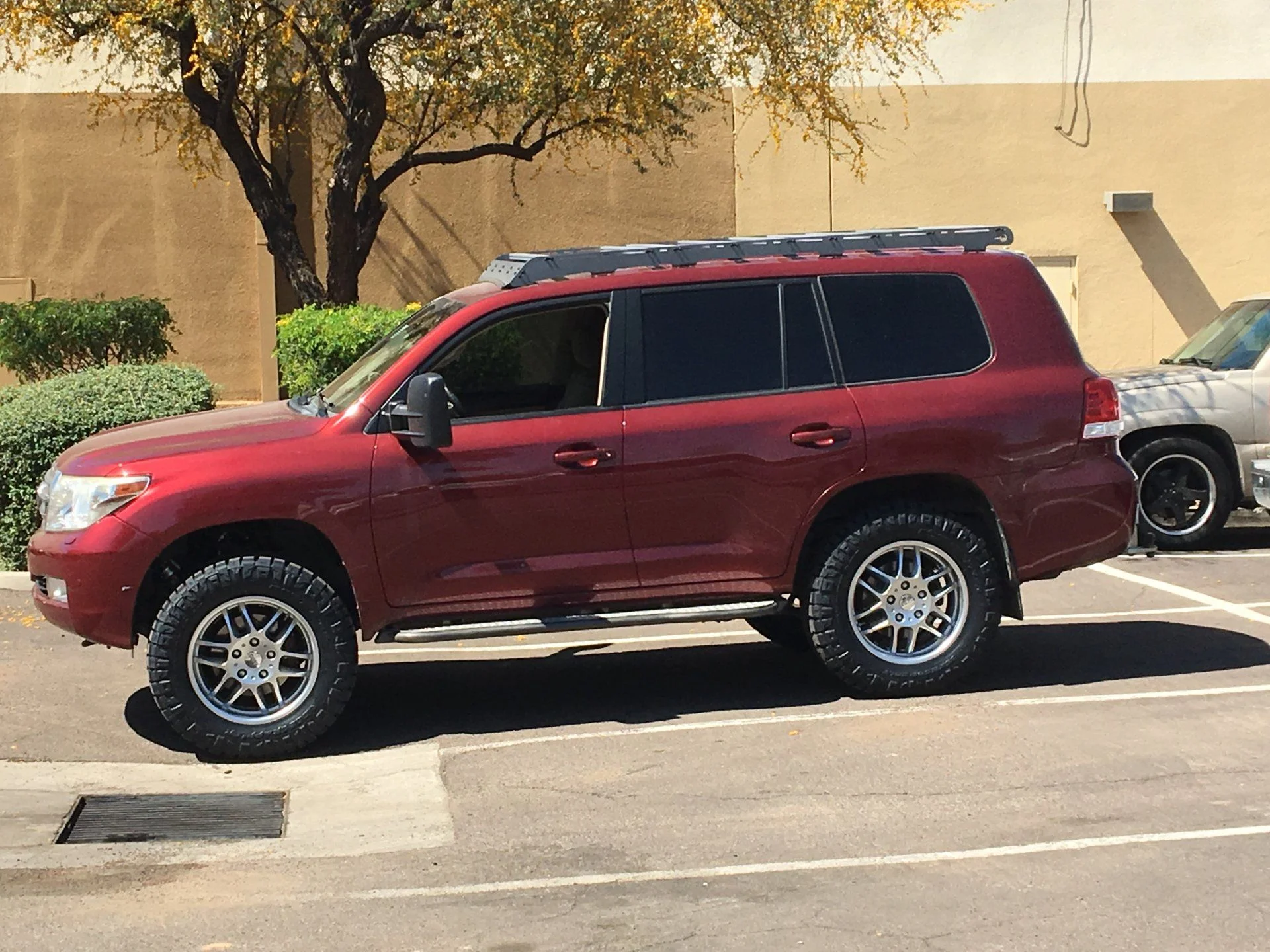

What wheel spacer were you running in the rear? Show us your new wheel BBS and tire setup.
Only one cell phone pic so far. washed truck today, so i'll get better pics this afternoon.

They look great. May I ask: do they rub?
Wow - those look good ! 20's are the old 18's....
The rubbed on the front little flap. I took those off, and added a couple screws to the wheel well liners to pull it forward an inch or so.
The left still has a rub under compression. Haven't had a chance to see where yet.

I'm not a flashy guy, but man, that looks great! I saw you were selling your last wheel/tire combo, and was wondering what you where doing. Very nicely done with the BBS wheels from a tundra. I had the 17" version of those, and they can take an absolute beating from rocks for years and never fail.
