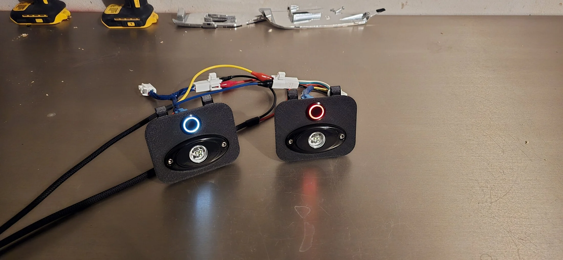

Trying to reinvent the wheel I guess. I wanted a cargo light that didn't stick out as much, so I ended up copying and 3d printing a factory replacement that is recessed near flush and has holes already clearanced and ready to go for the pod and button. I offered an initial run of these on a facebook group and refined and made a couple tweaks based off feedback, so here we are.
They are printed in Nylon so heat and any UV exposure is not a worry. I have not been able to find a tan or grey that I am happy with so for now black is the only panel color option.

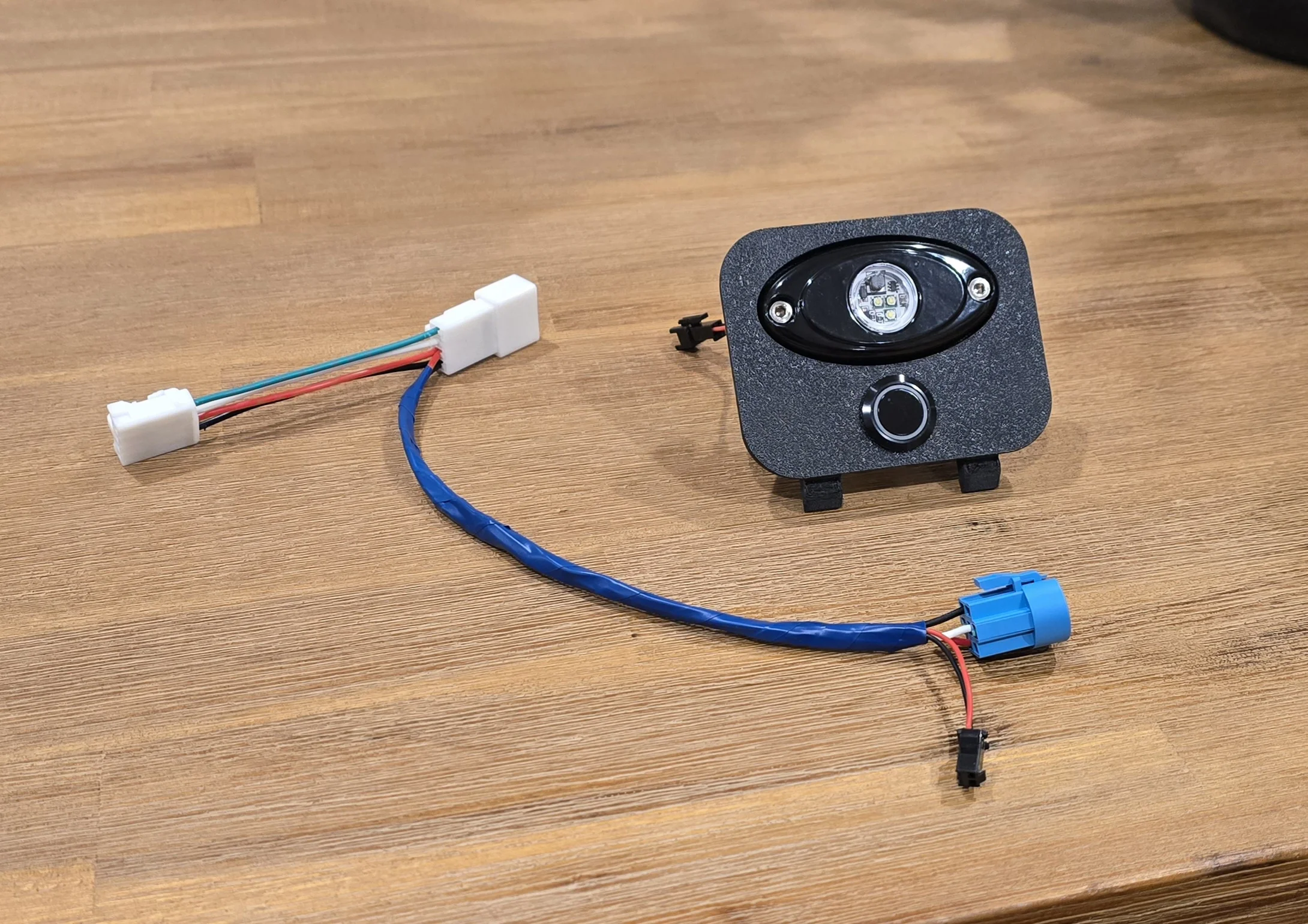

The wiring plug and play for LX570 and power lift gate LC200s. Install time should take less than 5 mins if you have small hands (or access to such) to get to the lift gate plug behind the panel. Powered off the liftgate circuit, will automatically turn off when the gate closes or after 20 mins. While liftgate is open, can manually turn on/off as well. Due to the recessed pod, there is slight trimming needed behind the panel just to the edge of the plastic. Cannot be seen, does not need to be pretty. Can be done with dremel, razor, hot knife, etc.

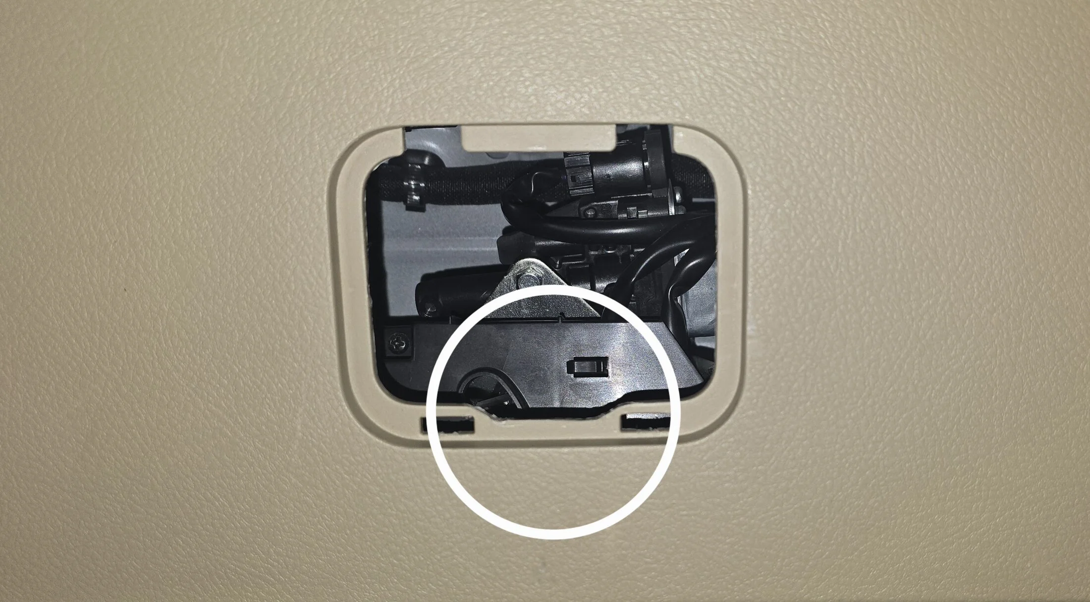

Better photo showing the slight trimming needed behind the cargo light panel.
