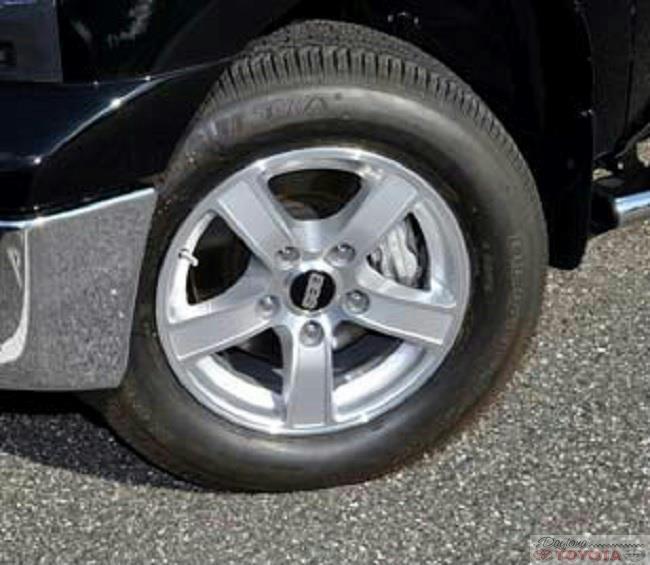

Any info on these Tundra 18" BBS? Not sure of the center cap situation. Toyota part number 00041-34850. There is a set with tires near me for a reasonable price. I've seen the offset quoted as +40 or 50.
