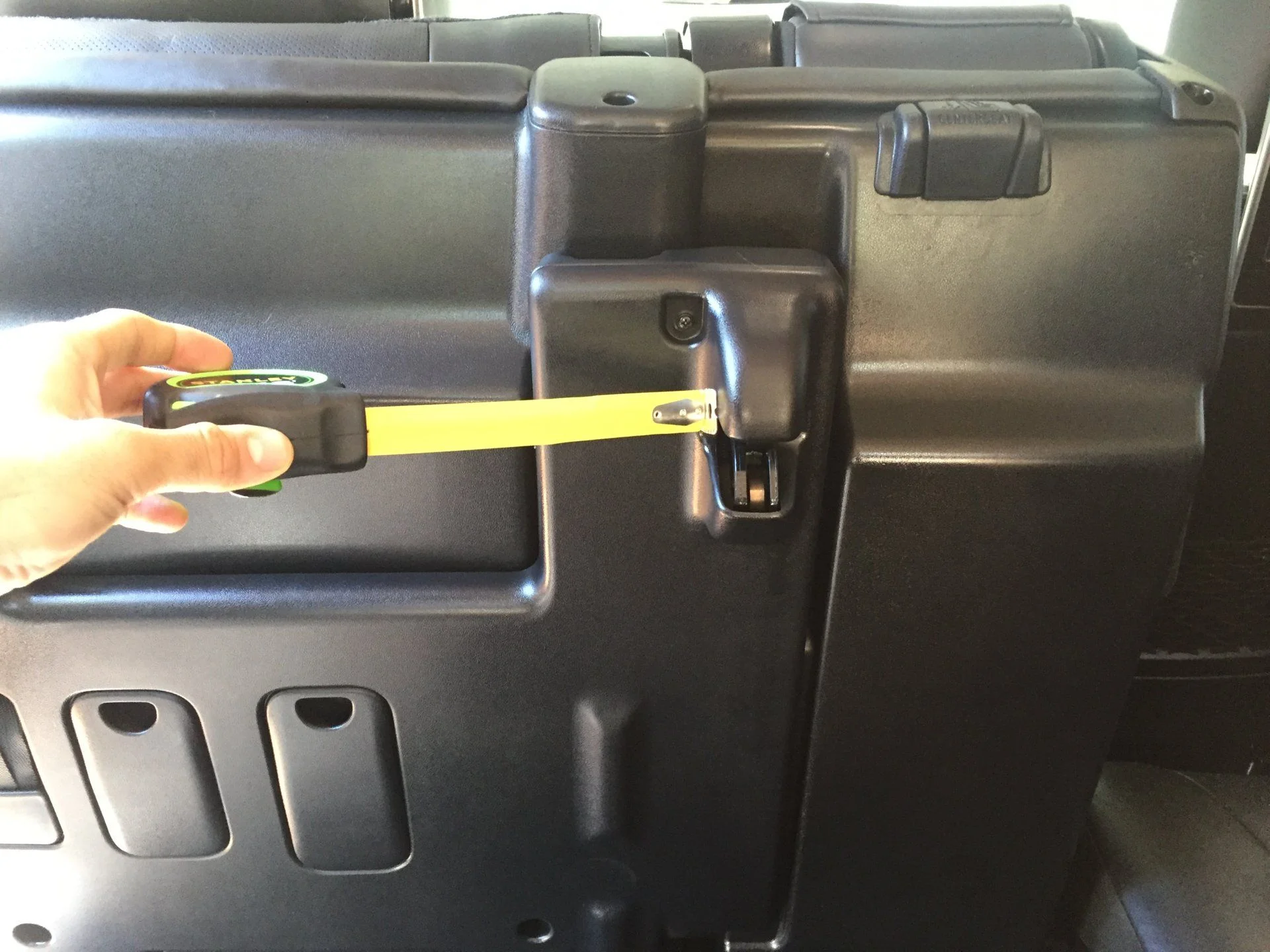

I bought a 2016 200 and noticed the 60% side of the 60/40 split was shaking in my rear view mirror. This is my third cruiser so I know this shouldn't happen. I took the truck in yesterday, and they tore the seat apart and couldn't figure out the problem. They then told me this is common on 200's? I call BS, but wanted to check with you guys first before I escalate this. It was slammed and the guy helping me was really no help at all.
I was poking around and the plastic piece my tape measure is pointing at has a lot of play. The screws all seem to be tight, but there is a lot of movement in this piece. I took a video so you could see this. Please let me know your thoughts and if any Denver 200 owners have a good contact over at Autonation that I could talk to that would be great!

2016 model here, and I can confirm my 60% side has just as much play in it as yours. But I will say that it has never caused any issues - noise or otherwise - for me.

All of the seats will wiggle a bit. It's the nature when seats are meant to detach and fold. Also preference and perception come into play too. For example, I think the amount the 40% side moves in your video is too much. But I know it's normal and others may think that's no movement at all.
But the 60% side is not normal.

After all that if you get no help- other's on here, including myself, have found that it helps to tape the anchor with pipe tape.
Adding tape makes the anchor thicker and reduces movement when latched.

My 2008 doesn't move like yours. It looks to me as though that inner anchor point is basically non-functional, which I would think to be a legitimate safety question. Seats should definitely not be separating from the anchor even partially.

There is not much effort to move the 60% side. When I got underneath the seat, there is a lot of play in the plastic base where it latches in the center anchor point. The 40% has no play in the base and it takes a lot of force to move the seat as much as I did in the video. Driving down the highway the 60% side is just shaking away. No noise, but it is moving a lot. I climbed in my 100 and there is 0 play in the base on either side and little to no movement when you try to shake it with your hand. I'll call Toyota and let you all know what I hear from them. I'll also call Yoda, I mean Christo's team, and see if they've seen / fixed it on any customer trucks.

2017 owner here. Mine does the exact same. The 40% seat locks firmly in place, the 60% is (almost) as loose as the video above. Constant rattling over uneven surfaces led me to try the temp fix linked in a previous post. Its better, but not perfect.
