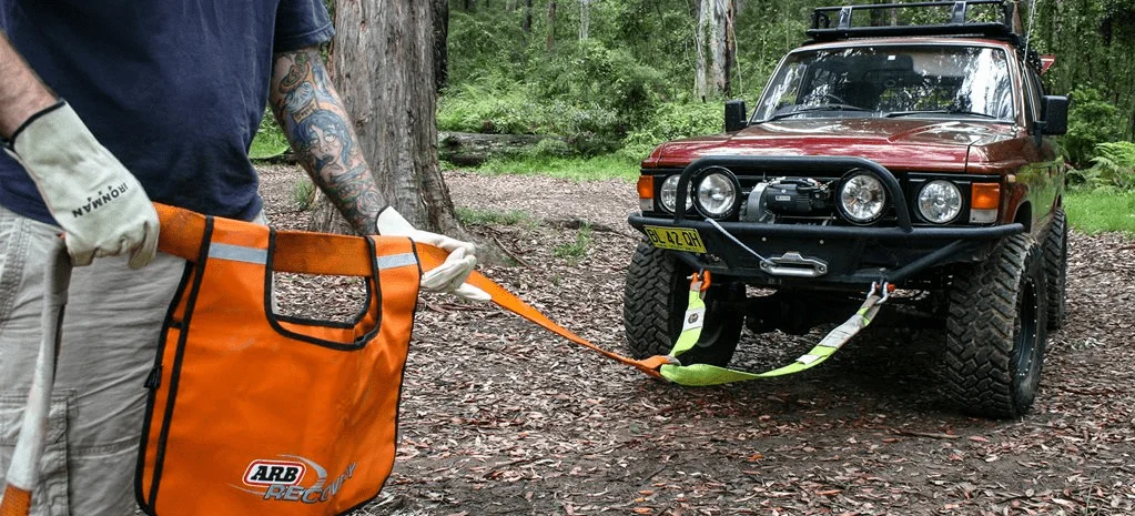

So here's what I've wound up with. I won't pretend to be an expert here but have done some research. For those more experienced, feel free to add or correct me.
Here's the basics I'll need to either help someone else, or selfishly help them help me get out of a bind.
1) Snatch strap - What goes between the two vehicles
This could also be a kinematic rope but I'll stick to snatch straps here as they are a better value for an emergency kit. Note that "snatch straps" are distinct from "tow straps" that may look the same. It's important to see an elongation rating in the description as it's otherwise a tow strap that won't stretch and is dangerous to use as a recovery device. A snatch strap will stretch, functioning as a rubber band, storing energy, minimizing instantaneous forces that break stuff, and effects a far better chance at recovery.
A strap needs to be strong enough for the vehicles being recovered. As I tow a travel trailer, I wanted one strong enough for even that type of recovery. I choose a 4" wide one. A 3" could arguably be enough for our 200-series?
A strap needs to be long enough to actually have some length to store energy and allow more flexibility for recovery. In the video I posted above, they very effectively combine multiple kinematic ropes segments to build longer strings to allow a lightweight jeep to recover some really heavy rigs including RVs. Like a longer rubber band, it has more potential to store energy to perform the snatch.
2) Recovery Bridle - Strap that hooks to two recovery points as is needed to hook to the front of the vehicle
As @indycole mentioned, this is necessary to hook to the front as there is no central pull point. This strap will create a "V" for the snatch strap to pull from. Various flavors of this but a shorter section of strap is usually used here. Commonly a "tree saver" strap that is a 3" x 8' is used.
3) Shackles - Link that joins strap eyelets with recovery points
A link that can be opened and closed to tie together the closed eyelets of recovery straps and points. This could be a soft shackle (short section of rope) or a metal D-Ring shackle. It's a personal preference and each has their pro/cons which I won't get into. I choose D-Ring's as they are many times stronger and resistant to sharp metal edges.
Example of bridle with shackle to hook to the front. The 200-series does have factory front recovery points to attach to.

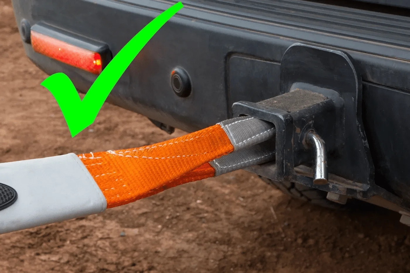

4) Hitch pin - Any generic 5/8" hitch pin allows one to connect the snatch strap eyelet to the rear hitch
It's a proven method and viable for straight pulls. Pulling off angle could result in the strap getting cut against the square edges of the receiver however.
That's it. $100 for a highly functional and strong recovery kit. This setup allows for one to safely pull or be pulled from the front or rear of the vehicle.
