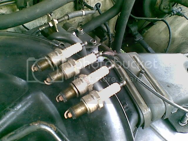

in order.. Denso W16ERXR-U
All cyls, 150psi

Changed the plugs...
HC: 99ppm Limit:220
CO: 0.05% Limit: 1.2
CO2: 11.5% Limit: N/A
from 512ppm to 99 and all I did was change the plugs...
I'll say... And I just remembered the vac to the gargle/ reed valve was pulled... So whatever it was or did, dint even matter...
Runs cooler now and has a lot less stumble/ stutter.
But all I did was change the plugs and fiddle with the timing some...
