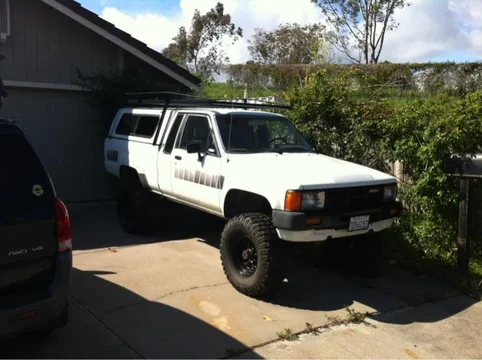

Actually I am doing it again...but to an 85' xcab 4x4 (yes it has the SFA and 22re:steer:). Pics to follow.
