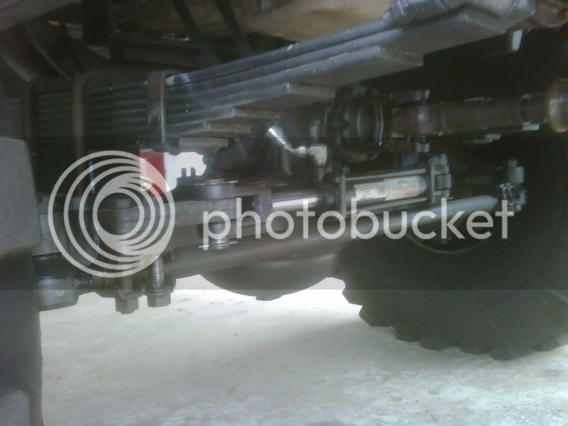

have you got pics of this 40?
its in the garage on its baby tires but if you want pictures of the truck and axles i can do that.i use timkens because they are strong as rocks have double roller pinons and are made for long life.also they are narrow and with 46 military tire and flares the tires dont stick out .we are mud guys so i dont know about rock crawing .my club is building a course this summer so i will find out .its gonna be 32 today so will try some picks good luck

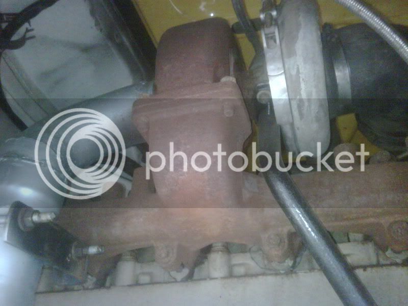

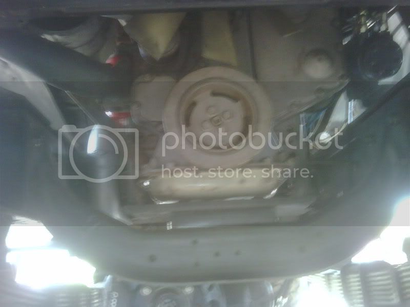

tha pics ..
6BT
WOW thats nice lookin ... for a Cheby :grinpimp:
I would think even in the mud y'all run you should shave-em I bet its going to be a blast in the jungle
badarse! it didn't register to me when i read the original post that 6bt=cummins 6 cylinder, he should be able to get all the horses he'll ever want out of that badboy.....and how much does that beast weigh?
and x2 on mohawking the rocks, less drag in the mud or liquidy clay or whatever that stuff is that yall ride in

dont know for sure what those are but they are not like any timken axle i have seen or used .at the start of ww2 all 6x6 trucks used timken axles .timken could not keep up so other axles were made .napco, marmon ,ford ,all halftracks and armoured cars used timken axles .trying to get photos but snow is so deep it raises the front of the truck and hits the garage roof .there is nothing wrong with rockwells they are strong and plentiful most places. i had a pile of timken axles from a military junk yard so i used them .the 2.5 ton rating on the deuce is off road capacity on road they are rated at 5 ton and handle that easy .good luck
