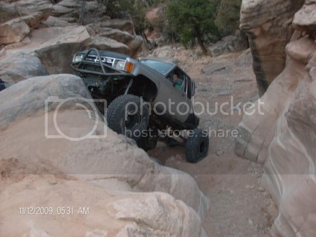

Then i went to moab with josh and goose
decided i needed more wheelbase before i went down there so i got some more yota rears and put them on all corners and swapped to yota axles
i loved the new stance but still wasn't long enough to keep up with goose and josh

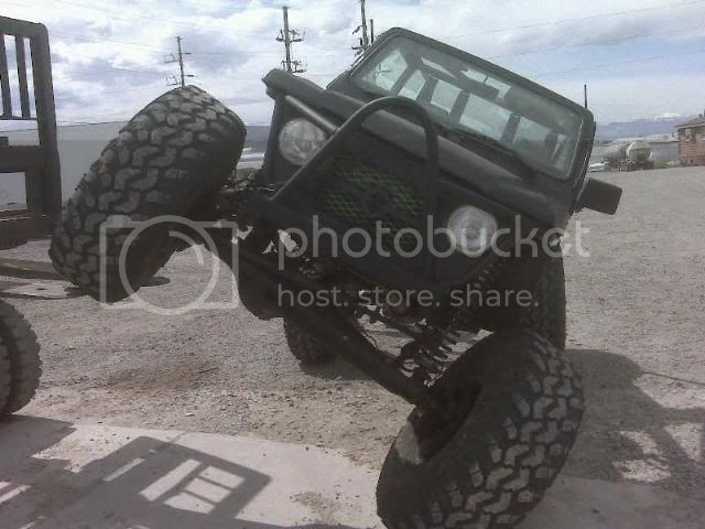

second flop at the snakes! i had no hydro assist so to be able to turn i had my arb turned off.. started tipping tried to throttle out and the tire in the air spun(bad driving im just making excuses)
tricky recovery just me and my gf on the trail and my 2000lb rear suspension winch mounted up in the frame rails

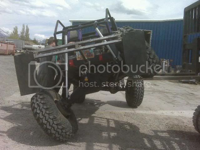

also made a rear bumper with flaps to keep mike thurston off my back!

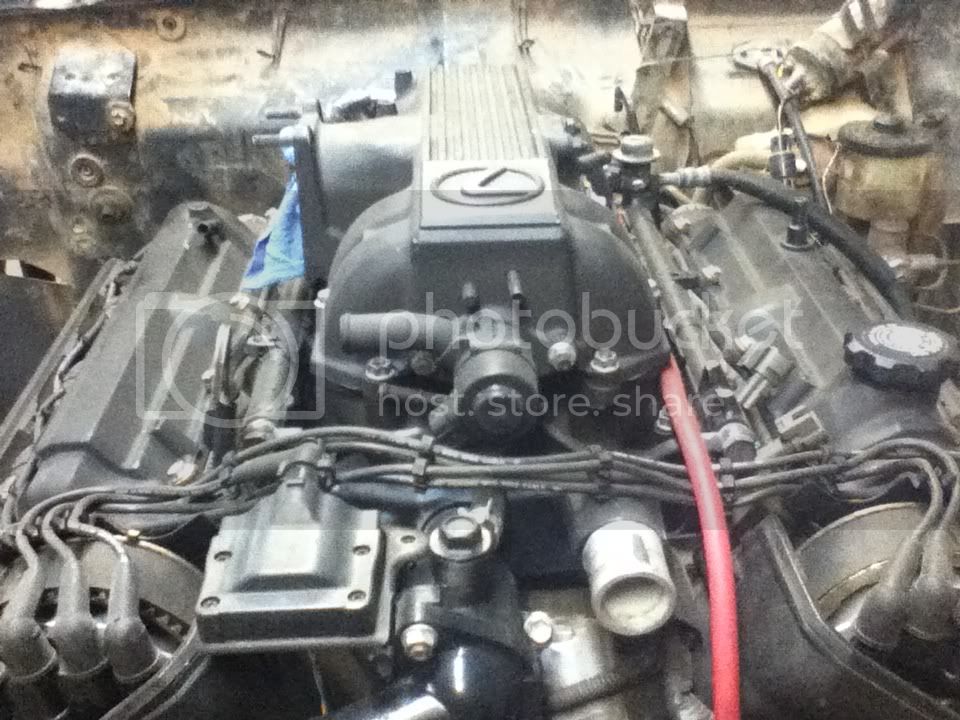

o i go the motor mounted last night
then put the hood and grill back on and started some tube work

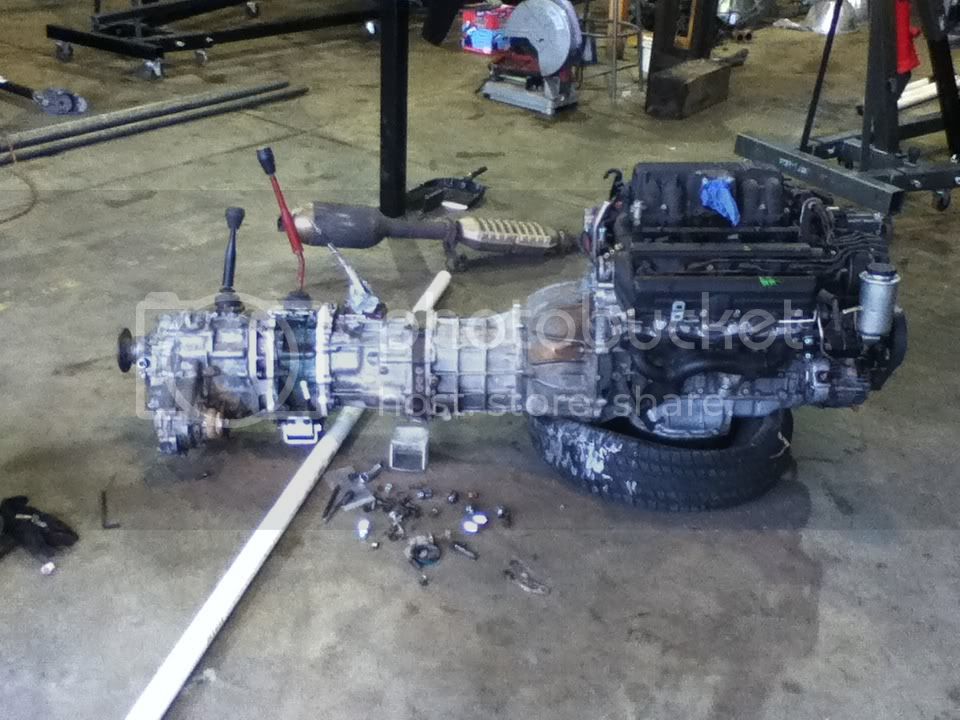

I got my r150f to gear driven cases adapter
Got it all bolted together
On it's way in
Had to trim my floor somemore for the cases I clocked the cases 10 degrees and now I wish I wouldn't have! But I'll cross this bridges when I get to them

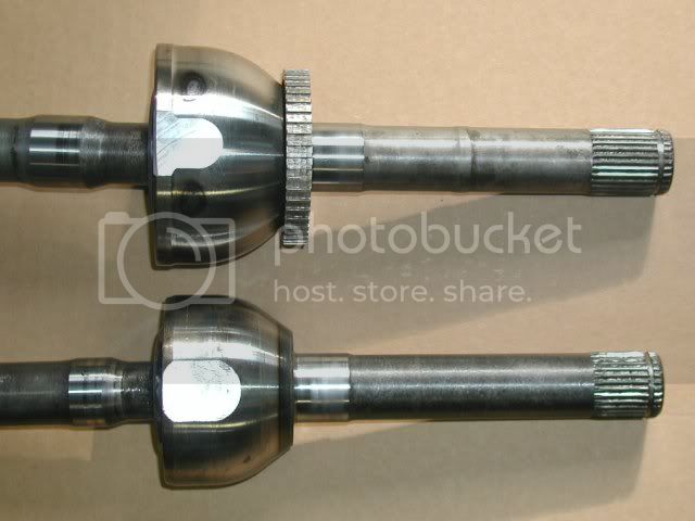

Got my awesome front housing! 9.5 center section with 80 series ball,shafts and knuckles!and some link brackets that will go on my rear tower to help lower it but keep the same separation

its a 1uzfe from sc400 i remember right. 290 hp and 300ft lbs torque , i like them because they have a high rev limit and rev fast like a 4 banger!
the tranny is a r150f 5 speed, then dual cases with 4.7 gears in the back case .
