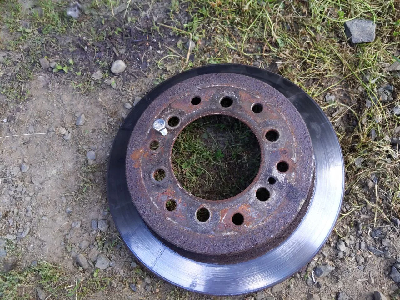

Edit: Getting the caliper off was easy. The rotor is very, very stubborn though. One of the M8 threads for aiding removal is too rusted to use. The other one I've put some torque into, and no luck. I've used an old can of Liquid Wrench where the rotor goes around the axle end, and have been beating on it for a while. It's not freeing up. Any suggestions?
I got them off... The bolt moved it slower than I thought, but it worked. The other side had two good threads, so much easier.

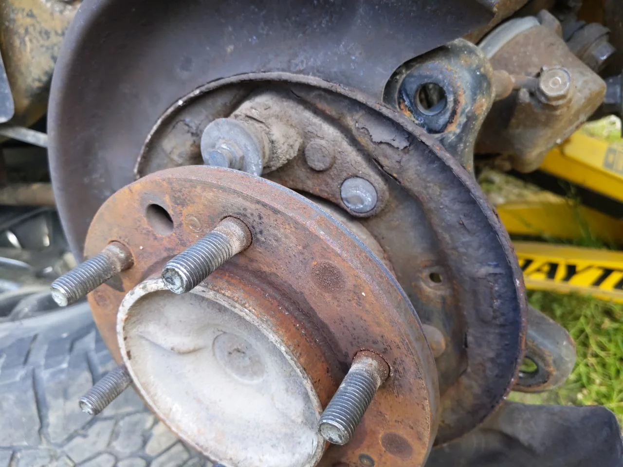

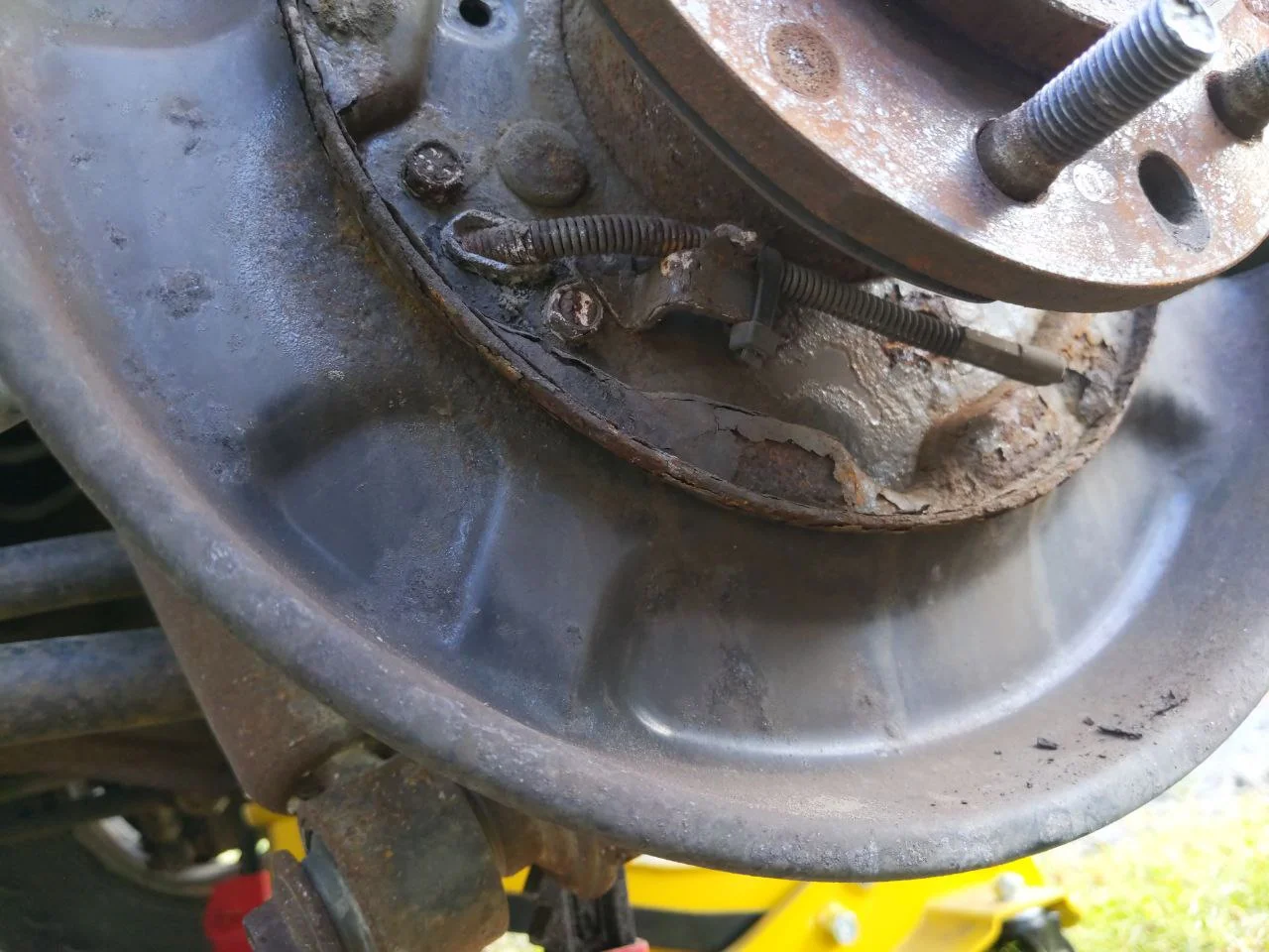

I've figured out what's wrong.
No brake shoes!! Why??
I guess this clears things up. Will have to look into what parts I need.

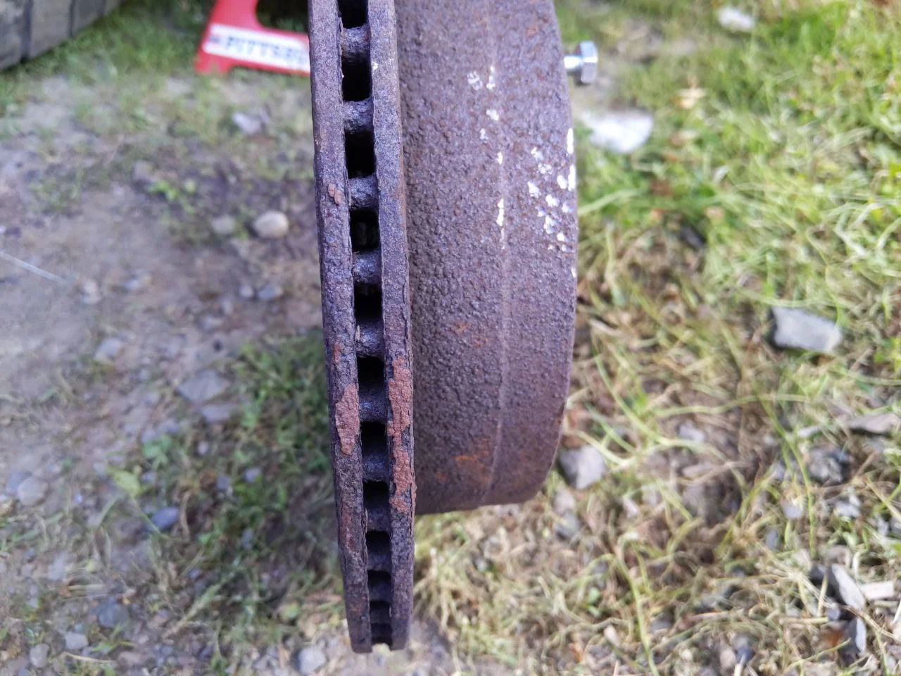

Also, never seen this kind of rust spot on the back side of a disc before. Any ideas? Does it seem alright? I would've thought it would've been smoothed out by now.
