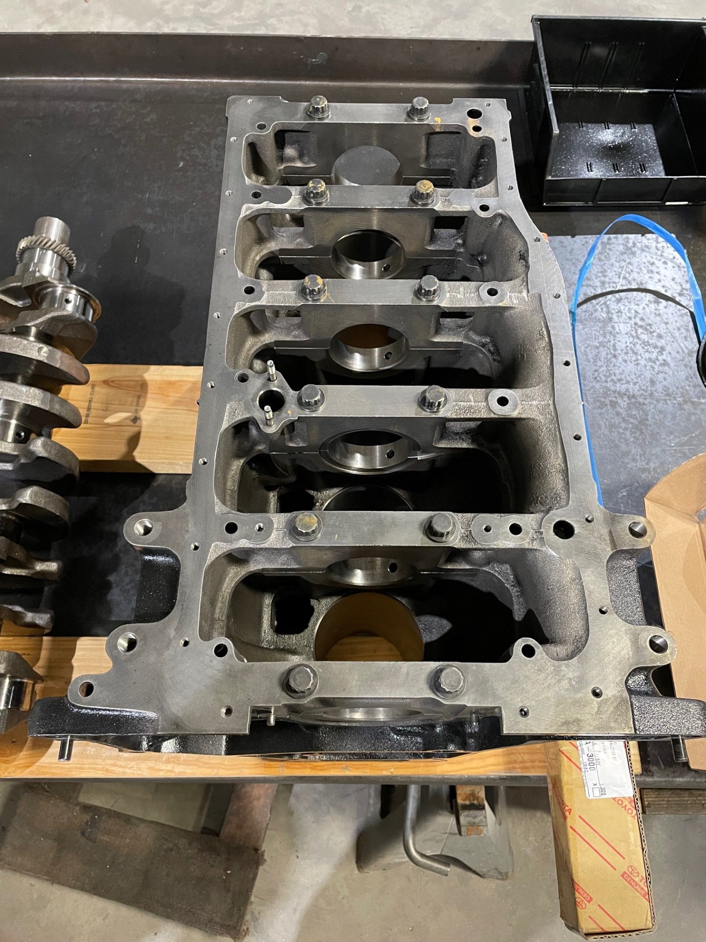

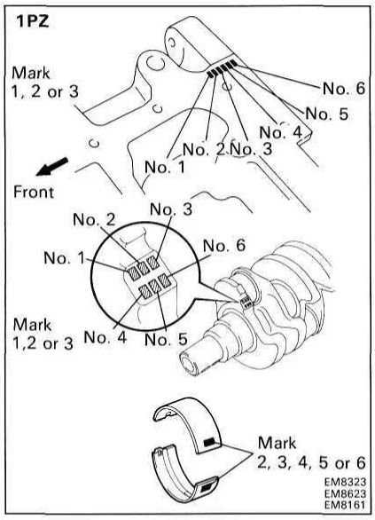

Is someone able to confirm where the marks are on the bearing cap that indicate the main journal bore diameters, as shown in the image below from the service manual? I could not find them on the bearing cap but now that I've studied the diagram more I'm thinking that's because I was looking at the "bottom" surface of the bearing cap that is outward and they are actually on the "top" or inside surface that mates up to the block. Is this correct or did I just miss them?

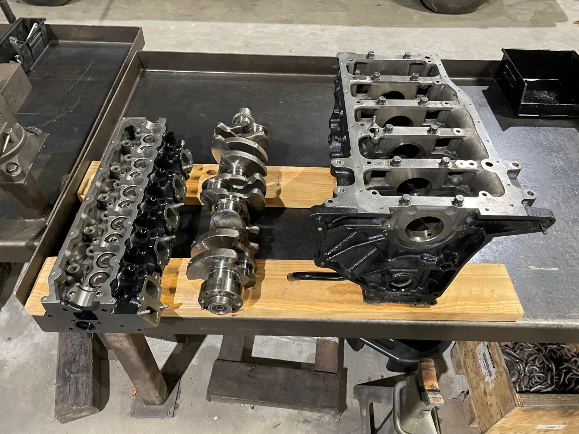

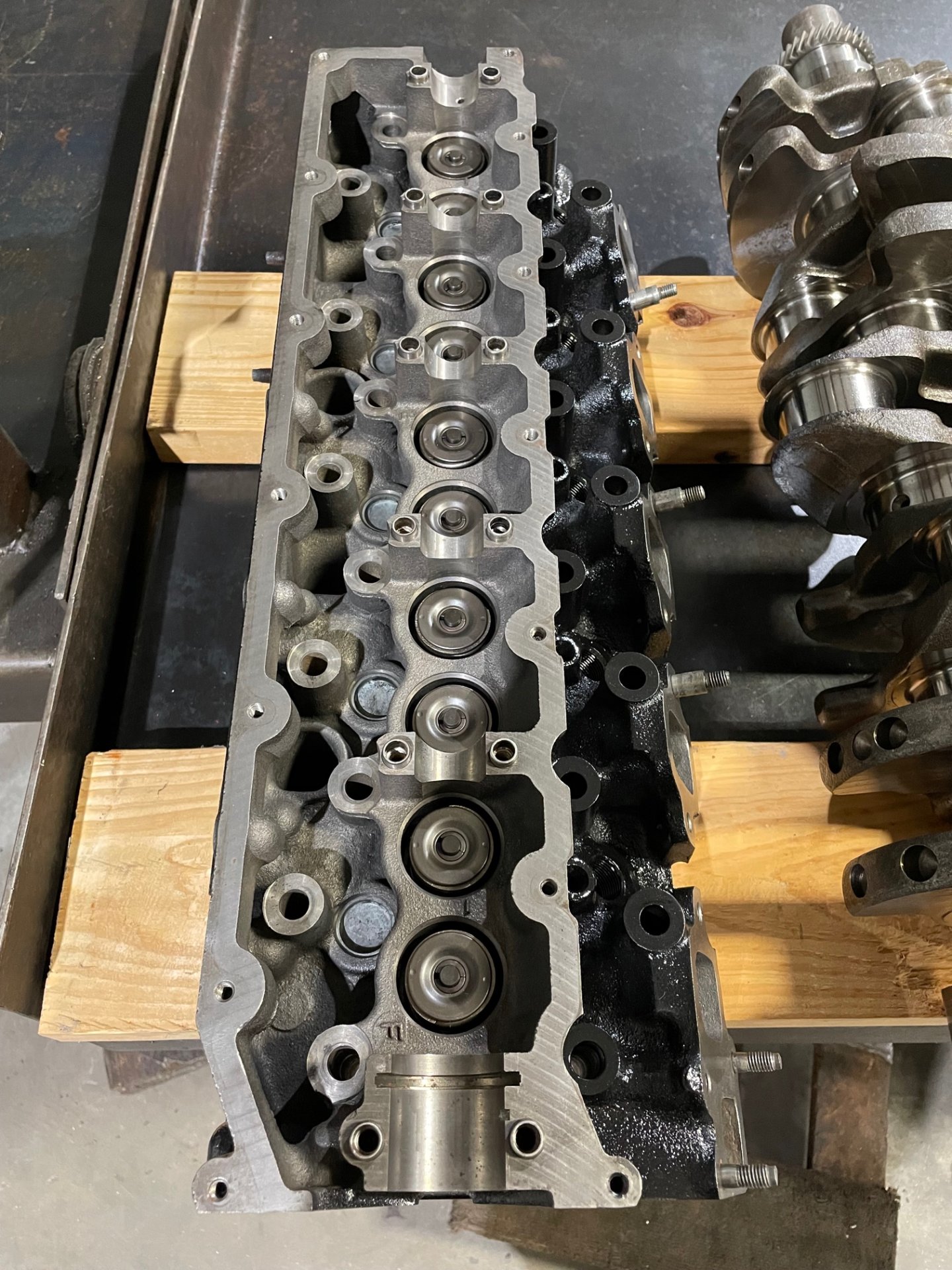

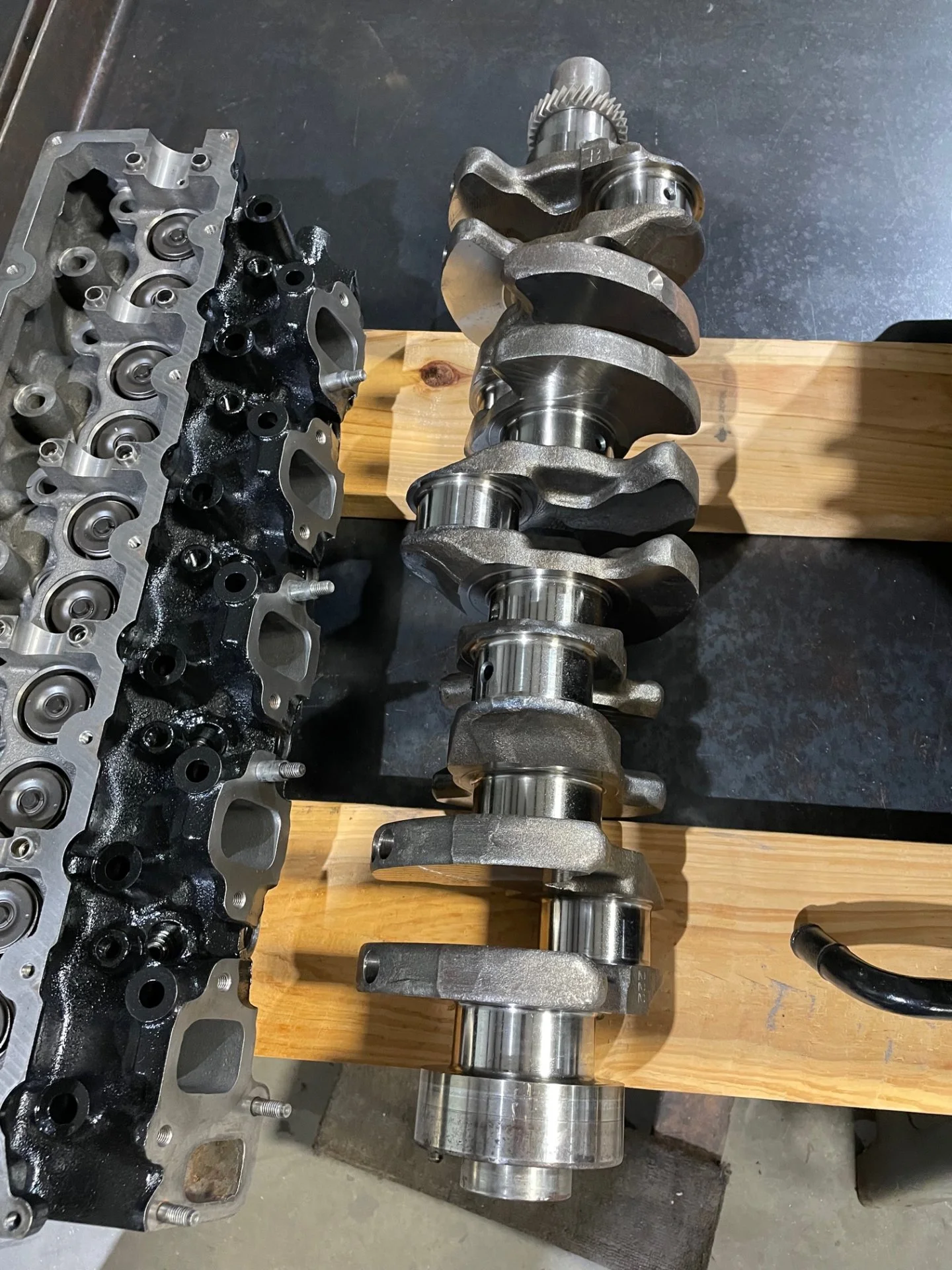

It's been a slow process with the machine shop but they finally finished it up and I went over to take a look and drop off all the parts to my mechanic who will be reassembling it. Certainly looks nice... very clean work. Finally in the home stretch... just needing to get the long block reassembled and back into the truck. Fingers crossed everything goes smoothly from here.
