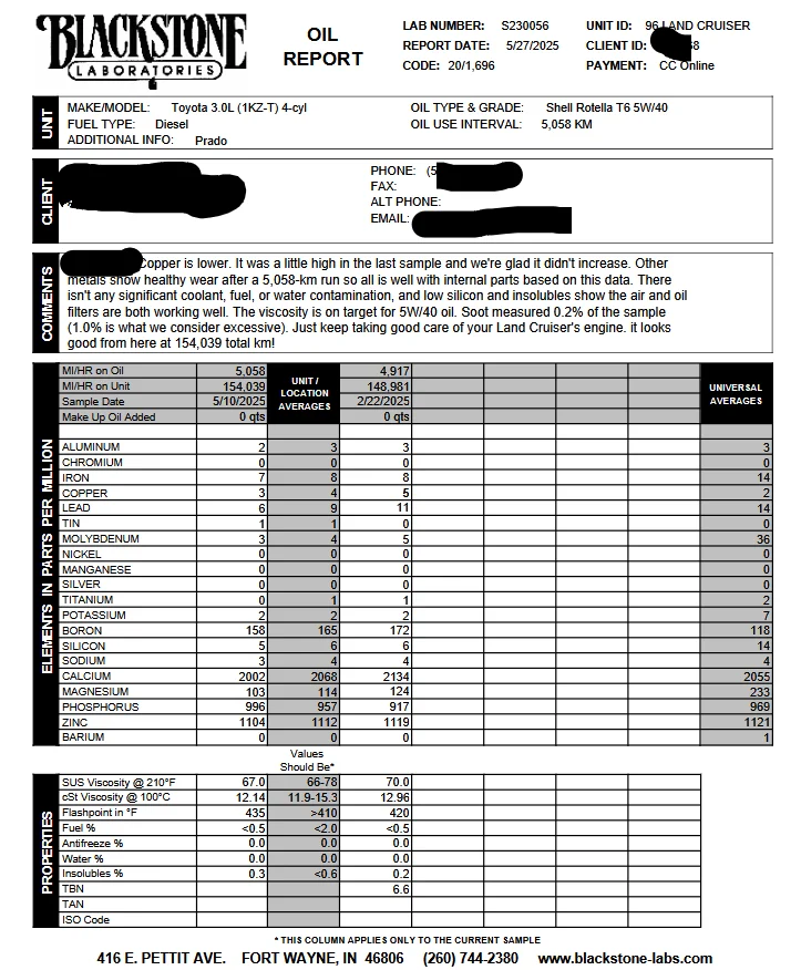

Take an oil sample at your next oil change and send it to an oil analysis lab. I would bet you could easily run 10,000km intervals with a good synthetic oil and genuine filters. Different engine, but the recommended interval on my TDI powered Prado is 13,000km based on oil analysis, I usually do 10k. On a stock TDI I run 10,000 mile intervals.
Oil analysis will likely happen.
Pretty sure the main contaminant on these old IDI diesels is soot loading of the oil, and unless I want to install serious bypass filtration(not out of the question by any means) changing the oil frequently is how that's handled.

Alrighty, here's a UOA for 5k km on oil and 10k km on the filter. Filter is a Mahle OC275, and obviously all is fine. Will continue changing the oil filter every other oil change.
