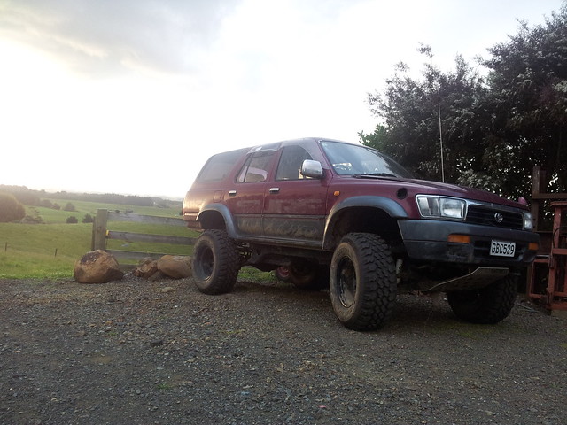

I woulda cut that underwear scene out. :o Other than that, AWESOME! :D
Nice setup indeed. Would like to do the same on my cruiser later on once the engine is dead.
I know this isn't the right questions.. But do you have the fuel consumption figures for town / highway?
Thank you.
Which series cruiser do you have?
About the fuel consumption - not a bad question at all. It's been pretty good. Certainly better than a 3VZ or a 22R. It drinks about 11L/100kms on the highway. I don't really have an answer for the city, I am one of those people lucky enough to not have to drive in them everyday. My hunch tells me that it won't be too much worse. Likely a smaller gap between hwy/city mileage than the original setup. The single turbo and vvti working together make for a really usable powerband.
